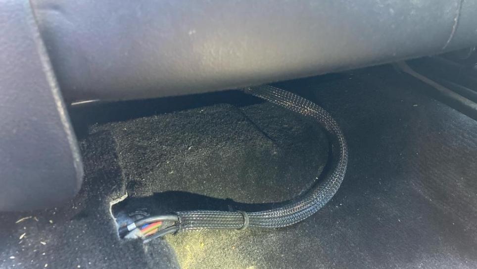

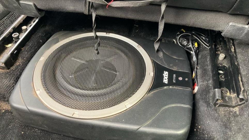

      I got the Passat as a dealer demo when it was 6m only. MY14 TDI Highline. The only options it didn't have were the Sports Pack (wheels, sunroof, power memory seats) and Dynaudio. Wanted Dynaudio but a new Passat was 6 months wait, so the dealer recommended a sound guy to talk about a speaker upgrade, and he installed a Axis sub under the passenger seat and said the stock speakers with a sub would almost be as good as Dynaudio.
        Here's a photo of underneath drivers seat - so to get to the module I have to pull the seat out and pull the carpet and it's all buried under there? Stuck my hand and feels like vents?
          Nope it's not there; your Passat had Bluetooth? Guess they moved the module in later models.

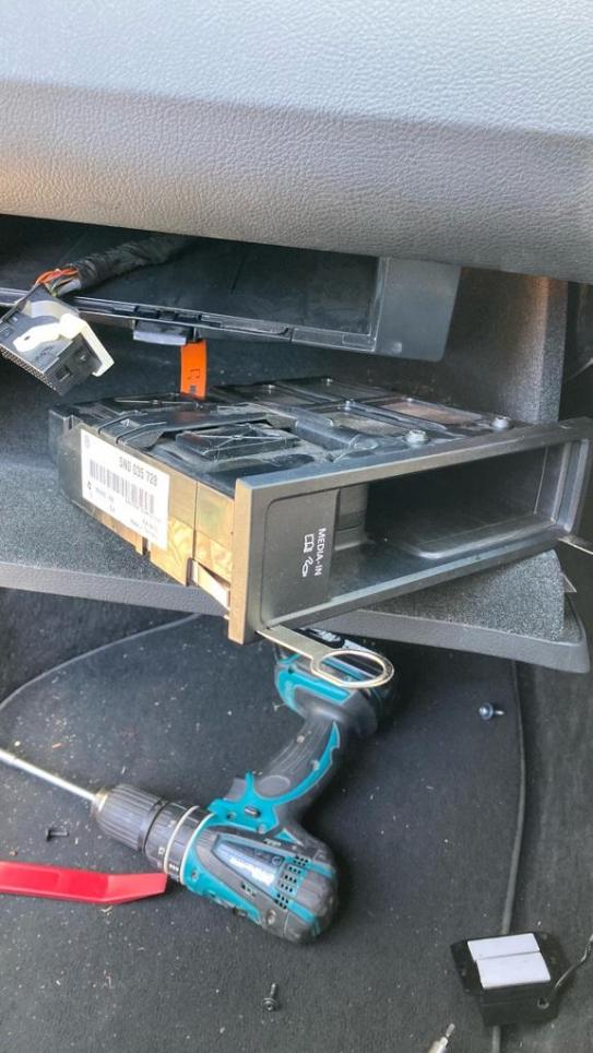

            The BT module will likely be the combined MDI/BT module.
            Check in the centre console or glovebox.
              Success. Found it - integrated in the MDI unit in the glovebox. Pulled it out, disconnected cable from the back, pushed cable back up so I could out unit back in and we are in business.

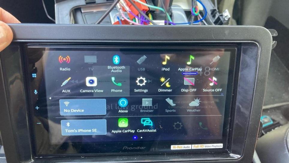

                Still not working - steering wheel controls greyed out. However through some you tubing I found you could only configure swc with source turned off. So swipe left, turn source off, then turn swc on in Pioneer, select the auto config mode and now have SWC.
                Next problem to resolve is distortion at mid volume level. Going to run rca cables to the sub from the pioneer and get rid of the wire taps so I can control sub level properly, then I'll be able to get better eq on STD speakers to see if that fixes the problem.
                Otherwise maybe a 4x50w amp under the passengers seat
                  Successful afternoon. Ran rca to sub and now able to control volume from head unit and gives much more ability to shape the tone and balance the sub. Only slight issue is that with the high level (speaker) input the sub is triggered by signal from speakers. With low level input only works with ignition on.

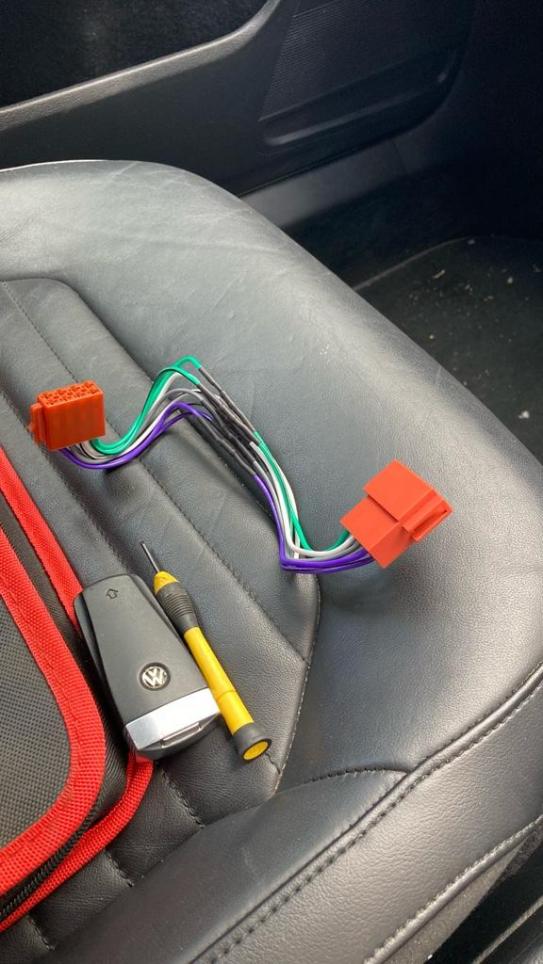

                    Distortion problem fixed. Was looking at getting an amp to run the fronts, so stopped in at Ryda in Petersham to have a chat about options.
                    Super helpful. Told me a standard head unit should be fine and suggested the problem lies elsewhere. Asked me about the Aerpro harness I was using, and turns out there's an extra bit supplied which should only be used if you've got the factory amp - contains resistors to reduce the speaker levels into the amp. Photo attached. Pulled this bit out and now CarPlay volume at 10 out of 40 is plenty loud enough.
