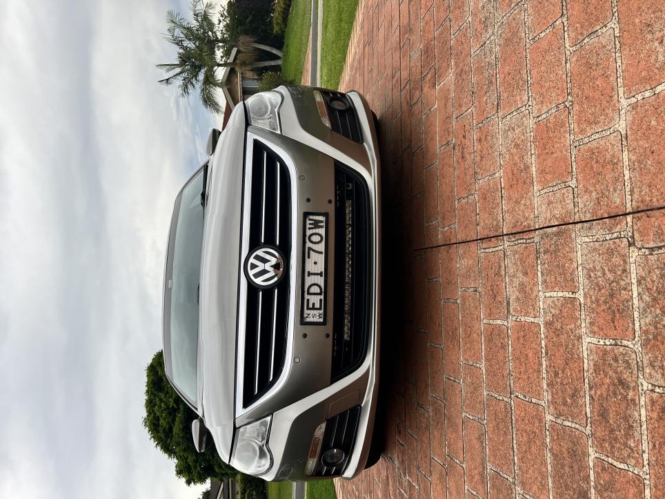

    2010 Passat CC with dynamic headlights - single Ds1 globe per light.
    high beam is achieved by changing the shrouding around the globe.
    So how do I trigger a relay to activate supplementary lights that I’ve fitted ??
    Checked the connection at the passenger side light and can’t see a 12v source that’s usable - as in controlled by the high beam switch.
    thanks in advance
    Sorted
      Yes the AFS high beam shutter is controlled by the AFS module by a CAN signal from the SWCM.
      You can trigger a relay from pin 11 (0.5mm yellow with black trace) at the 14 pin headlight connector either side.
        YES Thank you …. One of the easiest wiring installations I’ve ever done !!
