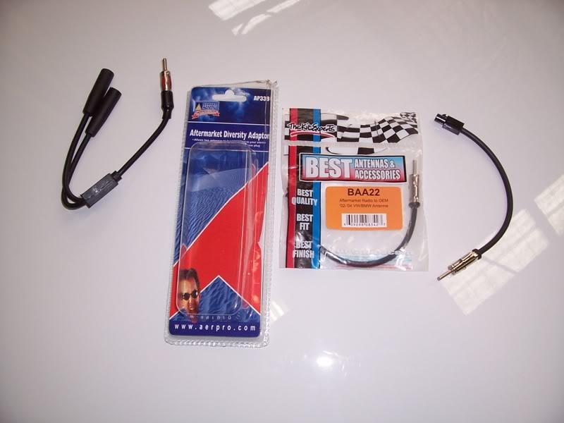

      I fitted another of the AVC 9000s today. I ended up getting these leads from a local car radio speciallist to get over the AM/FM twin aerial problem.
      It worked out fine!
      • #18
        So, you went 2 pieces of 1 fakra to 1 Din. Then a double din to single din?
        i.e 3 leads? Nice. Didn't think of that combination.

                        I searched hi and lo for them too, and could only see them at Advanced Ice. They did claim (last week) that they would have them in stock this week though.
                        Alternatively, you could go the way that GTIMK5 did in the above image.

                          Well I just fitted anothe one today. Phew! The reverse camera doesnt get a lot easier but its all good. Getting AM/FM ok with the lead setup that I showed earlier.The GPS antena works fine under the dash grill as it always has on my own car.
