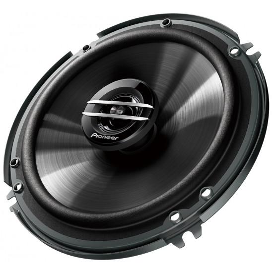

    Small update, Ive now had a chance to go for a drive with the new speaker and it doesn't seem to have the same volume as the other side despite being a 300W speaker, although this is a two way rather than a just a bass speaker. I did sort of expect the new one to perform better than the old one, but then it was a (maybe) slightly larger component speaker.
    New Pioneer 300W ($60 Autobarn)
    Pioneer 6" 2-way speaker TS-G1620F
    The debate now is do I change it, lose volume and bass response, and have them match... or hunt up another OEM one...
    Plan B is to hunt up a small 2 channel amp to use on the two new front two speakers leaving the stock tweeters in place running off the head unit, but running the doors up front as two-way's from a dedicated amp as well... mmmm interesting.
