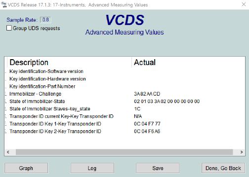

          ^^^^ I suspect the answer is "perhaps" - but it will depend on the immo version in the 4 x cars! If you own a VCDS cable and if your vehicles have UDS protocol instrument module, you should be able to get to the screen-shot below via advanced measurement
          The identifier of the key in the ignition will be given by entry Transponder ID current Key-Key Transponder ID and the identity of the two programmed keys will be given by the 1-Key and 2-Key entries (last two rows in the table). If you are using a "correct" key - then the current Key entry should be the same as either 1-Key, or 2-Key.
