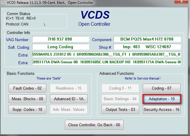

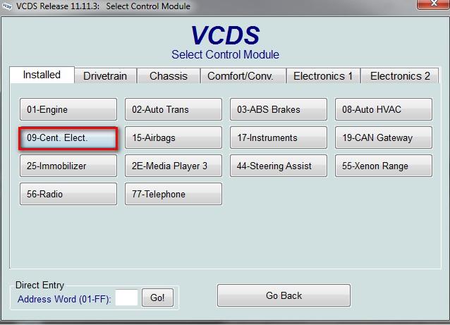

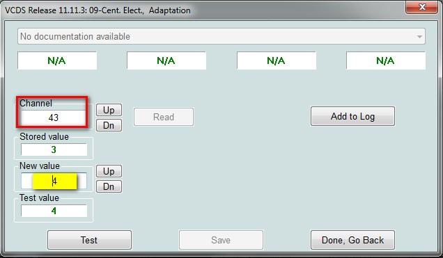

                    Right then, I figured out how to change the number of comfort indicator blinks on my MY13 6R GTI. I find the default option of 3 is just one blink too few. There was no simple option available to me, so I thought I'd share the steps I had to follow, in case anyone else wants to make the same change.
                    1. Go into the 09-Cent. Elect. section:
                    2. Go into Adaptation - 10:
                    3. Select Channel 43, where you should find a default setting of 3. Enter a new value of whatever number of blinks you want (I chose 4), click Save, then Done.
                    Turn your ignition off then on again and test. Worked for me .
