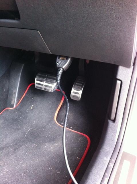

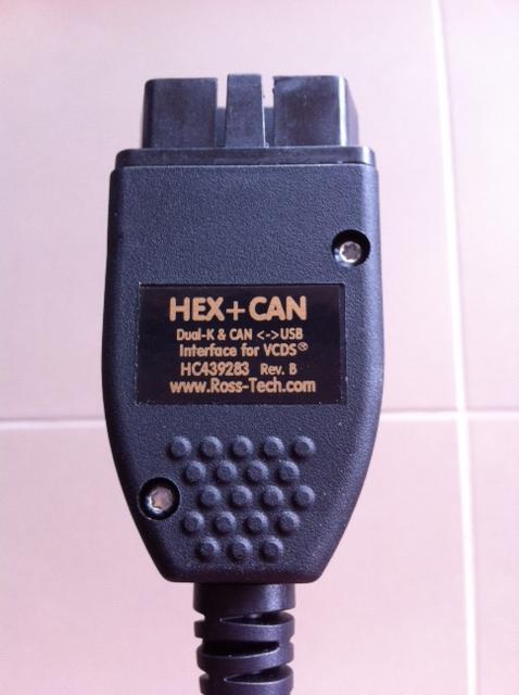

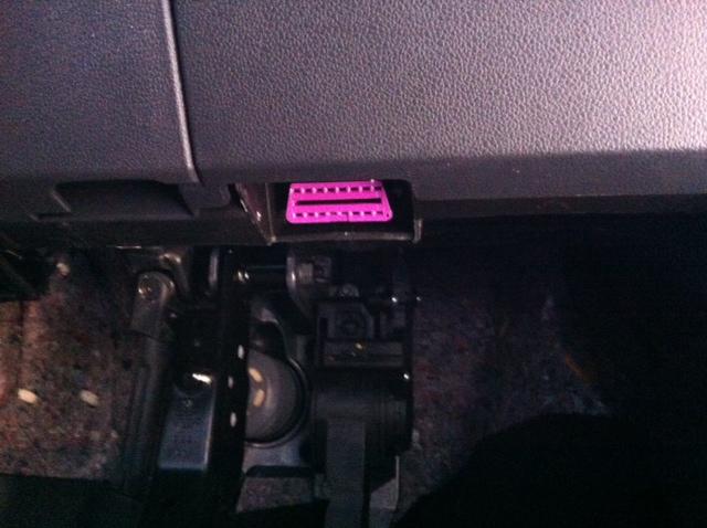

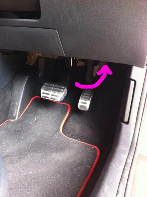

                    What cable do I need to run this software and where do you connect on the Polo 6R
                    • #40
                      I'd personally recommend this:
                      From here:
                      Ross-Tech Store: VCDS License with HEX-USB+CAN Interface
                      And it plugs in just above your right shin when you're sitting in the driver's seat (it's a pretty pink port on my GTI :/):
                      Just enabled the self-locking function and tweaked the Brake Assist and XDS settings (thanks Gavs & readerr0r for providing valuable info!)
