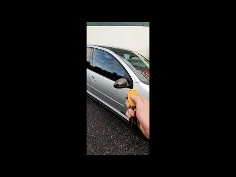

                    Yes luckily it has been worked out. Here's just a couple of the videos from a guy in the UK who does it:
                    VW Retrofit - Golf MK5 2007 coded with power folding...
                    VW Retrofit - MK5 2008 upgraded with power folding...
                    VW Retrofit - Golf MK5 ED30 with power folding mirrors on...
                    One of the forums about it- Mk5 Golf with power folding mirrors with key remote
                    It's been proven countless times to work on Mk5s now. I've even found the changes that need to be made manually in the EEPROM for it but it can also be done automatically by VCP.
