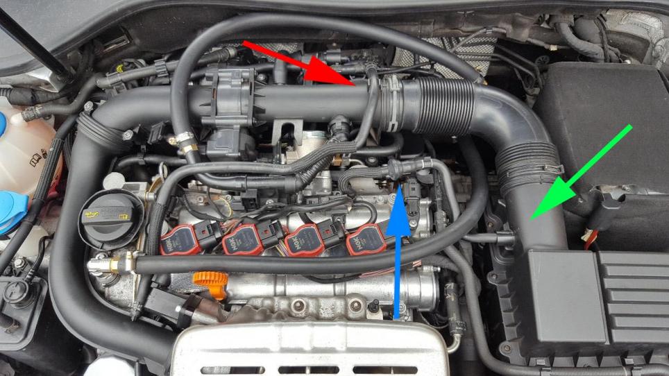

            I have a Forge cold air intake on my 118TSI and swapped it out for the stock airbox recently and noticed a little bit of oil where the airbox meets the plastic pipe (near the green arrow). I figured this was coming from the pipe with the blue arrow given that's where it joins and had been considering installing a catch can... I hadn't really looked into it in any detail and didn't realise that wasn't the primary vent...
            Fast forward a little while and I took off that bendy pipe and noticed a decent amount of oil buildup at the red arrow and got far more interested in an oil catch can, started searching found this thread. This really is a brilliant write up!
            So my questions.
            How is it doing a couple of years on?
            Is there any reason (or way) to join in that second pipe (blue arrow)?
            Any other advice you might have before I undertake this little job?
            Your mounting location looks like it will be the go, although if I go back to the forge intake it takes up far less space than the stock airbox so that might be a little more accessible, although I will see soon enough.

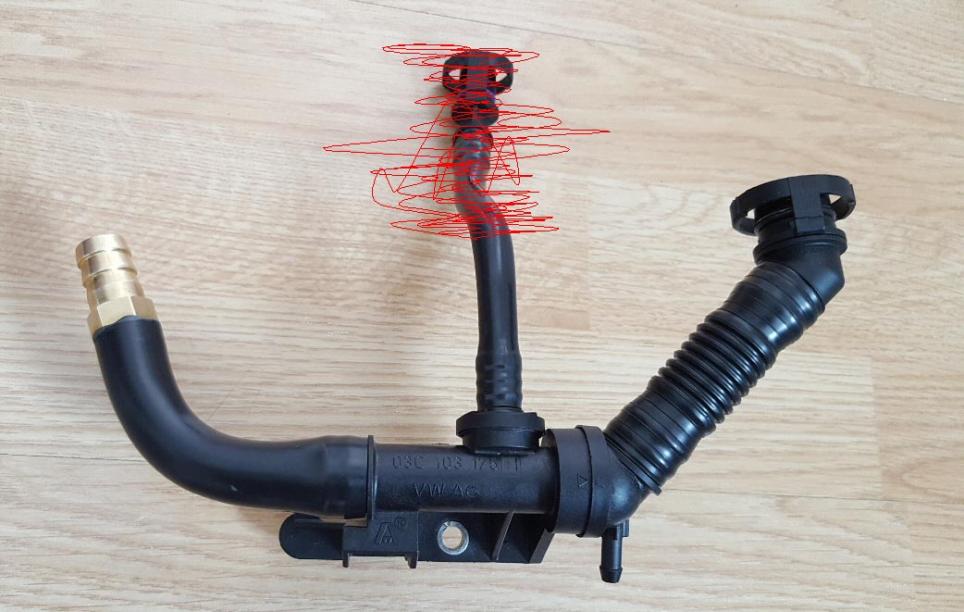

              A short five years later and I've finally gotten around to this little project
              A trip to a couple of U Pick wrecking yards and many many Golfs later I managed to find exactly ONE vent hose assembly, although it's broken (like everyone including mine) with that back pipe broken. That back bit was completely missing on the wreckers, but easy enough to hook up to what I have.
              Grand total of $11! + $2 x 2 for the two wrecking yards I went into.
              The plan is to make up the various fittings so I can keep my car in working order and swap in the bits when I'm ready and have an option to put it back to stock should I ever need to. I'm thinking of outsourcing this bit to the local Pirtek.

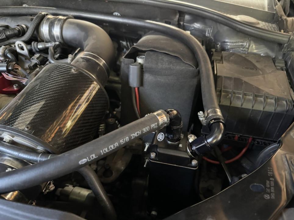

              I've also picked up a baffled catch can from AutoBarn which should do the trick. $100 from the local store seemed reasonable enough for this.
              Once done, it should look just like the pictures above... watch this space.

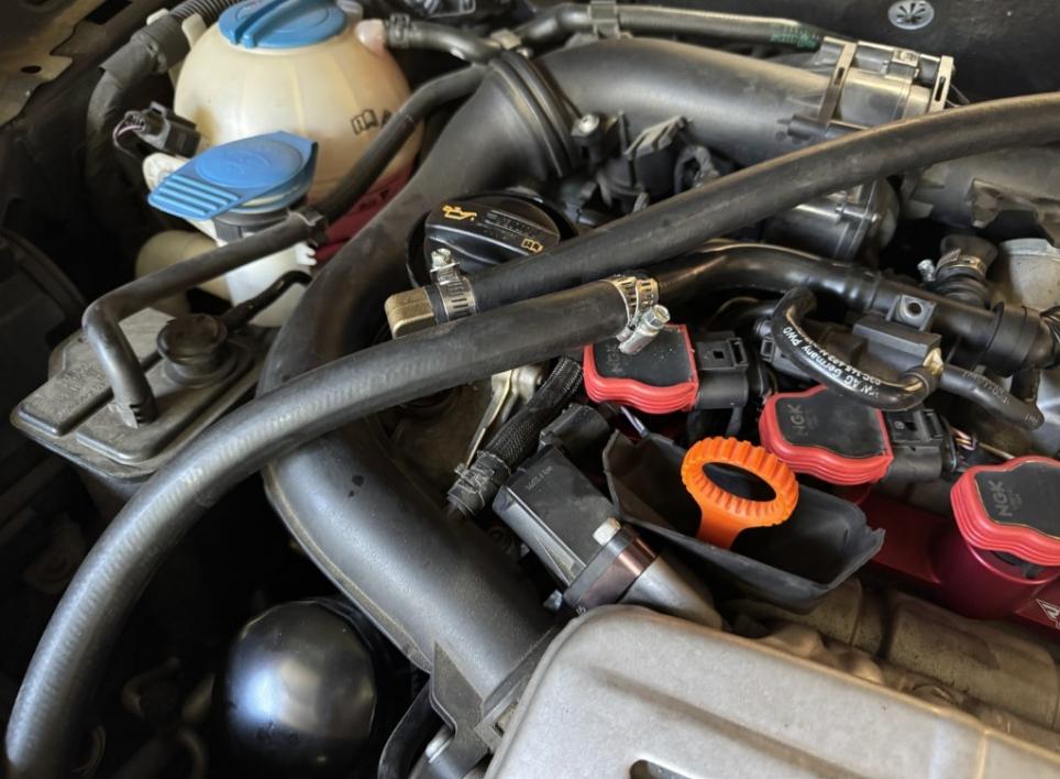

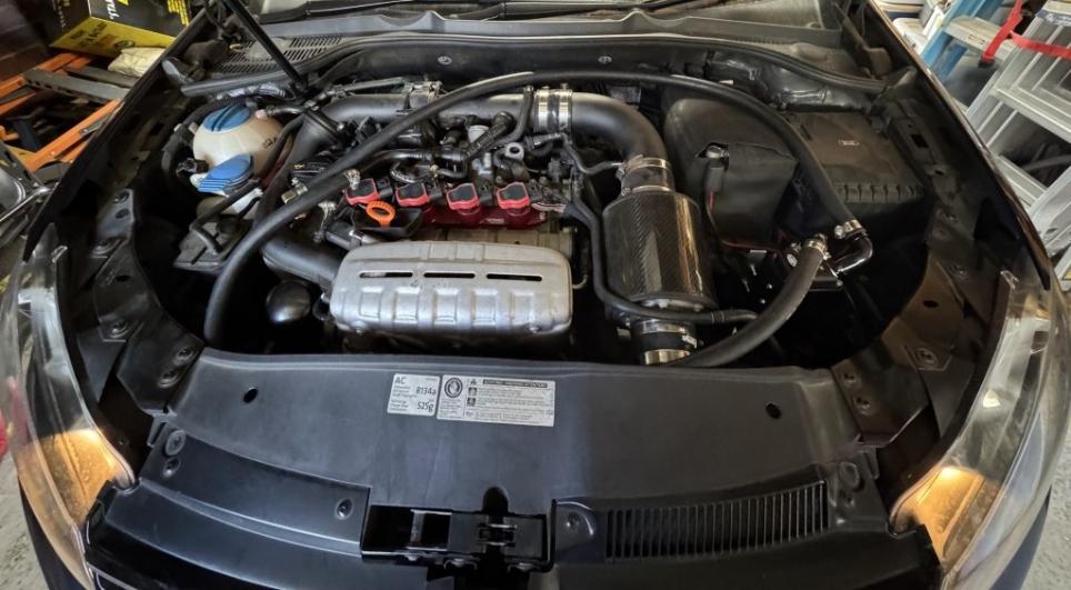

                I did mine today, not nearly as pretty, really should have come back and followed this install location a little closer, I was attempting not to run across the top of the hot engine (which was stuck in my brain for no good reason despite the original parts doing just that) which is kind of how I ended here. With this thread in mind I might go back and consider re-routing things... maybe. Or maybe I just leave it like this forever We will see.
