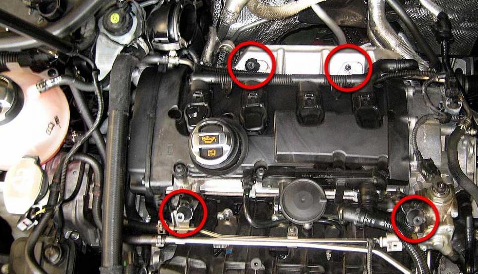

    Now everything went OK, except for the heat shield part. The large rubber "screw" holding it in seems to be different than the European models, in that theirs is cone shaped (thing at the top) where ours is the oppisate, the top bit is thick, therefore making it very difficult to undo
    It is the top left in the picture below:
    So i ended up not putting in the heat shield that came with the intake
    Will this cause any issues ?
    Im assuming its there to keep warm air from entering the engine bay, but im hoping its not there to keep the maf safe ?
    Input would be appreciated !

    Those grey/black plastic screws that hold the stock engine cover on can be removed with a large socket. 21 or 22mm from memory. You could also try a pair of multigrip pliers but you may damage the plastic a bit.
    You can re-use the grey/black screws to secure the heat shield if you want, otherwise go grab some M6 bolts that are about 20mm long and they will do the job.
    Ah, also the plastic screws at the back of the engine actually have a 10mm nut underneath, so if you undo those first you will find the screws much easier to get off.

      24mm Kinchrome "deep" socket. $16 at Bunnings.

        my other question is - if i dont install the aftermarket heatshield, will i run into any problems ?
          Originally posted by kam View Post
          thanks for all that
          No - it will be ok without the heatshield, but seeing you have it, you may as well install it.
