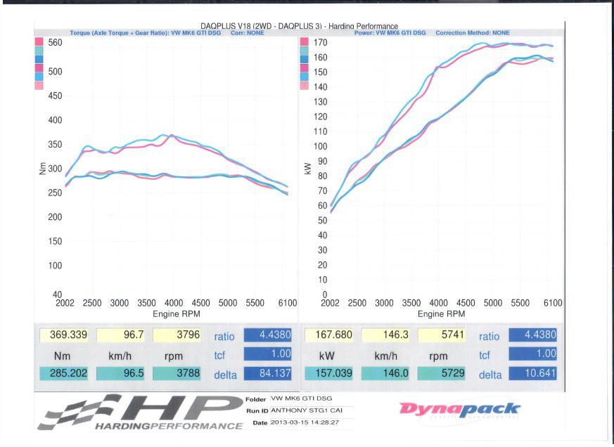

                        My GTI before and after stage 1 + carbonio intake:

                              Actually good dyno above on the GTI, and for comparision, here is our Tiguan 132 with the stage 1 flash only. You can see where Volkswagen pull the power back (CCZD engine code) and where the stock GTI 155kw (CCZB) version is.
                              End result is pretty much identical, and as always, repeatable. ~ 170kw at the front hubs.
