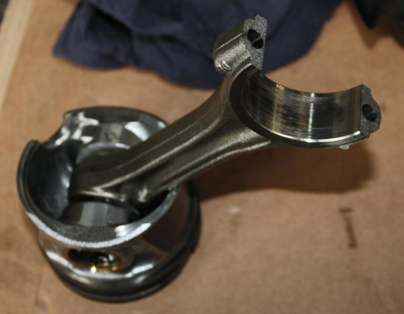

    If it is a big end failure (conrod looks scored the way I see it ) I can't see realistically how a simple tune could cause it not without other things failing anyway. The question is though what has made this happen. Happy to be proved wrong of course
    Petrol is a different story but even then the ECU would hopefully be able to protect itself

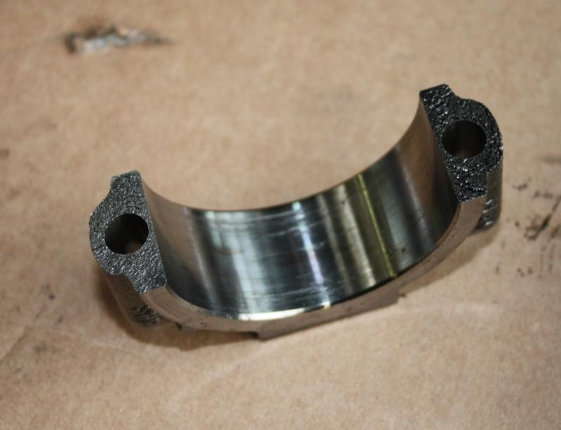

    Mark, check that rod again. There's no bearing in it. There's no metal near the bolt hole.
    Gavin
    • #32
      hmm yes interesting oh well scrap that.
      Edit: maybe its gone to bearing heaven with that amount of crap in the sump

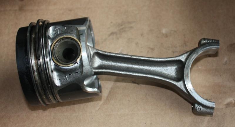

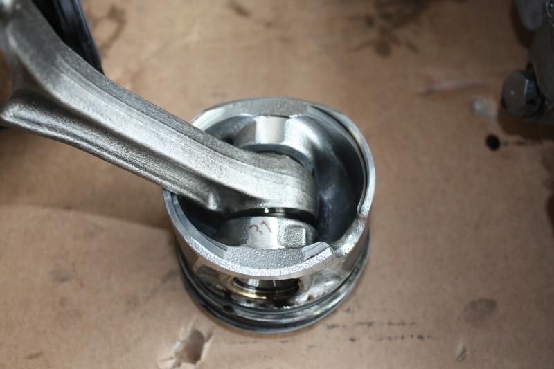

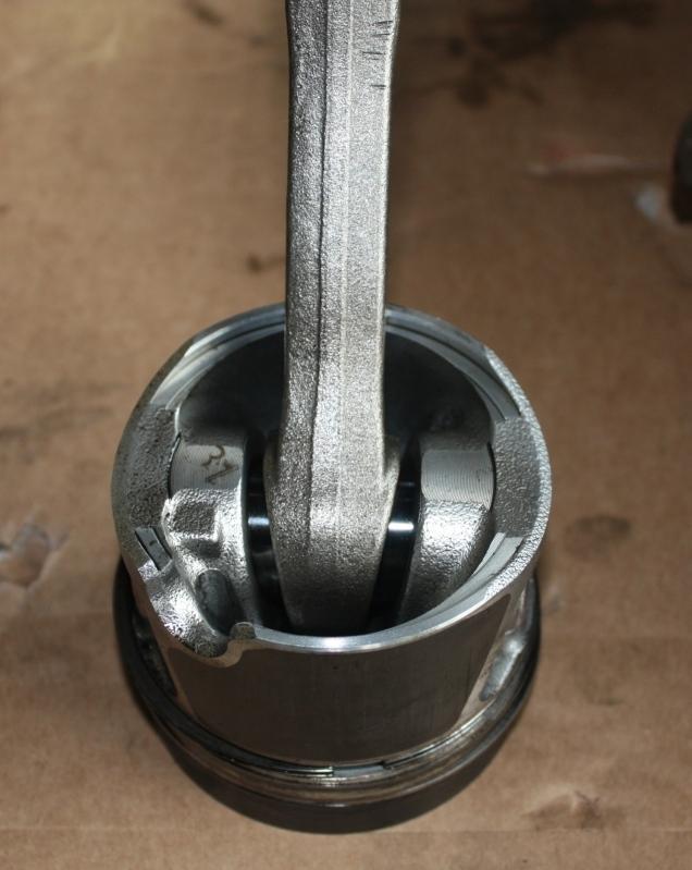

        Could be. My initial thought was oil pressure when I saw the rod but changed that when I looked closer. There is a bearing in the top picture but its too out of focus to get anything from.
        Looking again, is the a lump missing from that piston on the far side? The shape of it looks a bit too regular to be damage?
        Gavin
        • #34
          Gavin
          Yes, that piston doesn't look right. I'd like to see the top of it, and the condition of the rings as well.

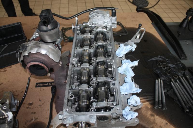

            Guys I am going back to VW later today so will take more pictures of what I can see. I couldn't see the engine top cover or the other pistons anyway. The block was also missing and from the other picture I've uploaded now you can see straight through the bottom of the car to the workshop ceiling so the block must have been put aside somewhere.

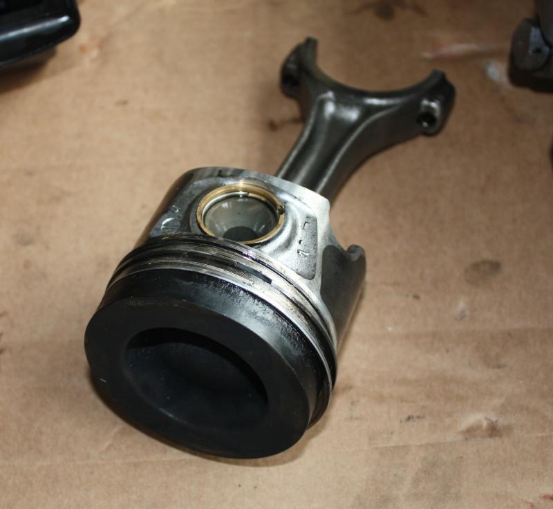

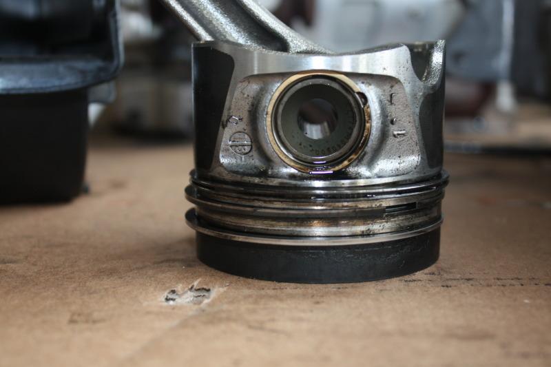

                            Ok I have now uploaded the pictures taken earlier. I now realise the tiny brass fragments shown earlier were sitting in the engine sump cover. Another mechanic who was there told me it's likely they came from inside the piston head where it meets the con rod - is that possible? Could that be a mechanical defect? As for oils - the car was serviced by this same dealer in December 2012 and 1,400 miles ago. Before taking the car into them I checked the oil level and it was fine.
                            Anyway, here are the pics............

                              How is the condition of the other 3 con rods bearings? If they're in perfect condition, then ask the dealer how he can explain that the only one cylinder failed? The tune affects all cylinders equally and you should see the similar signs of excessive wear on other 3 (because it happened so quickly). If not then I think that the lubrication failed in that engine.
                              How was the oil filter?
                              Was the coolant level always OK or were there some top ups needed to keep the level up?
                              It would be an interesting experiment after repairing that engine to leave the tune in there and observe. And, if everything would be OK after 15,000km get the oil sample tested and go back to that dealer for the refund if you'd pay for the repair.
                              How many oil changes did you have in total?
                              How long are your usual trips? (driving under severe driving conditions?)

                                We need more pics, I'm with transporter plus I still find it really hard to see how a tune with stock hardware could kill the bottom end in a diesel leaving everything else unscathed. Turbo yes I can believe that but the bottom end I can't see how you could kill bearings in such a short distance for that matter at all.
                                I might ask some of my counterparts OS tonight and see if there is some logic in it all.
