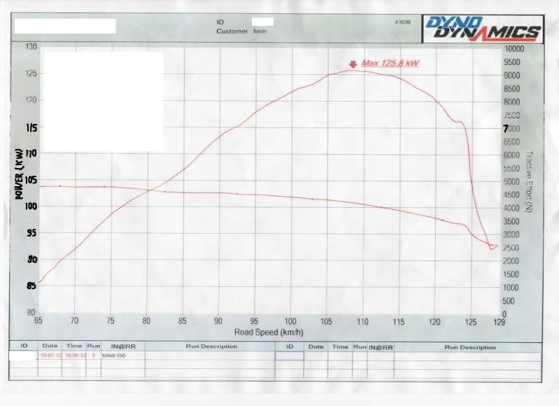

    But back to the dyno runs, my stock car managed 125.8kw @wheels which makes a drivetrain loss of around 14-15% from the engines quoted 147kw.

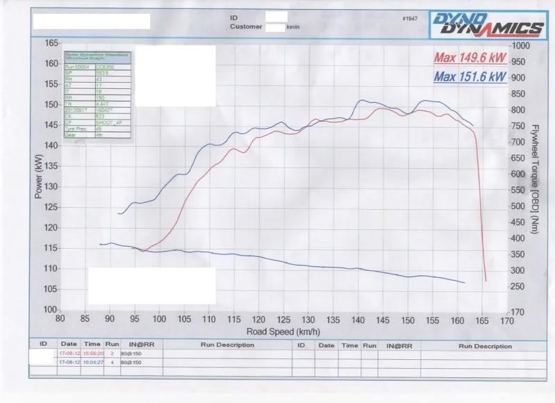

    My Motorsport tune managed a best of 151.6kw @wheels which seemed a little low. The tune is meant to deliver an extra 53kw and 100nm making it 200kw @engine, if you subtract the drive train loss of 14-15% as shown by my baseline dyno I should be making roughly 170kw @wheels.
    I think 170kw's feels a little too high for just a tune, but the 150kw's seem's too low for the power I am meant to be gaining from the tune.
    The dyno graph for the motorsport tune doesn't have a very nice curve to it like my stock tune did, not sure if this is a problem though....
    Overall I am happy that the car feels faster, but I think that it should be performing somewhat better than it is.

                  Now for my dyno runs.
                  They were done in the afternoon around 4pm in July for the Stock run and August for the Motorsport Tune run, so I am guessing that ambient was somewhere between 13c and 15c (I checked weather database site), they were done on a DYNO DYNAMICS dyno.
                  So there is definitely a gain in performance as can be seen in the dyno graph, maybe my car has some issues that are causing it to not run at it's full potential or the dyno monkey's didn't do the runs properly, I guess there are a bazillion and 44 factors that affect these things.

                    I wonder if your stock diverter valve (DV) is leaking and causing the up's and down's on your dyno graph as it leaks boost? This is a very common issue in the Mk5 GTI's and can be replaced with a more durable revised OEM valve for around $90 or so. Have a look at Dubaddiction.com.au as he sells them.
                    My mate also has the Viezu motorsport tune on his MK5 GTI and the tune soon made us aware of some factory parts that were no longer up to the task (despite a full service history) after 4 years and 70,000km such as:
                    - diverter valve leaking (the internal diaphram had a small rip in it which was leaking boost. Replaced with new one from Dubaddiction)
                    - PCV valve died (replaced with Eurojet block off plate)
                    - coils failing and causing intermittent mis-fire (new coils fitted)
                    The car runs well now. Ive been trying to get him to throw it on a dyno to not only see what power its making, but to check the a/f ratios etc, but no luck so far.
                      F- me, that's not a healthy car mate......did the dyno guy not say something????
                        Whoa, that second dyno graph looks nasty! I'd say your extra boost has caused some extra problems being close to 95,000 kms.
                          Yep.
                          Pretty standard story. Tune + car with a few kms causes a few underlying issues to pop up.
