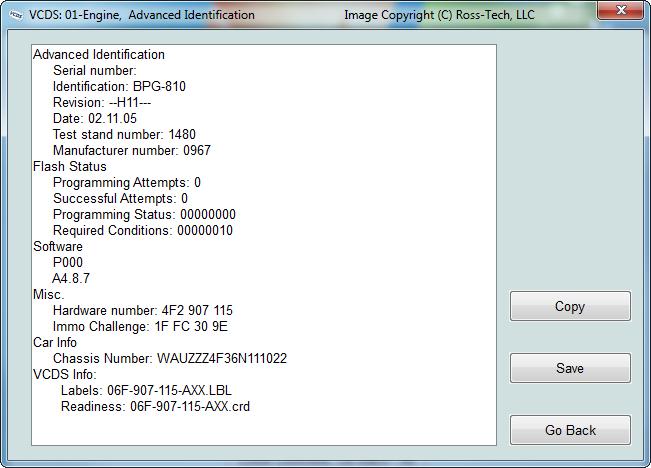

2: Flash Counter in ECU. I believe this is a common test & takes seconds to check at the dealership level.
Check yours here:
Ross-Tech: VCDS Tour: Advanced ID
Now a lot of tuners can read & rewrite this to its previous value or to zero it. I do not know if there is a recorded database of what it should be or was, but I know this has been investigated at dealership level. Some hand held programming devices increment the counter each time they flash.
