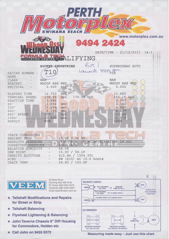

                I am currently runnng the Viezu motorsport tune. Last night I put it down the Kwinana drag strip at their Whoop Ass Wednesday meet. Here is my best run, which was my first run of the night.
                I am one happy chappy.
                  Brick ! Impressive !
                  You'll have your latest upgrade tune asap too so will be even nicer.
                  0.9 second reaction time man ?! c'mon you can do better than that (!)
                  Seriously impressed - thanks to everyone who's posting their 1/4 mile times - we get a lot of flack at the moment saying it's not possible to put down the times we do - especially with the smooth drivability etc etc etc.
                  Not sure what else to say other than - take a look as these sheets that are popping up.
                  Others say we're over-boosting... Well let's just say we are not, the ECU won't allow you too without it spiking....
                  You guys get to enjoy the results

                    Was more worried about getting the revs right for the launch. Poor guy in the V8 next to me must of been wondering what happened when I past him half way up the strip. Later on during the night I also put down an AU XR8 that was also running a supercharger. A few surprised people when we were lining up in the lanes for our runs.
                    For eveyone else, this car is my daily driver. I do a minimum 90kms a day just going to and from the office; more if I go out and see clients. Currently has around 31,500 kms on the clock. With regards to boost, with the current tune I have only seen a max of high 18s per my P3 gauge, so definitely not overboosting.

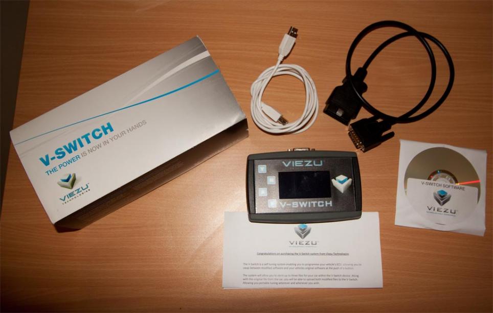

                            This is what you get in the V-Switch box...
                            You can see you get the v-switch unit itself, a USB cable to connect to a PC/laptop, the software & user manual, and the cable to connect to the car.

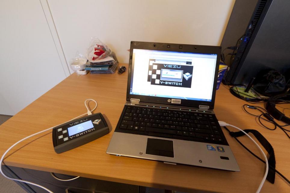

                            The first thing is to do a read of the stock tune of the car. This is done by plugging in the V-Switch, following the instructions on screen (which is essentially to turn the ignition on), and select "Read file from ECU". This part takes around 15-20min.
                            Greg did this step for me in the carpark yesterday, but it would be easy enough to do yourself if you didn't have anybody to do it for you. You plug the V-Switch unit into your laptop (assuming the software is installed), and you read the file from the V-switch and save it to your laptop. This file then gets sent to Viezu where they work their magic.
                            A few hours later - the original file is returned along with the tune file(s). The V-Switch unit can hold 3 tunes (including your stock one).
                            Now you simply load the new tuned file onto the V-Switch unit. This takes maybe 5 mins.

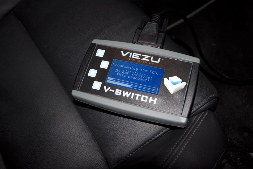

                            You go to the car, plug in the V-Switch which powers up automatically - and you select "Write file to ECU". It'll then ask you to turn the ignition on.
                            The whole process reminds me very much of flashing a BIOS on a PC. First the unit does an erase. When this happened - I noticed all my dash lights come on.
                            Once again - the process took around 15mins to complete. When done, I followed the instructions to turn the ignition on/off a couple more times, before removing the V-Switch unit.
                            That's it. Process complete. Very easy to do.
