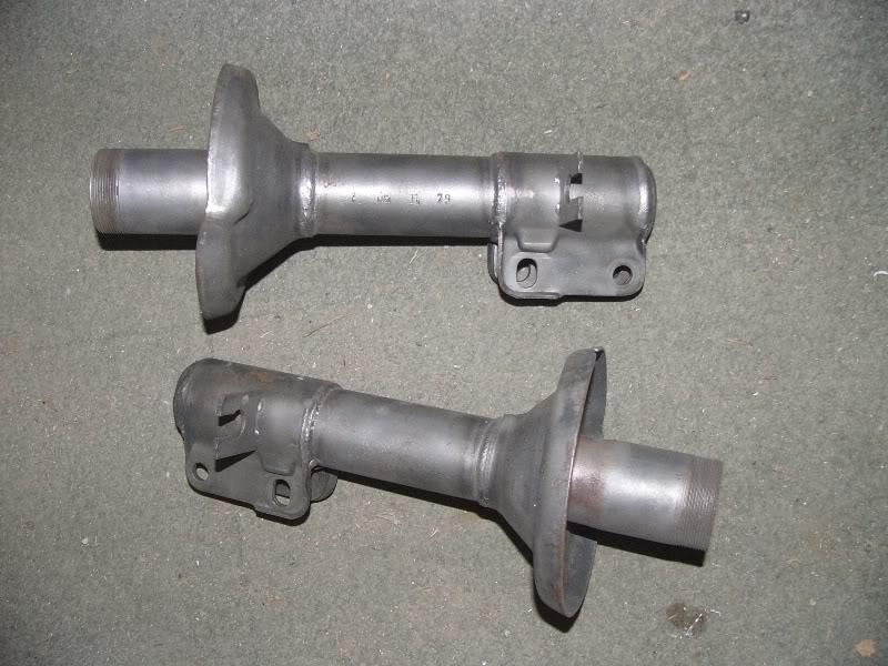

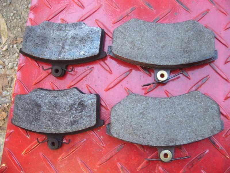

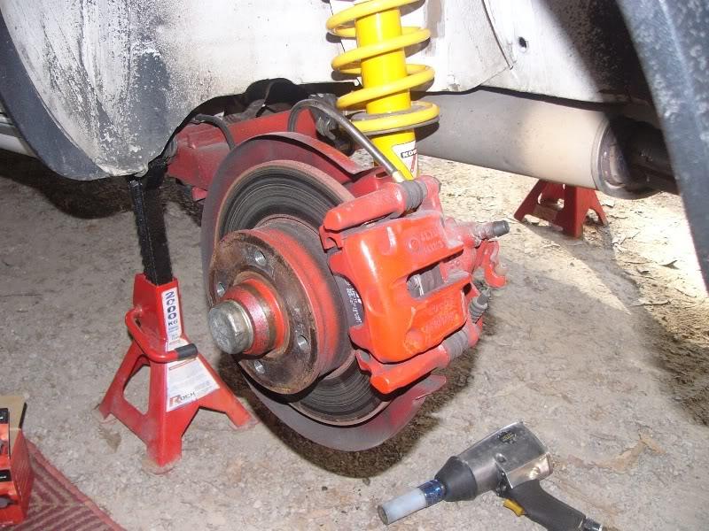

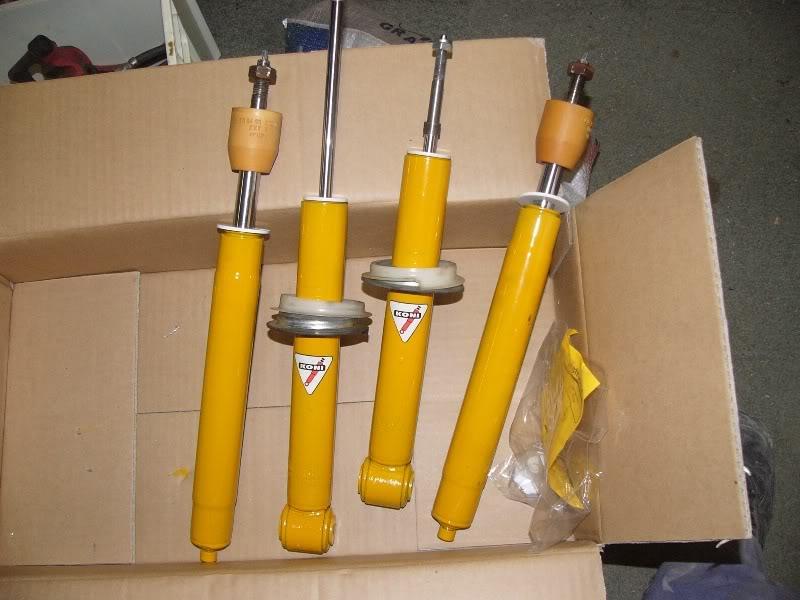

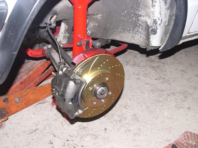

                          • Time to up the ante.

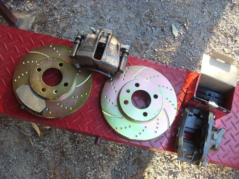

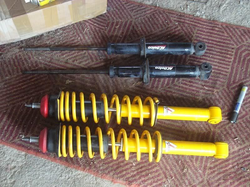

                            Rebuilt Koni Sport adjustables front and rear.
                            Mintex pads front and rear.

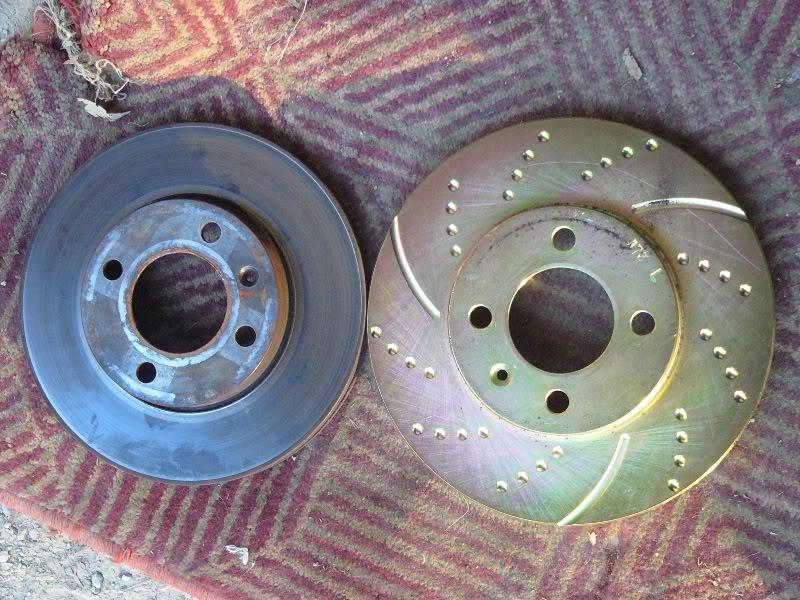

                            256mm EBC discs slotted and dimpled.
                            16v Scirocco calipers.
                            Bam!

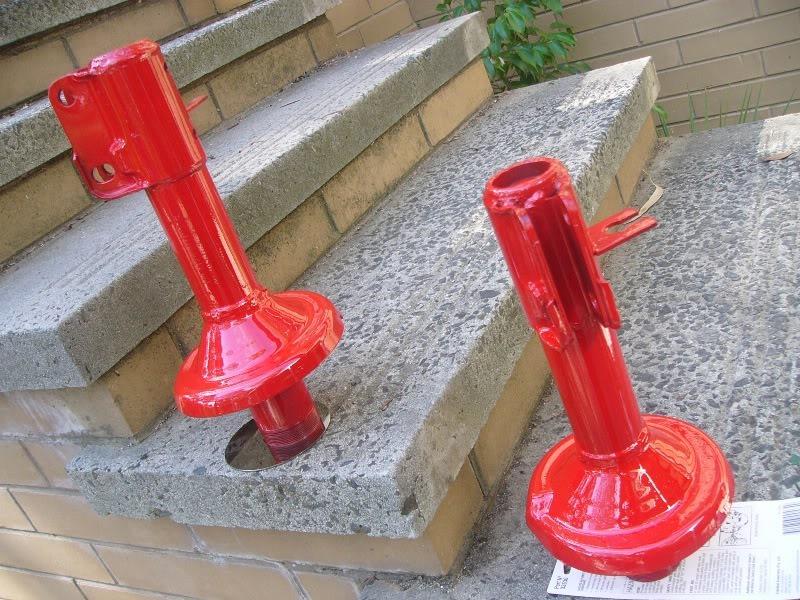

                            Cleaned up some tubes!
                            Signature red !
                            Out with the AC Delcos and in with the Konis.
                            These are the instructions for the brake pads !!!!!!!!!!!!!!!!

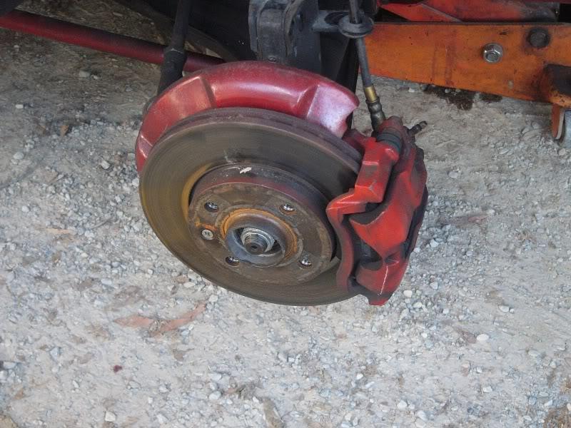

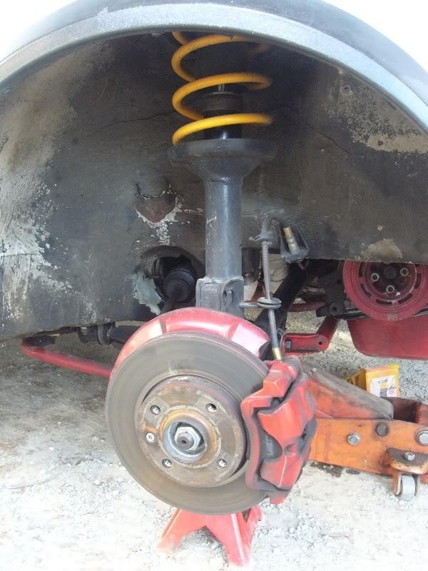

                            Front before shot.
                            7? MK1 Caddy
                            79 B1 Passat Dasher Project
                            12 Amarok

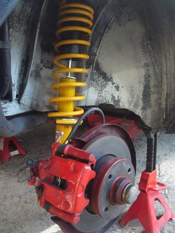

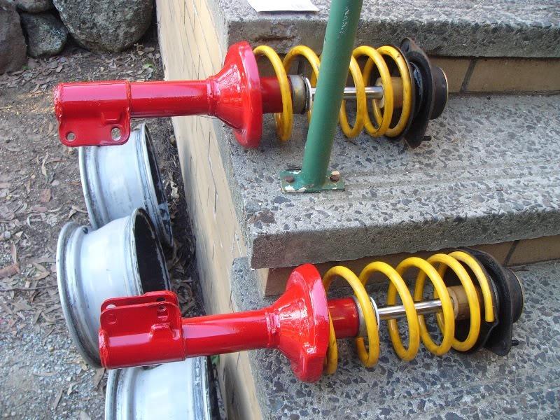

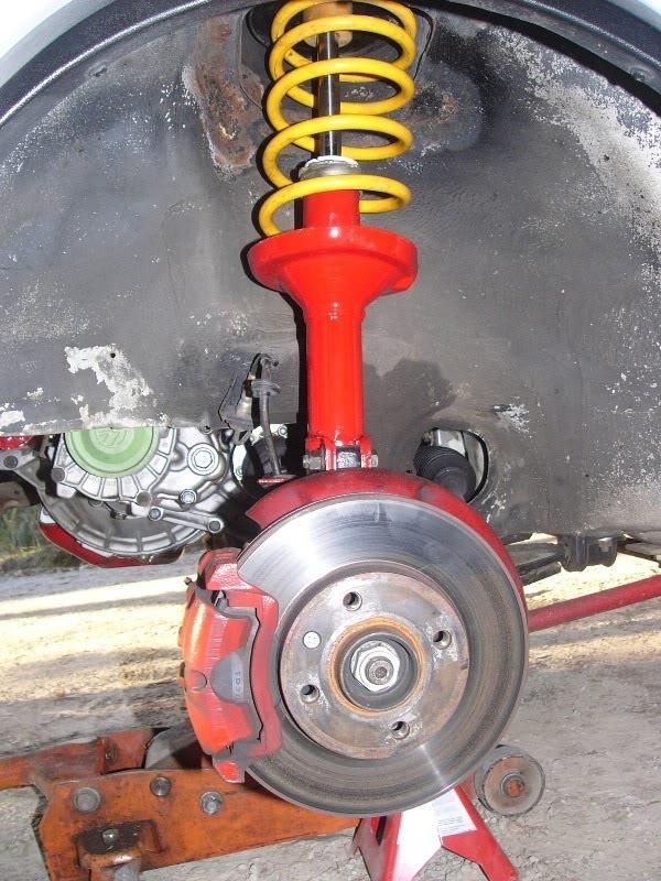

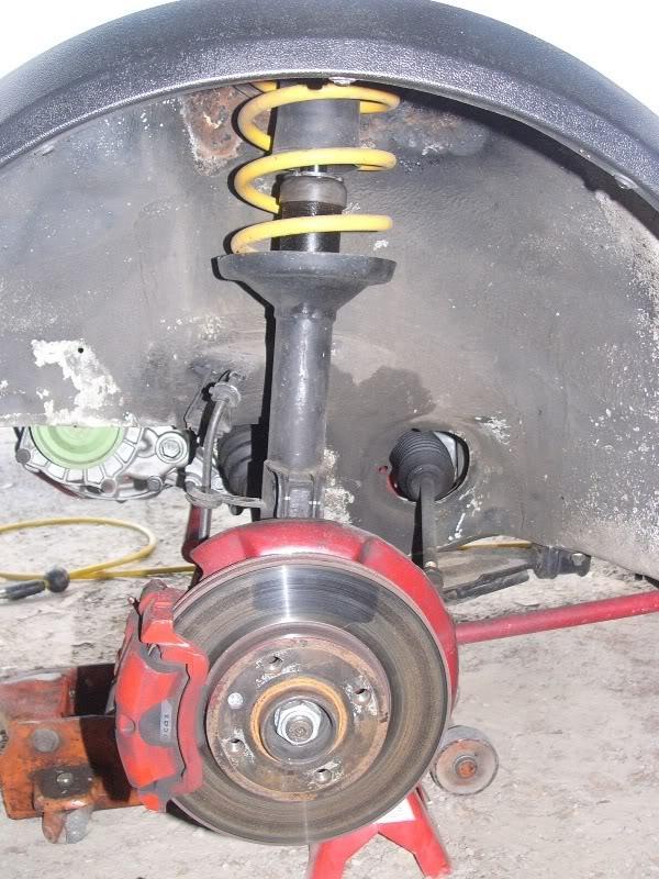

                            • Konis assembled into freshly painted strut housings.
                              And in!

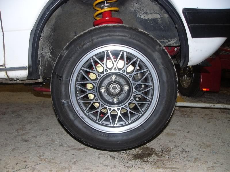

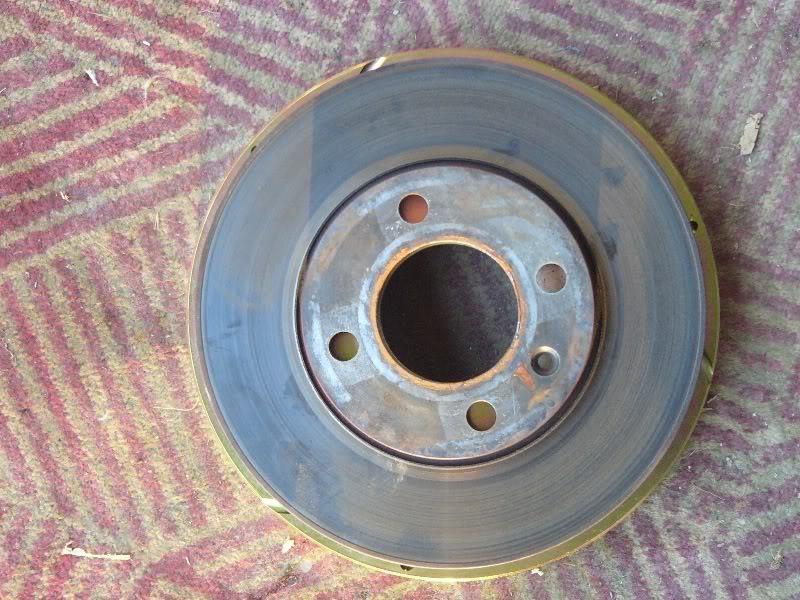

                              Big brakes!
                              239 vs 256mm.
                              Old pads vs New.
                              Still all fits (just) into my 14" wheels.

                              • Looking good Pete, you need some coilover sleeves for the front struts now. I did a set for Murrays Cortina you would have seen at Phillip Island when you did the parts collection run. Have 8 assemblies left if ya interested PM me. oh yeah, 2 1/2 " Dia springs are needed tho.
