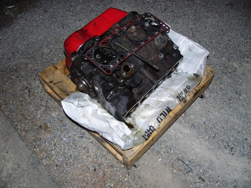

            • heres the pics!
              looks a little crispy no?

                • Water jackets look pretty dry...
                  Exhaust valves look like they got pretty hot.. Looks to be aluminium in No2...

                    • Originally posted by Peter Jones View Post
                      So what exactly failed?
                      Pete
                      i have no idea mate, started eating oil, overheated cos of a split water hose and died.
                      yeh it did get pretty hot toward the end.
                      aluminium valve? orrr what are you referring to bro?

                        • Originally posted by GoLfMan View Post
                          Piston has obviously picked up or the crown has been burnt. IE its gotten bloody hot and/or lost some lubrication.
                            both have happened, probs from all the pinging.
                              Correct a mundo dude.
