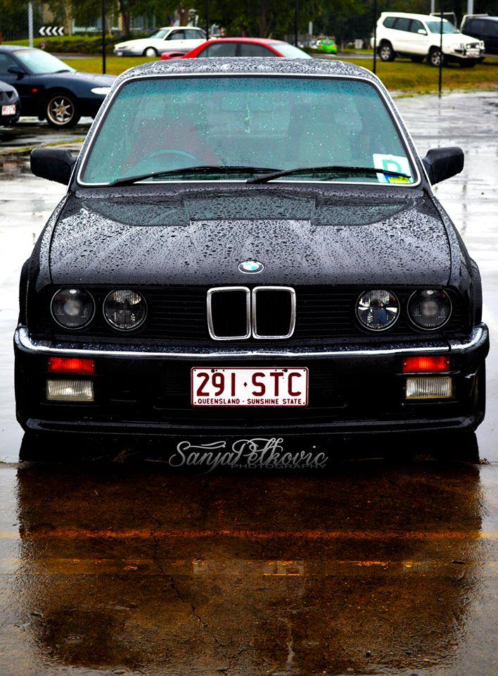

    I picked up an 89' 325 on Wednesday and I'm loving it. None of the UK guys can believe it came with factory air-con or that it still works!
    Crappy pic after I got it home.

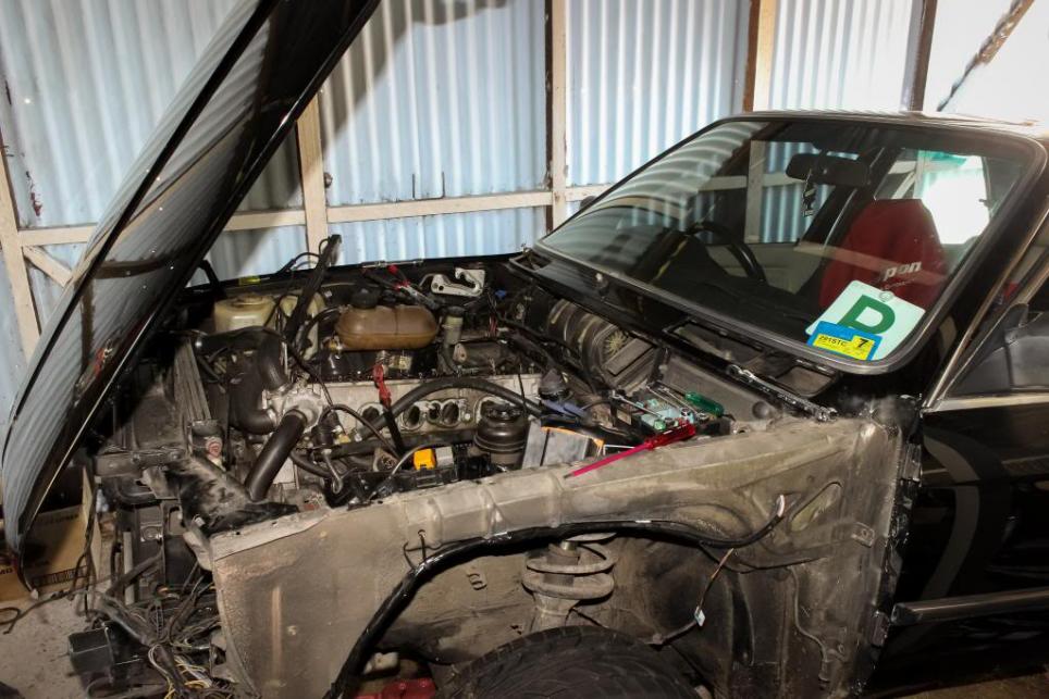

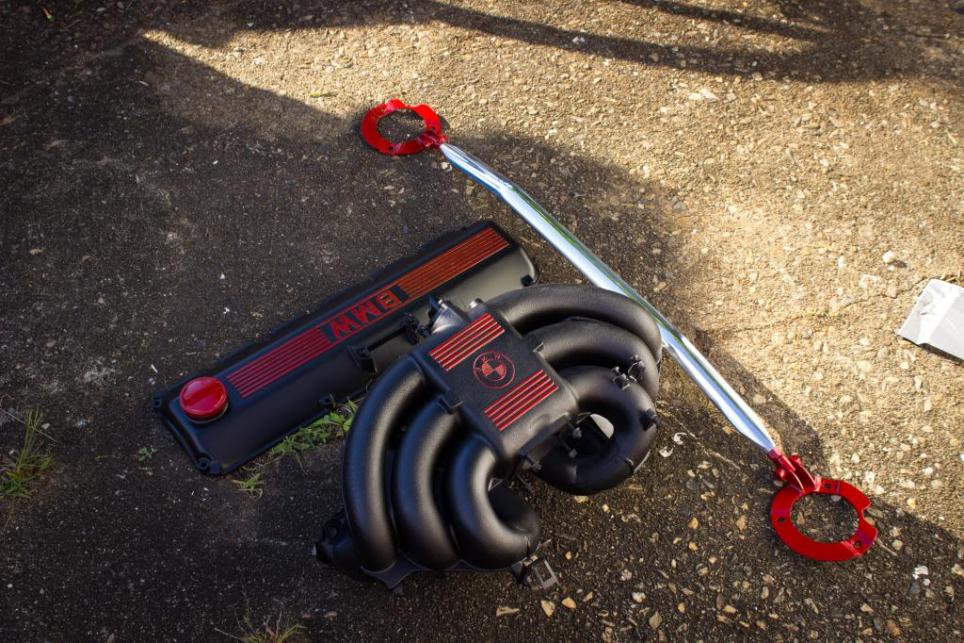

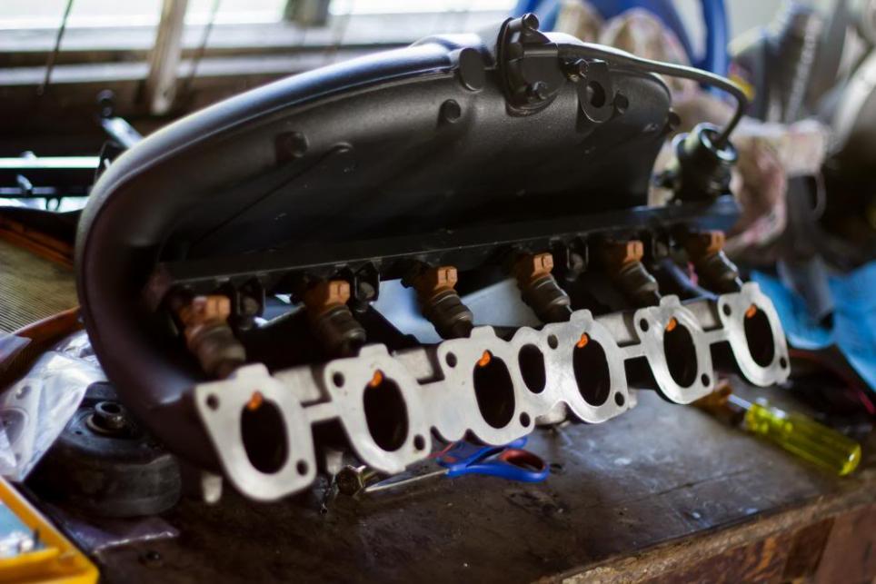

                        So anyway, a couple weeks back the starter motor died, so I took the opportunity to do some work to the car while it was off the road. To make getting to the starter easier I decided to take off the intake manifold (otherwise you have to try and get at one of the bolts with a couple of universal joints and some luck) which it turns out is not as easy as one would expect. Had to drain both water and oil to get the thing off, as oil runs through it and the previous owner had ran a coolant hose through it... Anyway after getting it off, I cleaned it up really well and gave it some paint. Did the same with the rocker cover. Didn't take a before photo, but just imagine 27 year old dirty parts... I also sanded and buffed up the strut brace and painted the ends of it.

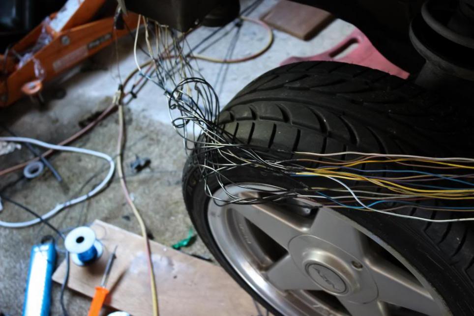

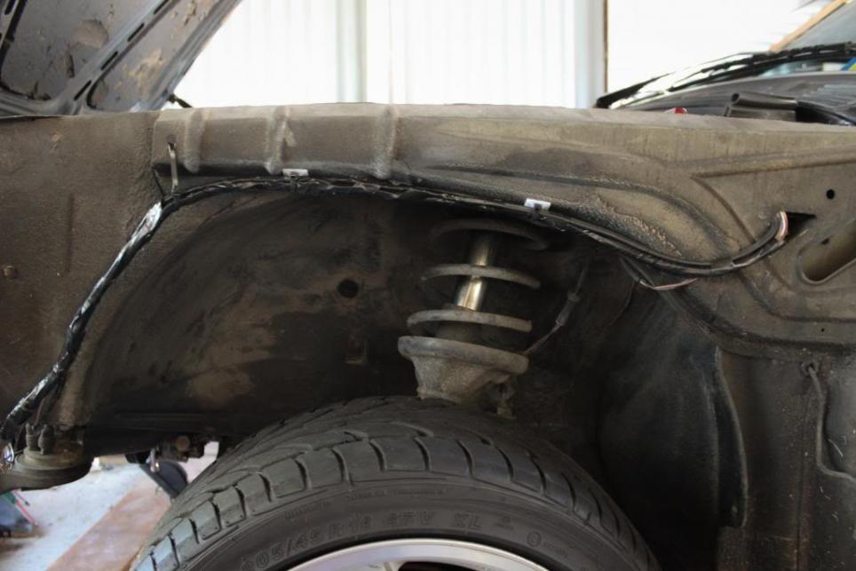

                        With that done and my new starter still not here, I decided to start a wire tuck. All the wires running down the side were extended and ran through the fender, and I removed the ABS wires altogether as I am deleting it.
                        I've mounted the wires much better than they are in this photo, so don't worry haha

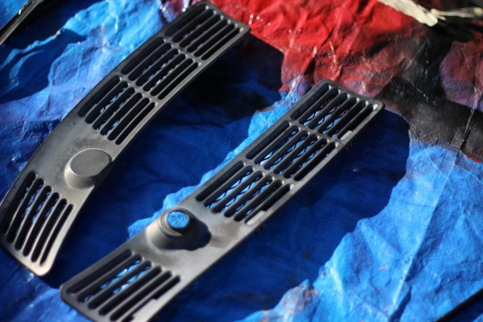

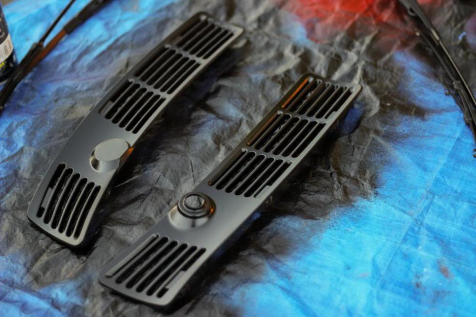

                        Also painted these up as they were looking very old and faded
                        I also cleaned up the old fuel injectors from my mk3 VR6 which had been professionally reconditioned shortly before I wrapped the old beast around a pole, and decided to swap them into the e30, as I believe one of the injectors which were in there (which were ford mustang injectors) was stuffed (it was reading ~9ohms while the rest were at ~16). The VR6 injectors are a little bigger, around 20lb/hr from what I can find, while the ones that were in there before were 19, and stock are like 15 or 16 I think. I tuned the AFM to compensate and it runs great!
