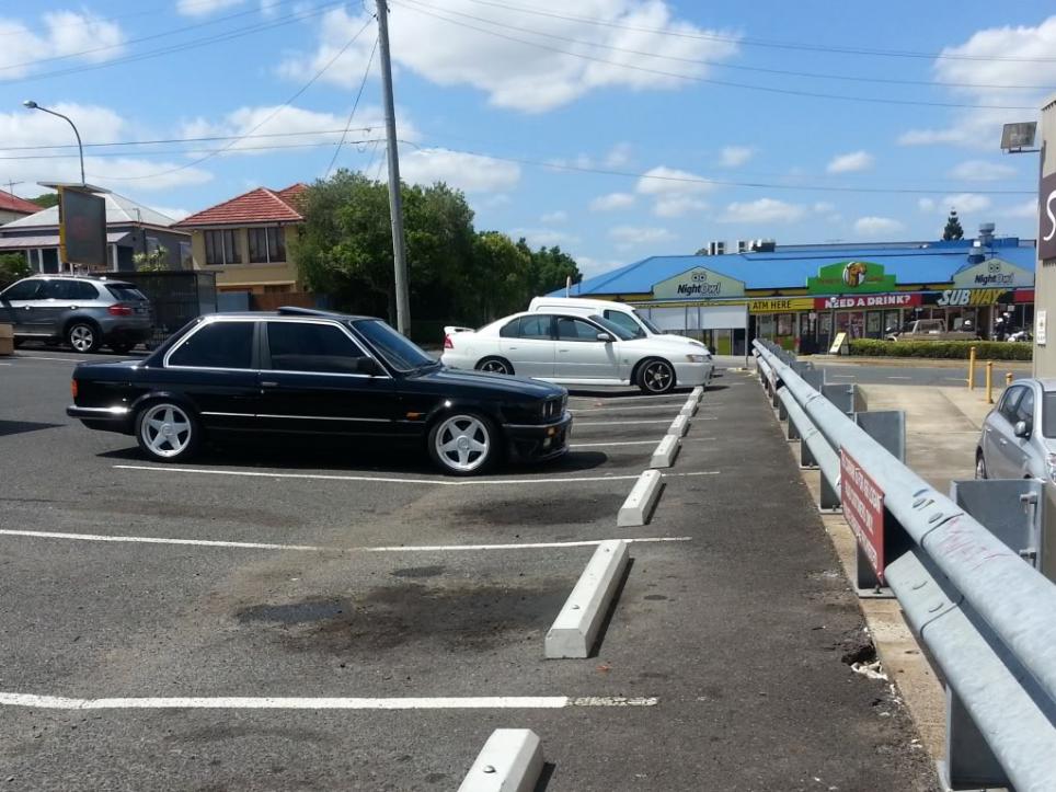

    Hi guys, thought I'd make a bit of a thread for my e30, even though it's not a VW this is still the forum I spend the most time on by far, and I know there's a few people interested in watching the progress, so instead of continuing to post about it in the mk3 section, figured I'd make a thread here

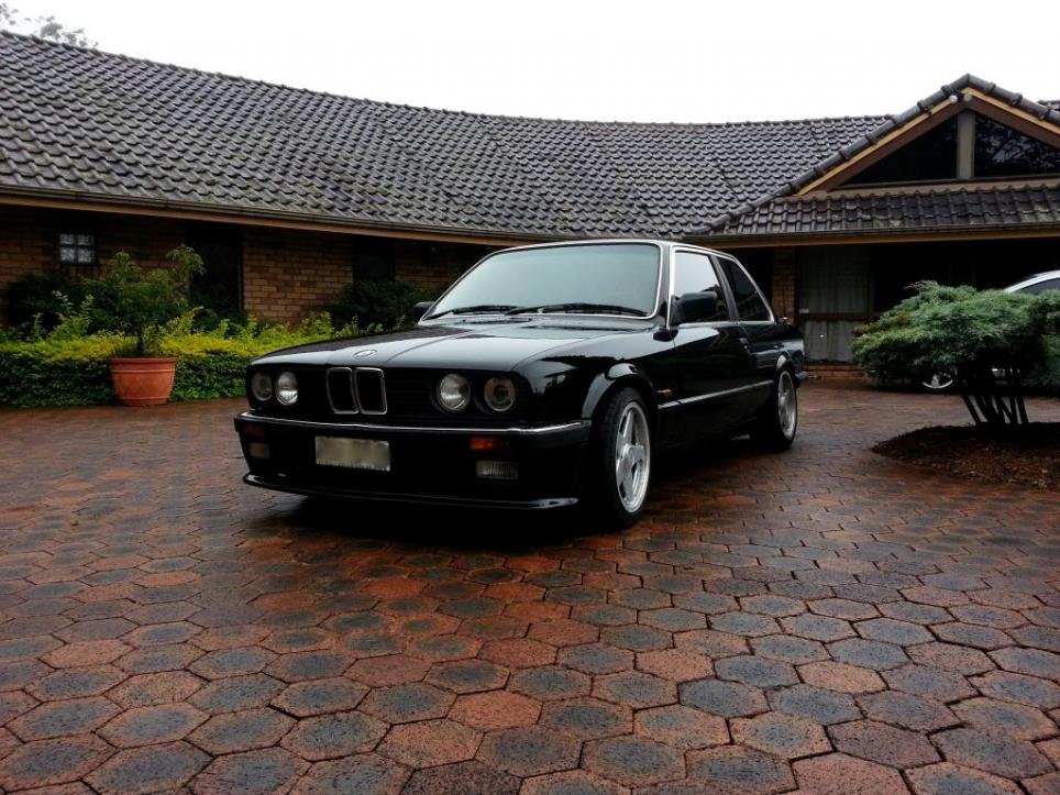

    Early in January I sold the bagged mk3 and soon after flew down to Sydney to buy the new toy.
    It's a 1986 e30 325i which was imported into a Australia from London in '99. For those who do not know these cars very well, the 325i was not brought out here (or anywhere except Europe I think) until '88, where the e30 also received a facelift and changed from the chrome bumpers to plastic bumpers, among a few other changes. Basically, this "series 1.5" is pretty rare in Australia, would be surprised if there was more than a couple in the country.
    Has all sorts of luxuries my mk3 didn't have, like power windows and sunroof and aircon, and the previous owner had done a lot of work on it, including a respray of everything except the bonnet and boot, 288 shrick cams, 19lb/hr injectors, exhaust, lowering springs, Azev type A wheels, etc etc.
    Too much text, so more photos:

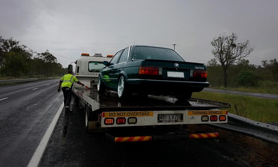

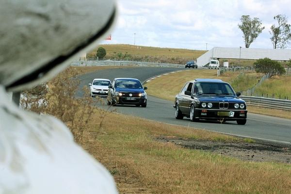

    Drove it back to Brisbane and it didn't miss a beat. Took it to the track for "happy laps" and had a blast. Got a roadworthy and registered it in QLD. Things were going pretty well until the ECU fried one day on the highway...
    Got it fixed up and took it out to another "Happy laps" in the rain, this was a bad idea...

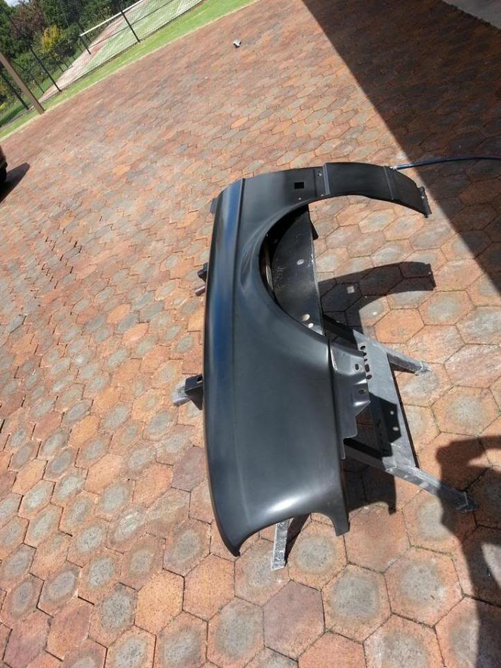

    Got a fender off a mate, and straightened out the bumper with a hammer and continued to drive it like that for a few weeks

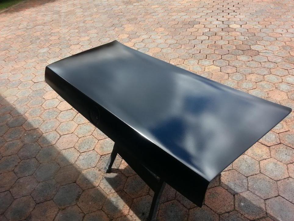

    Bought a new spray gun and a spoilerless bootlid and painted some things up over easter.

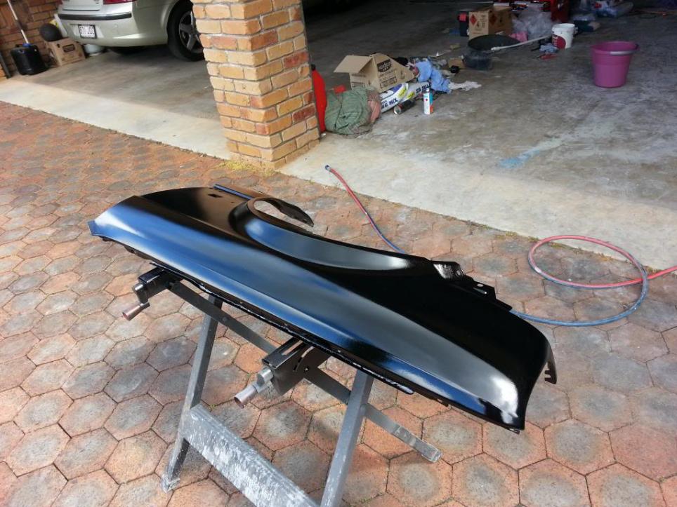

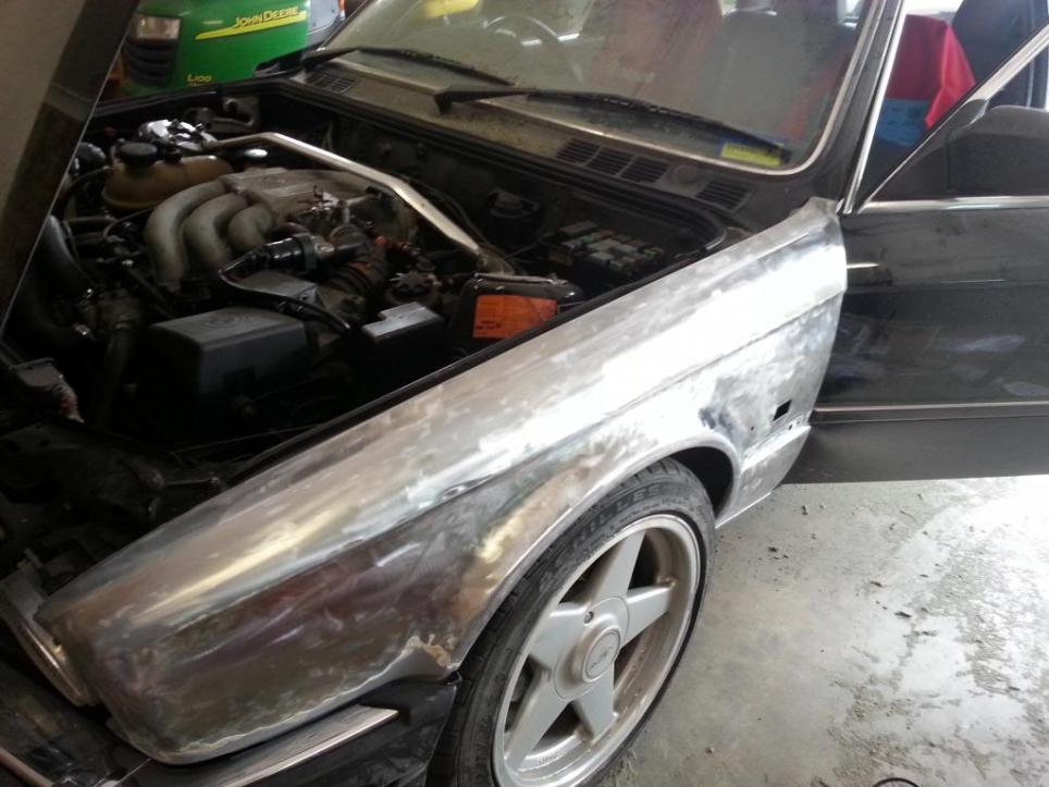

    Took the fender back to bare metal (obviously not completed photo)
    Sprayed with etch primer, then primer surfacer, wet sanded the primer with a block, sprayed a few coats of colour, then wet sanded the colour:
    About 6 coats of clear, with the last 2 coats being thinned out significantly more to flatten it out
    I'm very happy with the finish, It is acrylic which is never super glossy straight off the gun unlike 2k, but it does look good. Going to leave it a few weeks, maybe a month, before wet sanding it and buffing it up. Fairly confident that it should come up like glass and match the rest of the car when its sanded back and buffed. Guess we'll see in a couple weeks though. If it does come out good I might try the bumper and the bonnet myself as well.

      If your clear coat is even reasonably flat, just hit it with a machine polisher I reckon - thats worked well for me in the past (random orbital with farecla cutting compound). Sometimes I get scared around sharp curves using the wetsanding because its so easy to go right through

        I'll definintely try just hitting it with the buffer before sanding, it is pretty flat, a lot better than my previous attempts at spraying on the old car when I was using cheap gear and had no idea what I was doing. The paint job the previous owner had done is amazing though, there is no orange peel whatsoever, and when it's clean the gloss is amazing, photos don't do it justice. The clear coat alone that they used was $1000 for 5L apparently which wouldn't surprise me. So to get these panels to look as nice, I think it will need a bit of wet sanding to get it perfect. I sprayed enough coats to leave myself some room for sanding, and I've wetsanded clear before (although I will admit, I did go through in a small spot when I got careless) so think I should be fine hopefully.

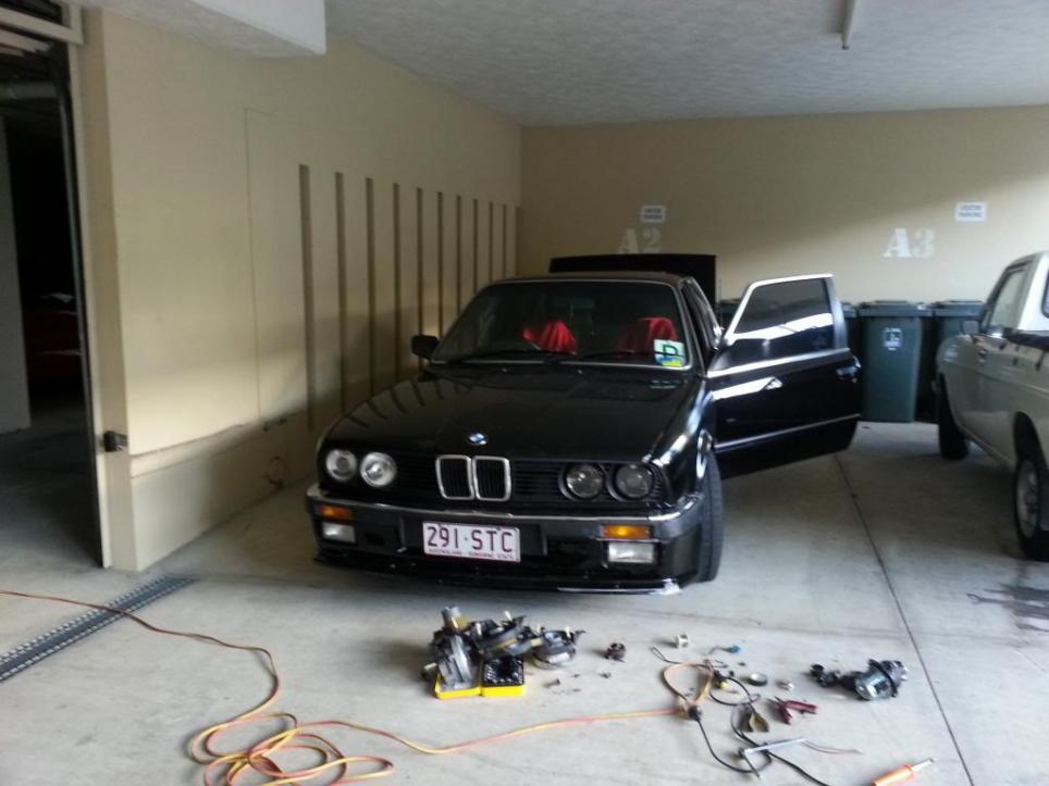

              Spent today building a pretty cool/complicated immobilizer with a twist, obviously wont go into details as that would defeat the purpose, but it will keep the "honest" theifs (those without tow trucks) from stealing it...

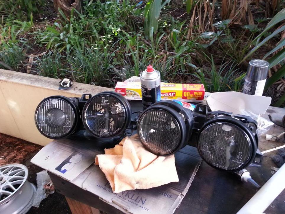

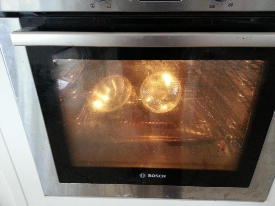

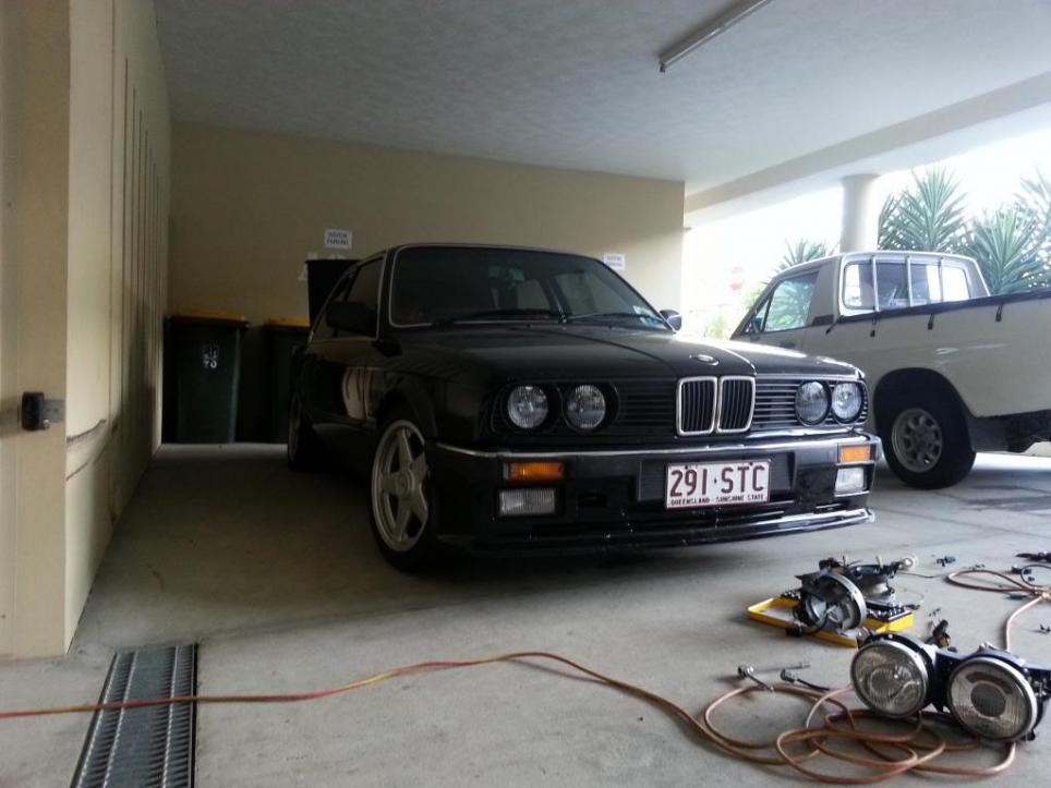

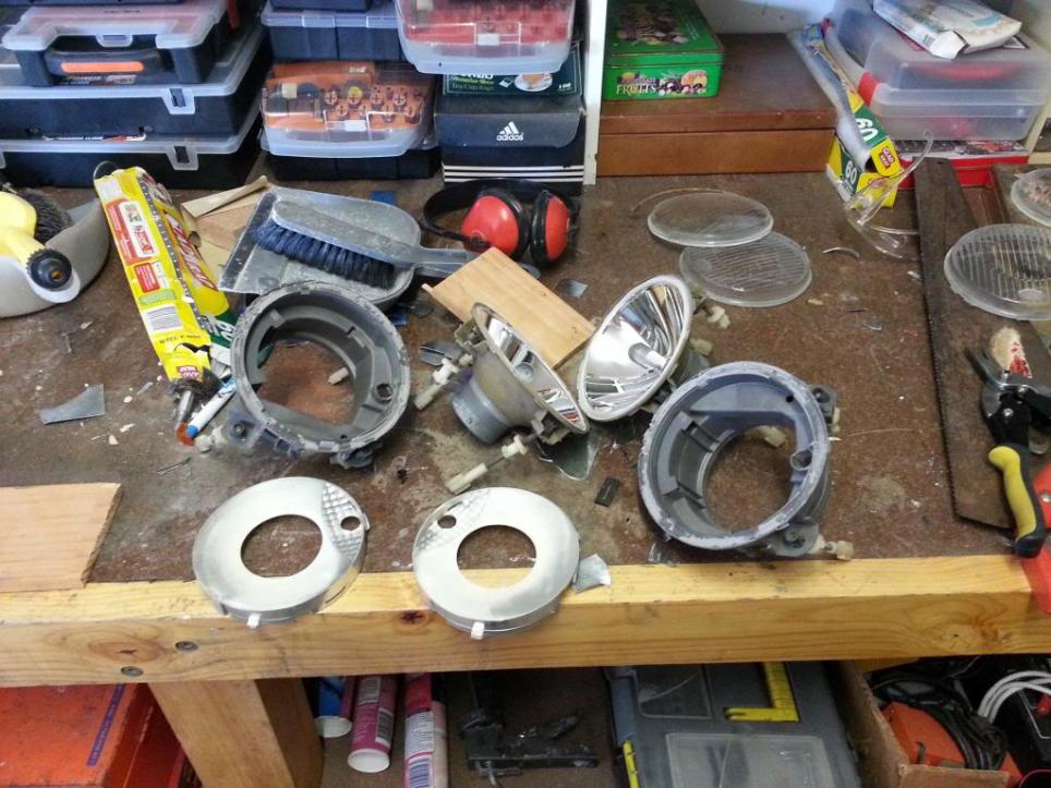

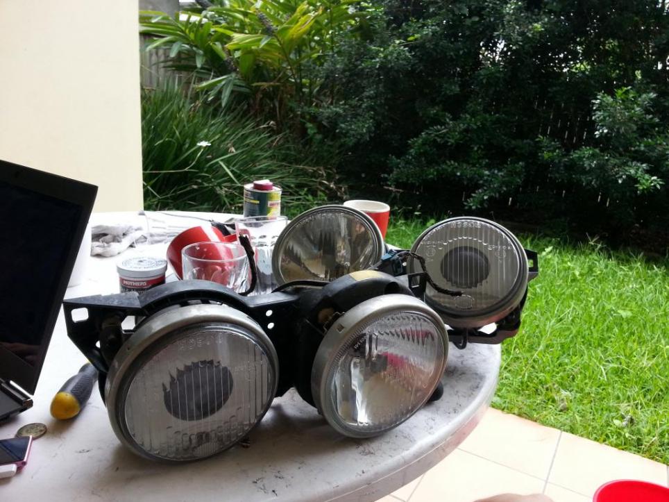

                        Picked up some headlights on Saturday as one of the surronds for mine was broken in the crash, making it impossible to aim properly. Decided to smoke them before changing them into the car. As the low beams are projectors they're very easy to do, the high beams take a bit more work though...
                        Bosch lights in a bosch oven...

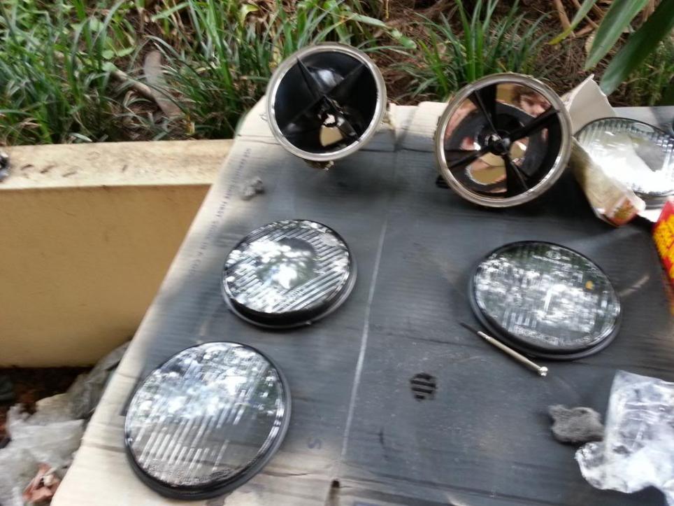

                        Here you can kind of see how the high beams are done, you basically make some pieces that make a cross out of sheet metal, paint them black, and glue them in. Doesn't affect light out put, but basically creates a cool smoked optical illusion. I also polished up the lenses and then painted the bottom and sides of them, and used black silicone to increase the smoked affect.
                        Sealing them back up
                        Finished product
                        Excuse the extremely dirty car
                        Very happy with how the lights turned out, not 100% set on the look though, I feel theres too much black (if there is such a thing). I painted the headlight trim rings black as well but I'm going to strip the old set and polish them up to a mirror finish, think that should look perfect with the rest of the chrome trim on the car.
