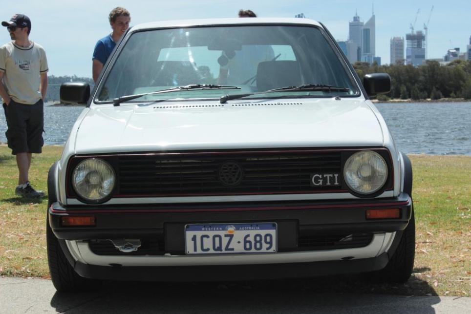

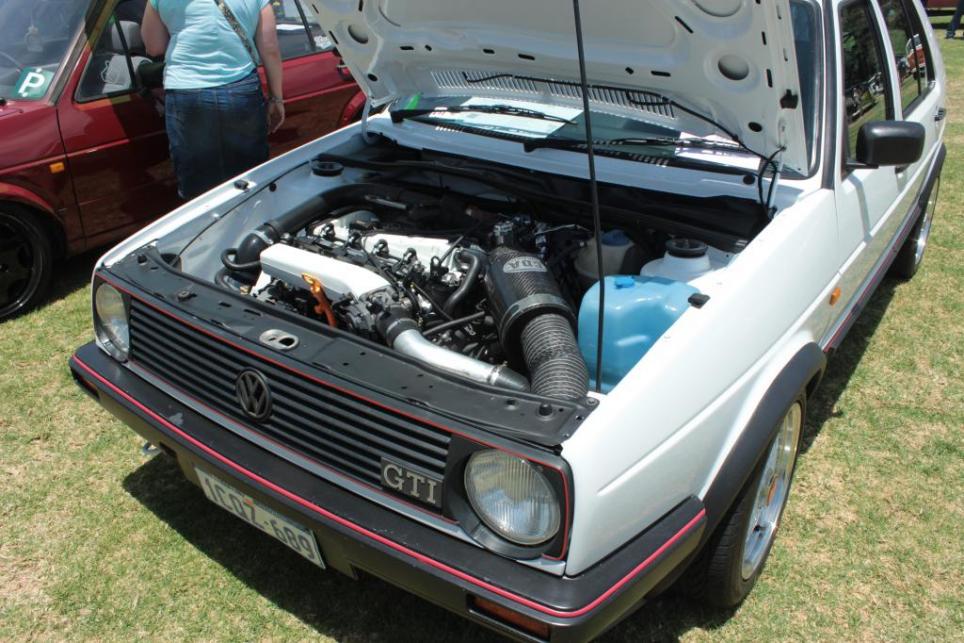

These pics are from DOVW 2014

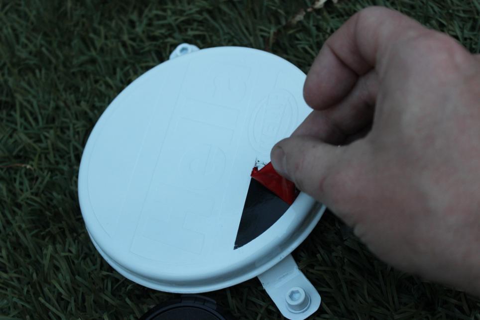

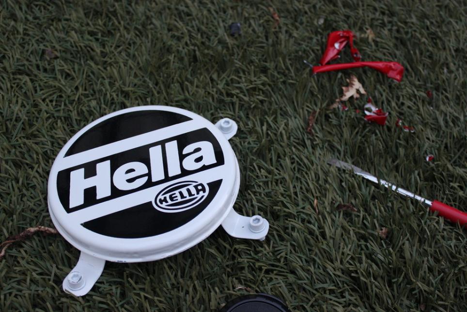

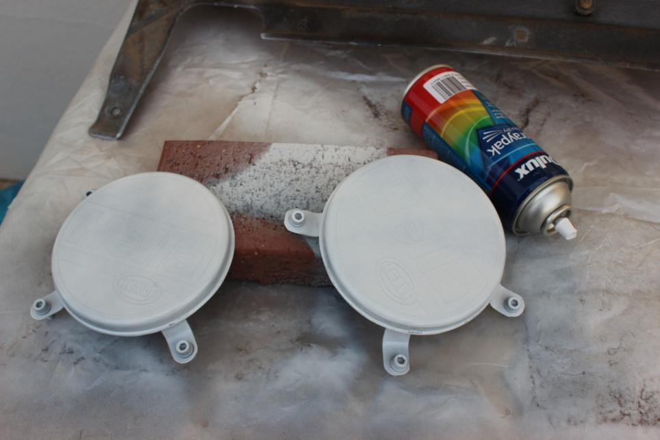

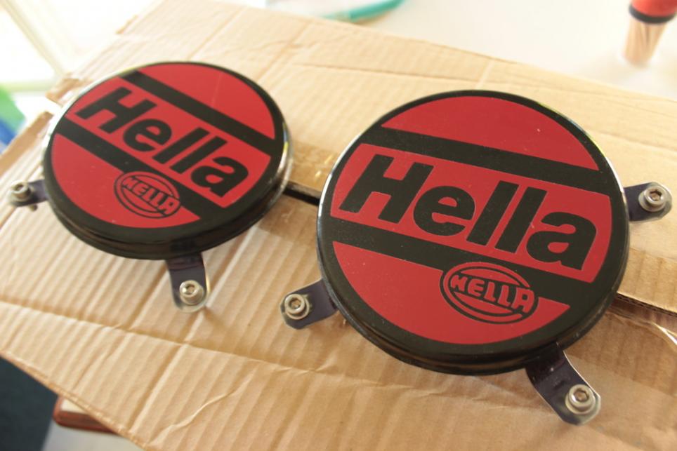

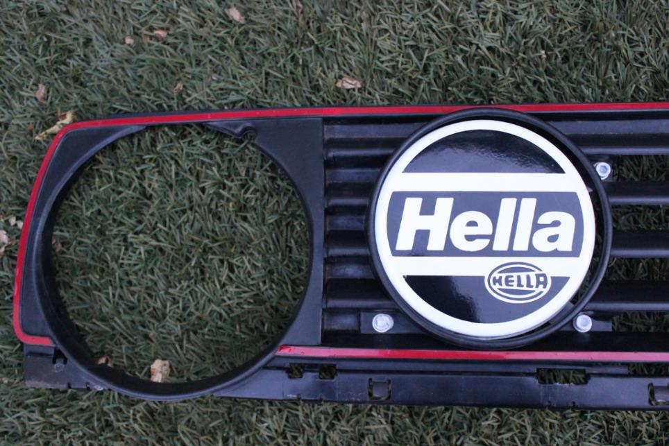

I got some fake hella blanks coz the single lamp grille is basically falling off. The red & black sucked so i used the red vinyl as a stencil...
