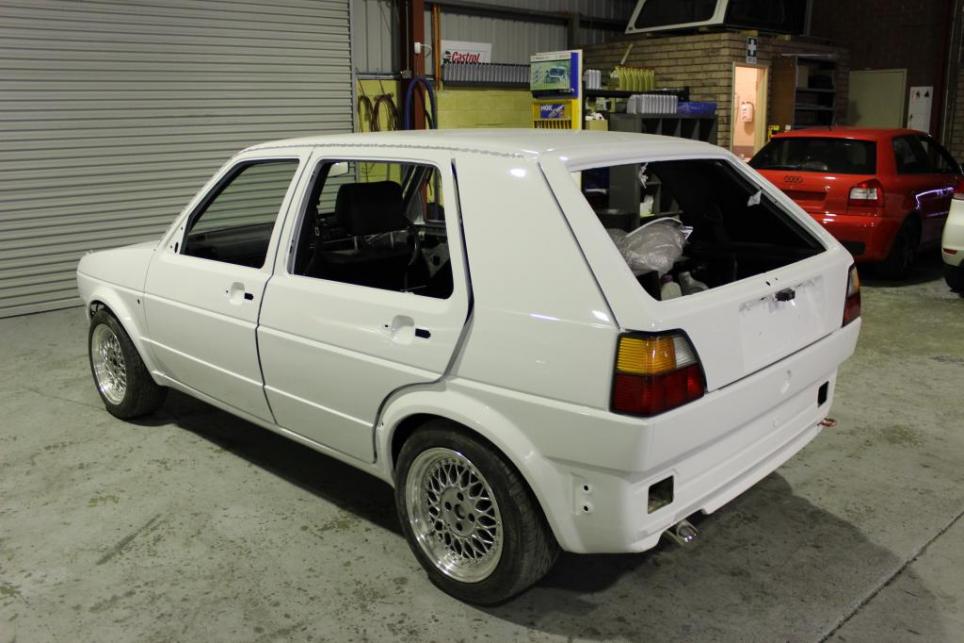

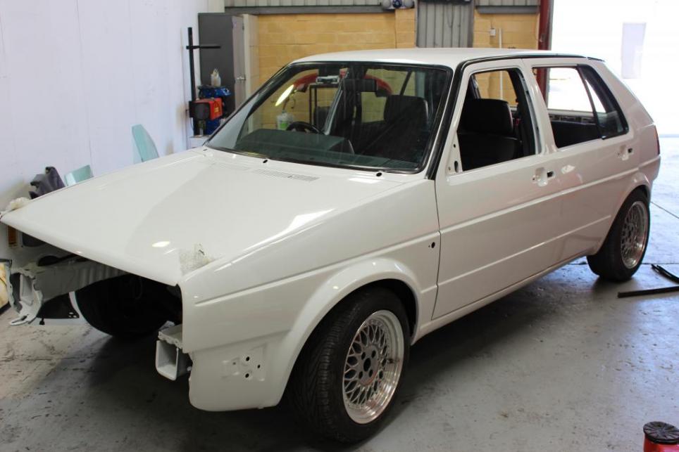

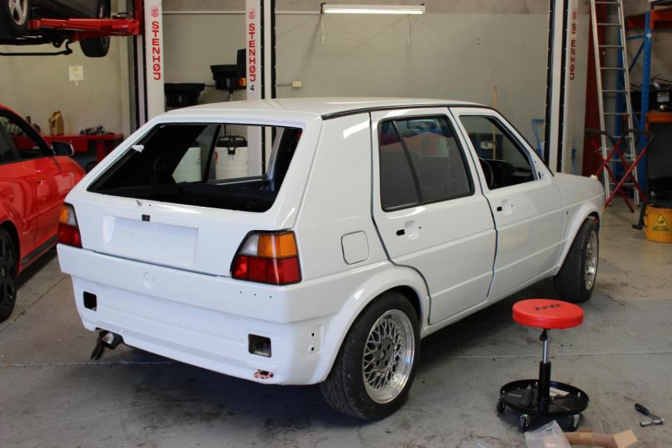

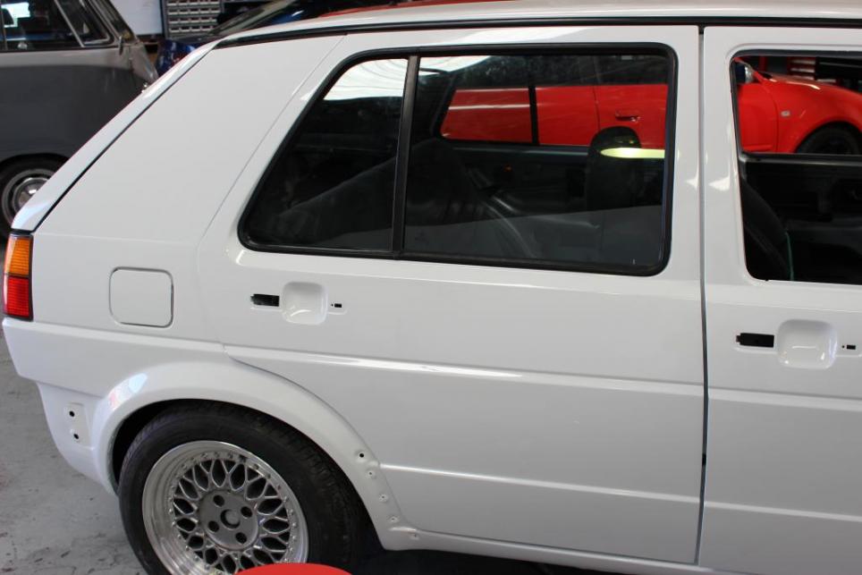

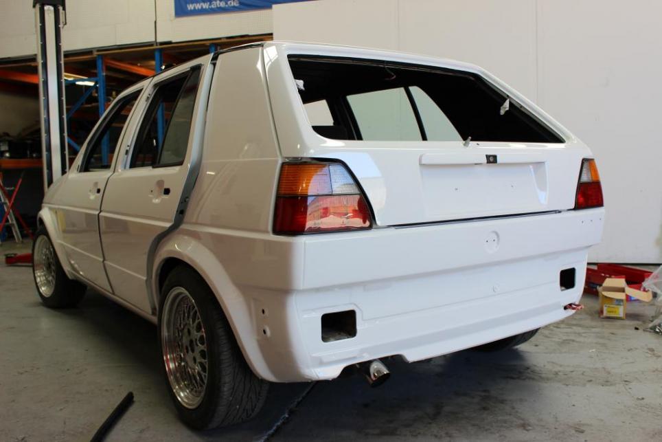

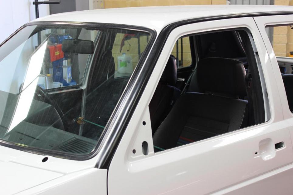

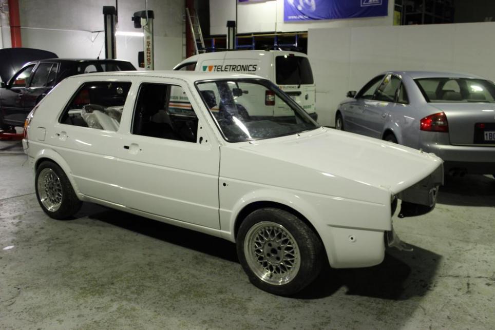

        • Progress is slow as i don't have free access to the car at the moment.
          Got all the headlining, visors, door seals etc in. No pics though.

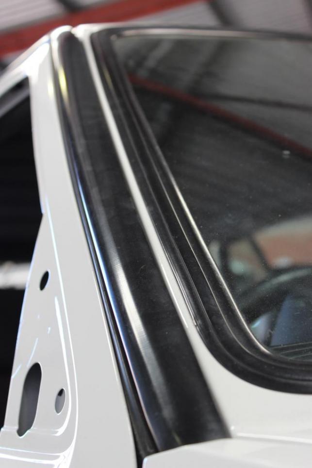

          ...The string technique worked a treat getting in the windscreen...
          tail lights...
          One door nearly done..
          Beautiful shiny new roof mouldings
          Also scored some fake BBS caps for my fake BBS wheels ;-P
          It's slowly starting to look like a car again
          • Phwoar nice!
            Where did you source all your new seals and the roof moulding?
            What a difference putting new ones in makes to the pop / contrast.
            Geoff - a work in progress for sure
            • Originally posted by tinto View Post
              Phwoar nice!
              They're actually all 2nd hand so far. Just a rag and some windex to clean them up. The roof mouldings came off that silver one i wrecked earlier this year. It only had 80,000k's on it so all the rubbers were really nice! I just got lucky man.
