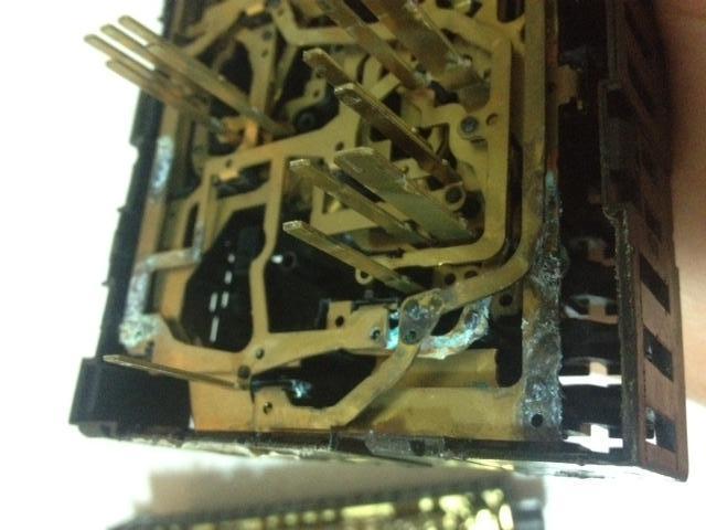

      A while back i got some water down in the fuseboard which caused the wipers to go nuts. I checked the fuel pump relay the other day and there was some pretty gnarly corrosion there and i thought i'd found my problem.
      Anyway, roccodingo sorted another CE2 fusebox for me and after putting it in last night it has done four fifths of f#@*all.

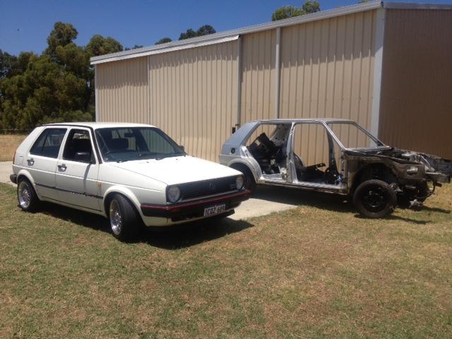

                • Here's a random pic of the last car i'll be wrecking for a long time (too many spares and not enough room!). I now have most of the parts i want to tidy up the trim & bodywork, as the silver GTI was low k's and really tidy.
                  And here's the corroded fusebox! As i said before, it wasnt the cause of my misfire but it certainly needed replacing!!!
