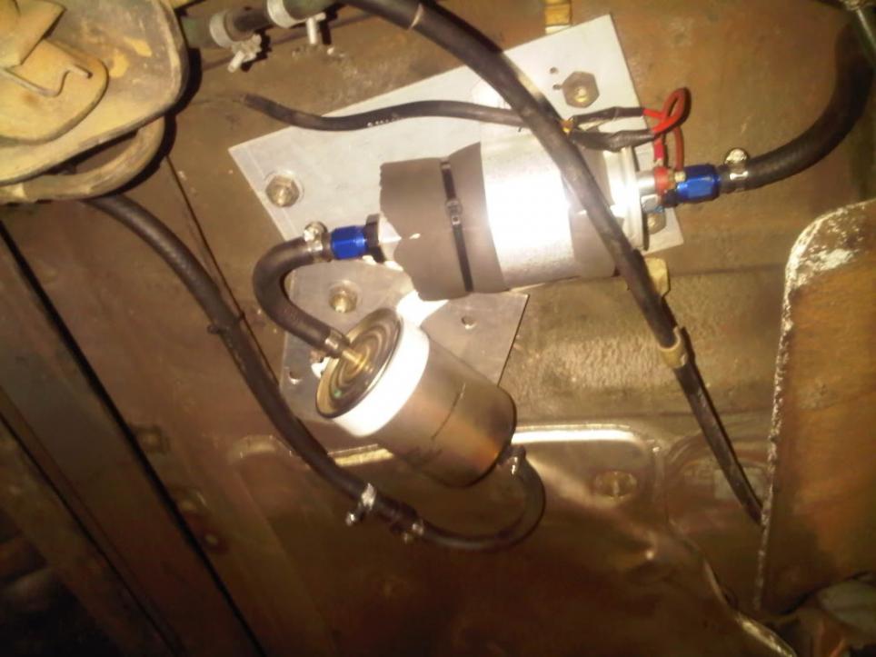

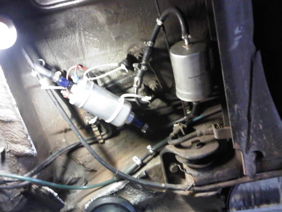

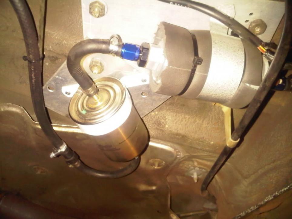

This was done a little while ago, but here's the fuel pump/filter mount-up i did. It's not a show stopper of a job, but it's a job!
Was better than this cable tied mess!!!

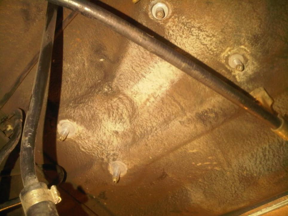

I basically used the existing mounting locations from the original (now deleted) accumulator setup, and just screwed up some aluminuim plate with rubber and foam 'bushings' to attempt to reduce the extreme noise that Bosch 044 pump makes

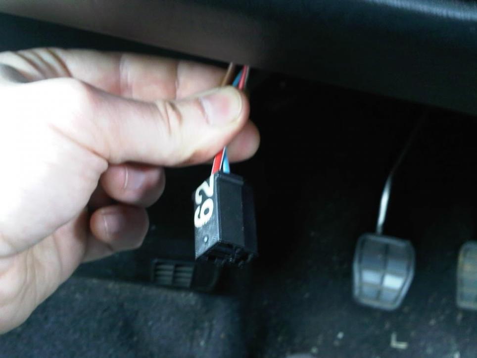

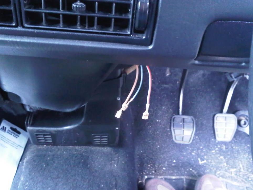

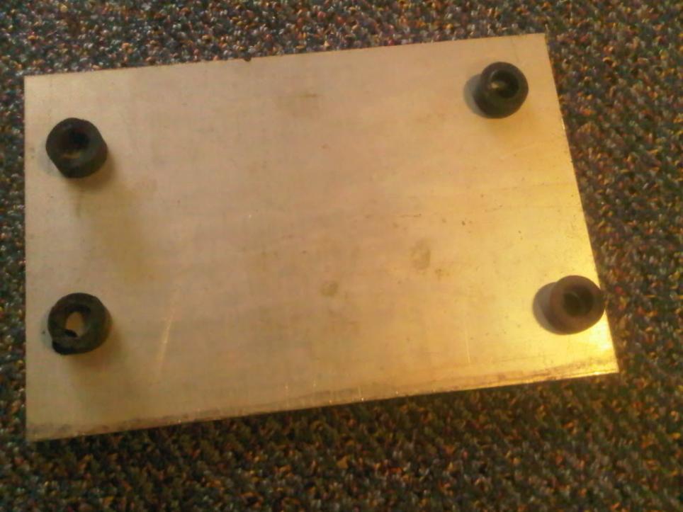

And yes, i did replace the gaffa tape and put on some proper wiring shrink sleeve!
