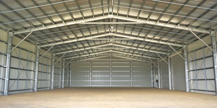

Basically this runs over the last couple of weeks of pulling the old one down (which was housing the GLD, haha) and then the shed dudes coming in to do the earth works and boxing for the slab.
This weekend, the plumber and I did the plumbing for the slab and today I dug the trench for the 3 phase power. All this stuff has to be done before the slab is poured. I won't be connecting 3 phase straight away (going to cost me 2k for that), but I'll run the wiring etc. Same goes for the toilet, shower, hand basin, wash basin. I'll do that when I can afford it, but putting the plumbing in now is a must. You'll notice a sunken section in the ground works for a hoist pad if you look closely, too.
Shed size is 14 long by 6 wide by 2.7 high with a 25 degree roof.
