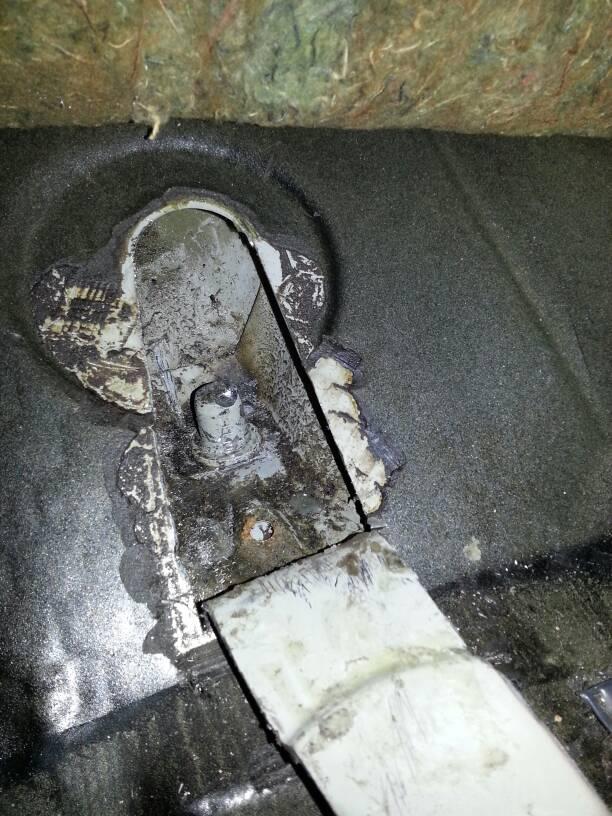

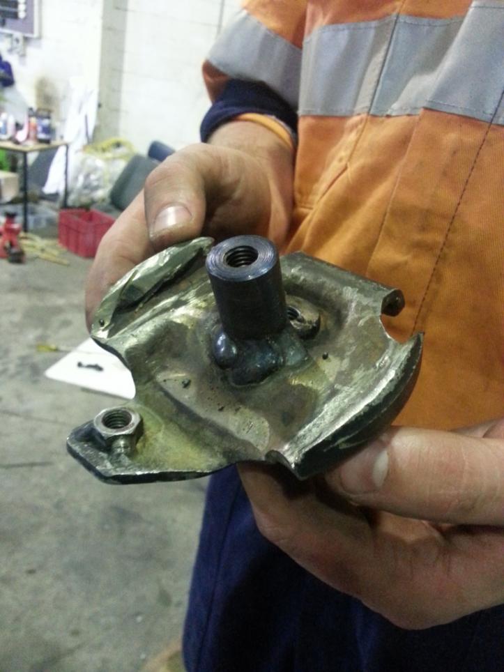

    Fixed the fubarred captive nut for the subframe yesterday.. re mounted the subframe torqued it all up

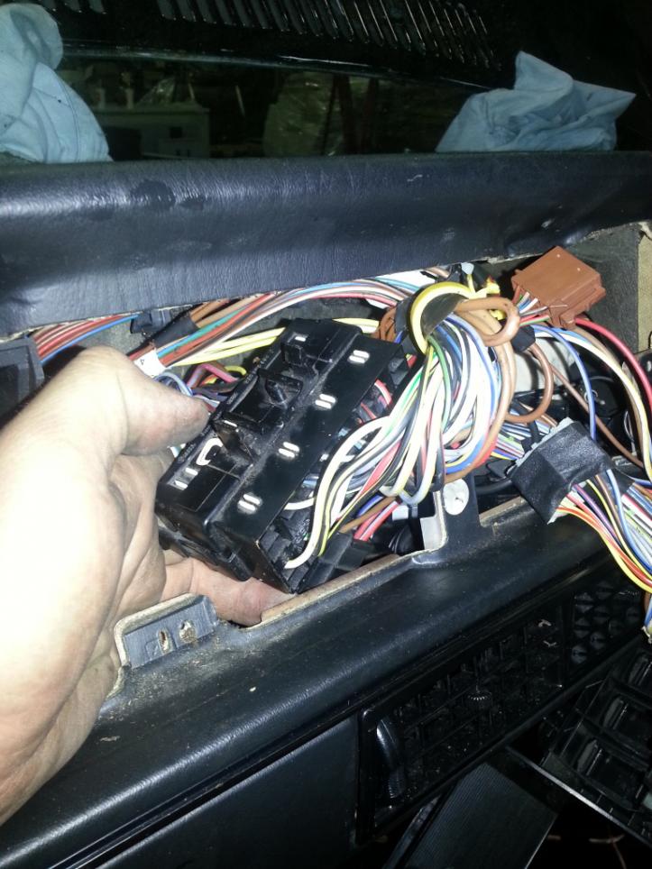

    Installed the Electric window regs and tested them!
    Ran the loom for the electric windows

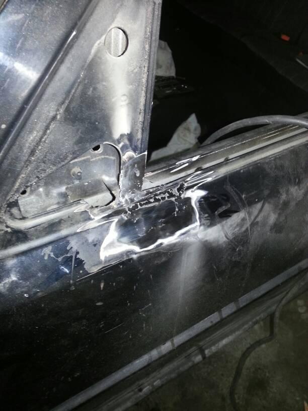

    Started welding up the rust hole in the door

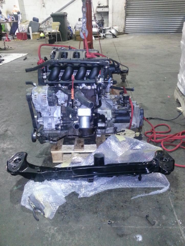

          The engine is edging closer to being re installed.. need the gearbox.. pick up new clutch and flywheel kit tomorrow..
          Need to finish the wiring for the central locking and electrick windows and then the interior can start going back in!
          And start fitting up various other bits and peices... sunroof seal.. new cable shifter etc etc...

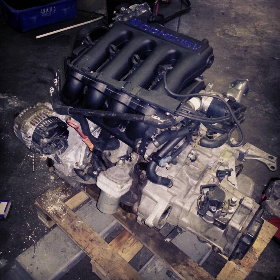

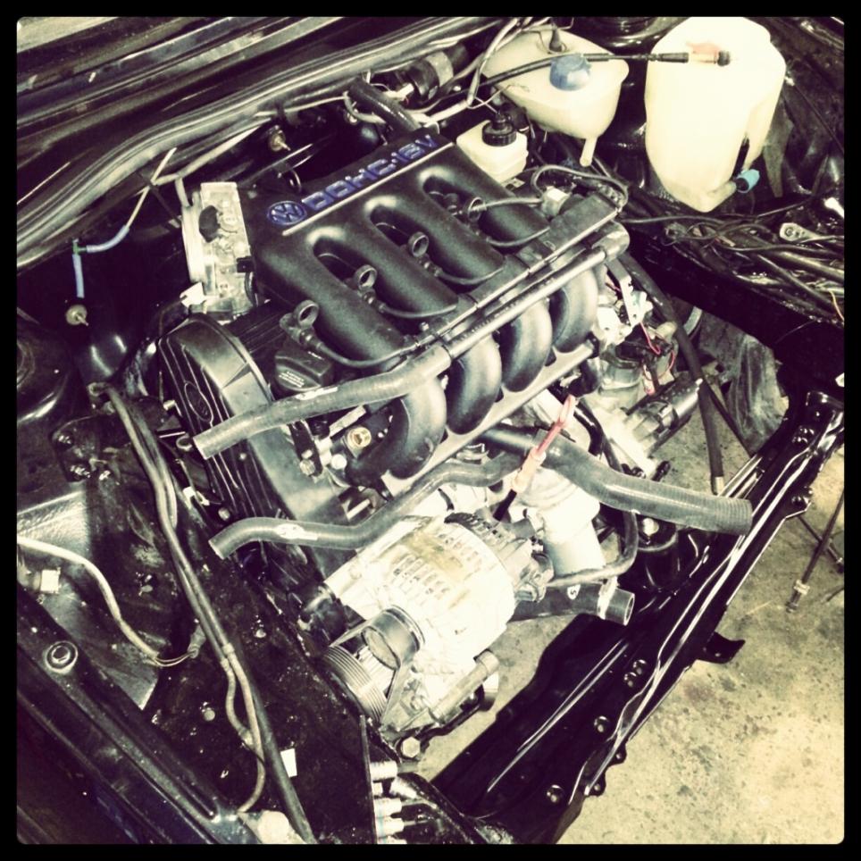

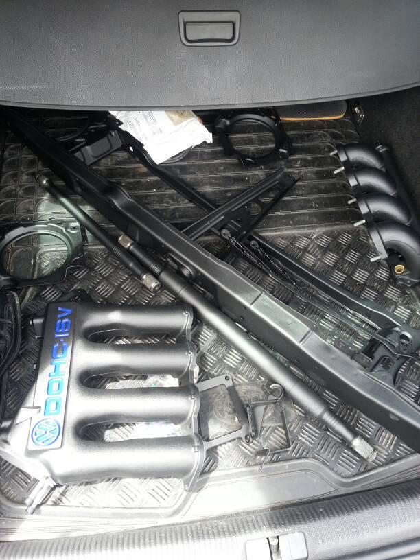

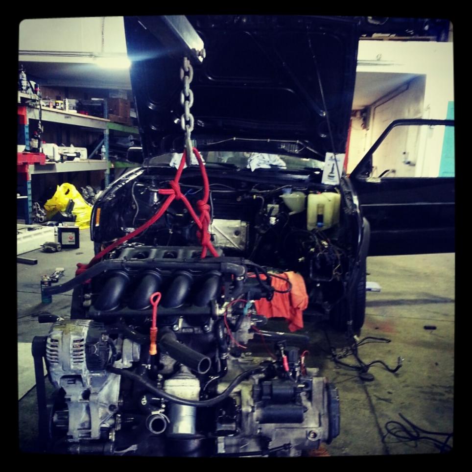

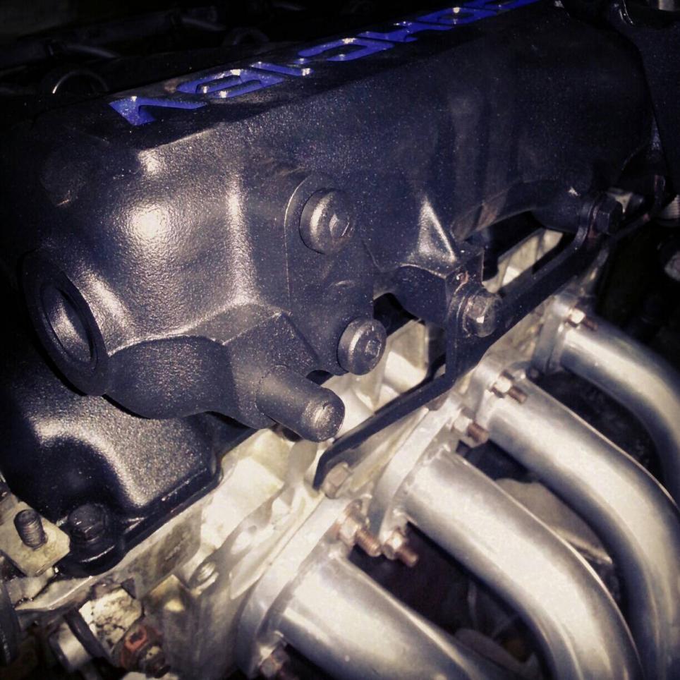

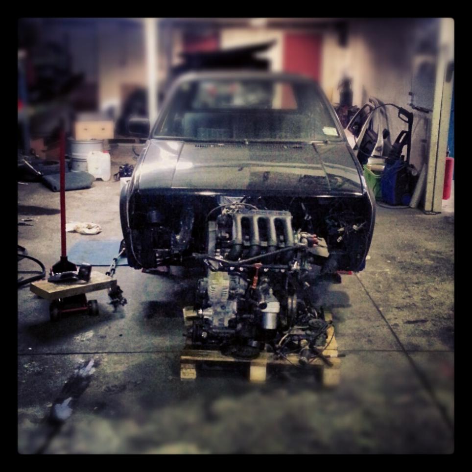

            What am i missing from the back of this intake mani!?

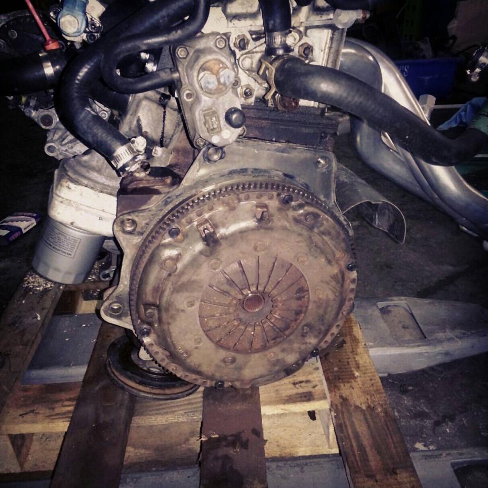

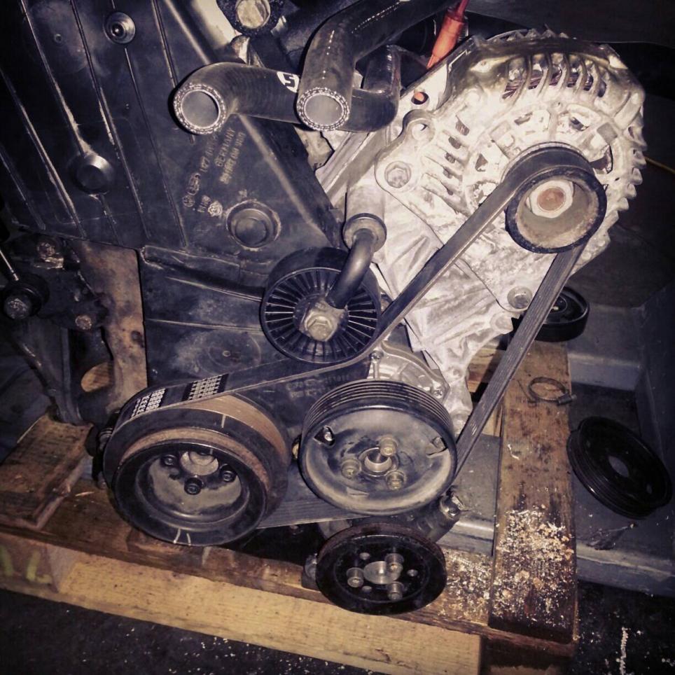

            Fitted the clutch
            Oil change on the gearbox
            And now the engine and gearbox are intercoursal again!
            Oh yeah hooked up the new belts!
            Sent via Tapatalk

            • #21
              a hose for one
              but those tapped holes, i have no idea. mine doesn't have anything there either
              '76 Golf LS Swallowtail 4dr
              '76 Golf Swallowtail 2dr
              '89 Golf GTI 16V 2dr
              • #22
                Originally posted by Stiggy_21 View Post
                a hose for one
                Haha thanks dude.. must be nothing then... hrrmm so where is the other lifting point on the engine .....

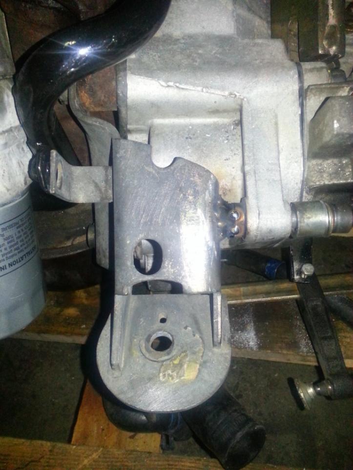

                Modfied the front bracket yesterday after work to work with the 02a quite simple just relocated one of the screwing lugs that normally hangs out down the bottom up to a higher point....

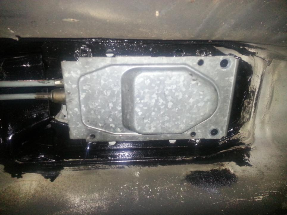

                Mounted the MK3 Gear Shift box
                The Back most point was later secured using a combination of Nutserts/RivetNuts and Cap Screws Strong as!

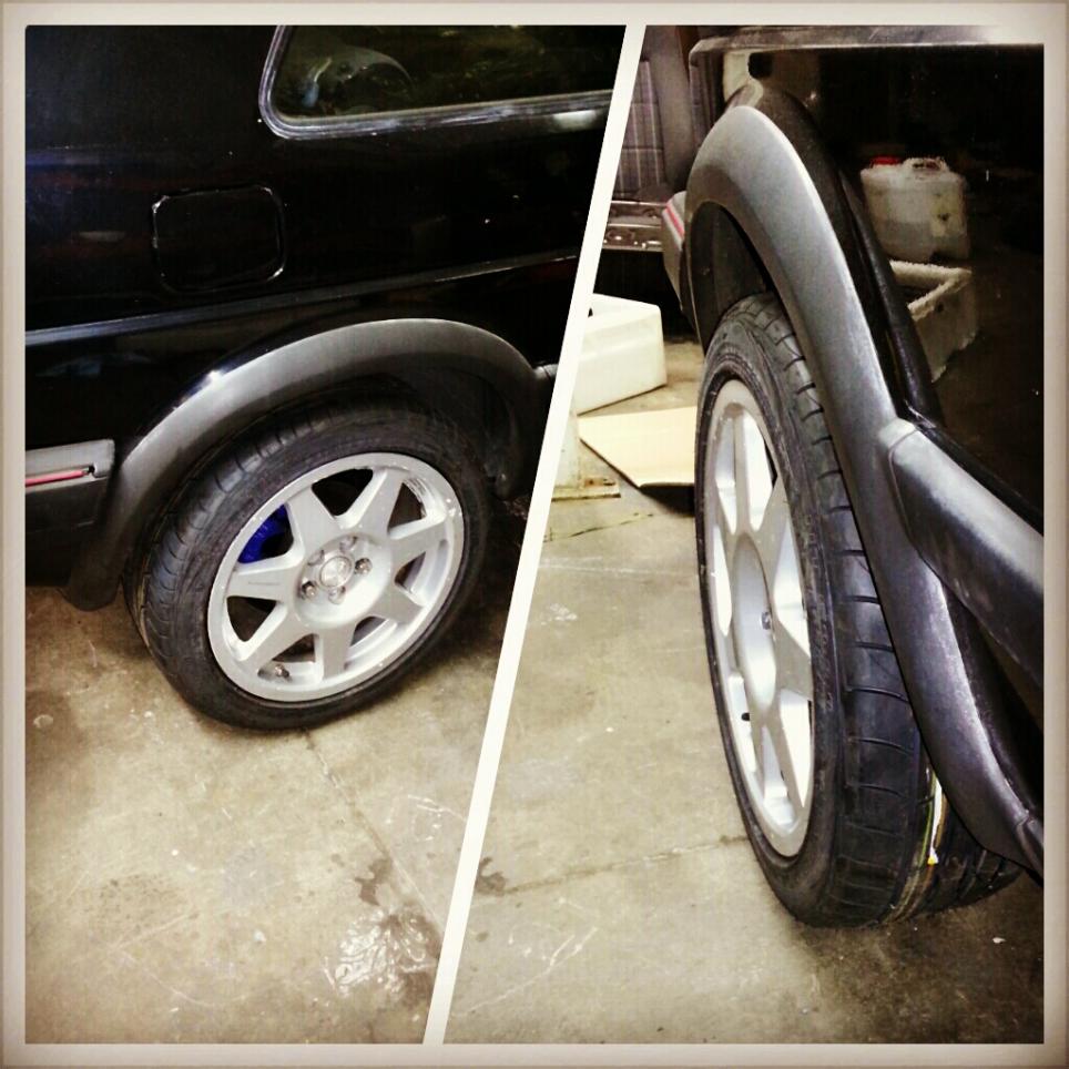

                Fitted up the New Temporary Wheel yesterday doo
                16x7 Technomagnesio ET30 Wheels (205/45/16)
                Im not in to super lows so hopefully this wont rub..

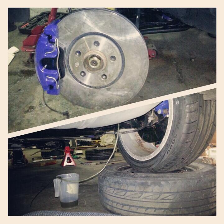

                    While she was doing that I finally completed the Braking system on the front having to use a combination of mk4 Bora 4 Motion Brake lines and twisting the hard line around and bending the bracket the lines seem to be sweet and allow for the turning of the steering axle etc..
                    Then my lovely assisted manned the brake pedal while I crawled underneath and bled a completely empty brake system.... (took fliping ages!!!!) but the brakes were bled finally **** hot!!!

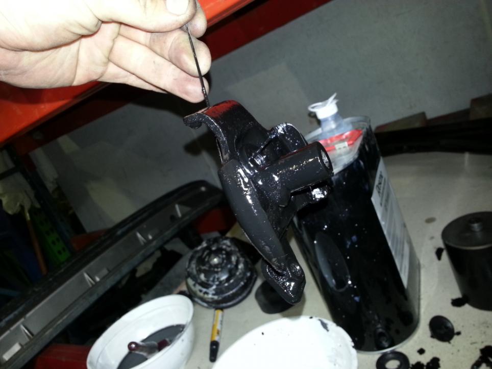

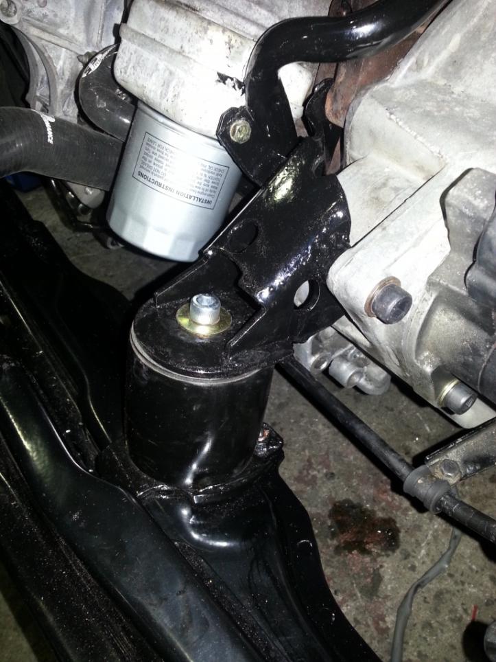

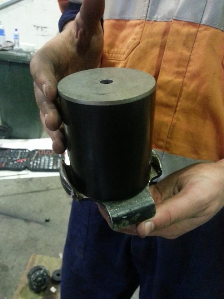

                    Tuesday night wasn't too bad either.. this car came with the Hydraulic front engine mount (something I wasn't really interested in keeping + it was FUBAR) I did have a Solid Rubber Front mount also that I could have used but that would have been no fun!.. + After buying a Complete BFI Stealth Engine mount kit from Dubaddiction a few months back I was adamant I was going to use the whole lot!)
                    My Cousin was In this evening we figured out what we were gonna do and cracked in to it... We butchered up the Factory Hydraulic mount to use it as a base for the BFI Insert to Seat on... once that was removed we found a High Tensile bolt that was almost thick enough and slid in to the centre of the bush. Parted off the head and drilled and tapped a M10 Thread right down the centre...
                    Once that was on and we found the correct angle for the mounting bolt we layered on some heave Mig wire with some very deep penetration for good measure (haha wouldn't want to read that out of context)
                    With Insert Seated on
                    Going to paint it up today with some Por15 and we should be ready to start bolting everything back in for the engine!
                    (engine aiming to be back in thursday night)
                    This mount Modification is experimental... I'm not worried if it fails as it will just prompt a different attempt at modding!

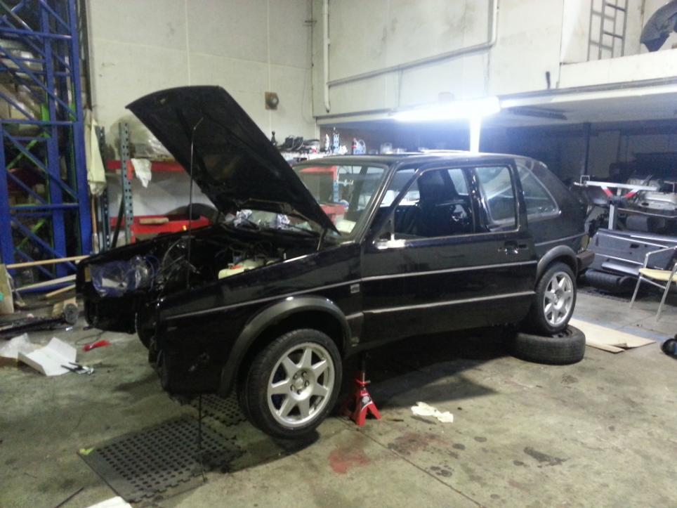

                    Front Wheels are on and car is back on the ground now too
                    Check out my Camber bro!!!

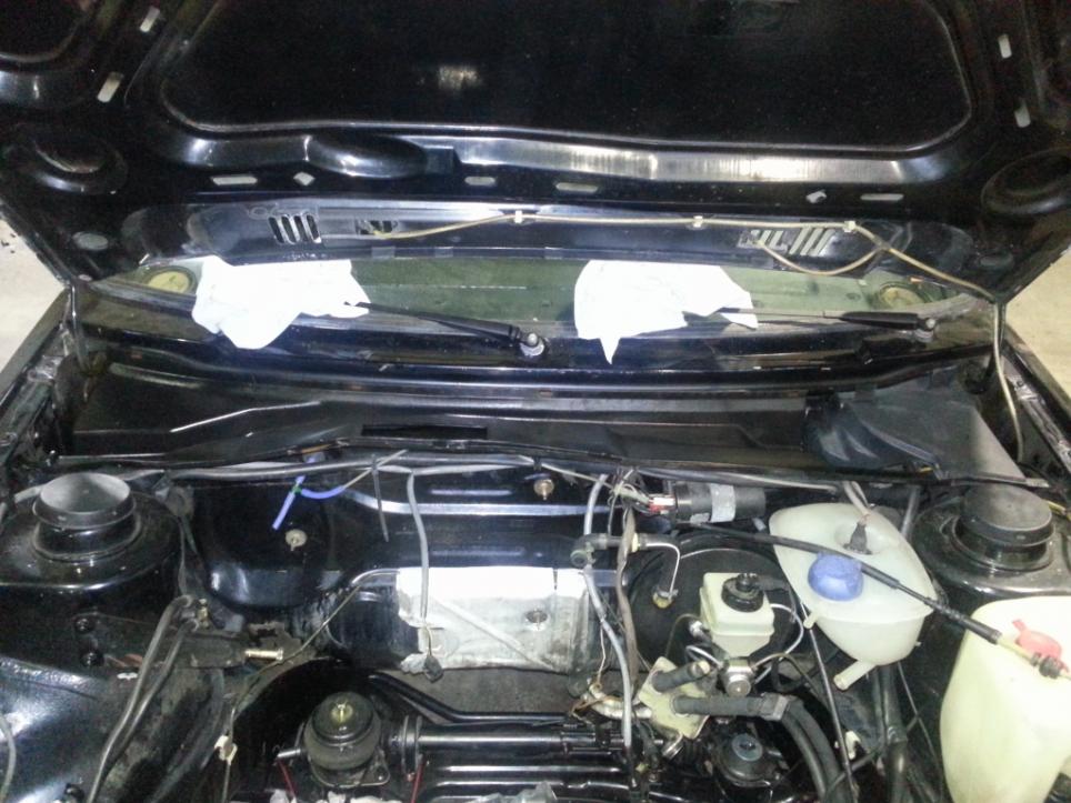

                      Short night tonight

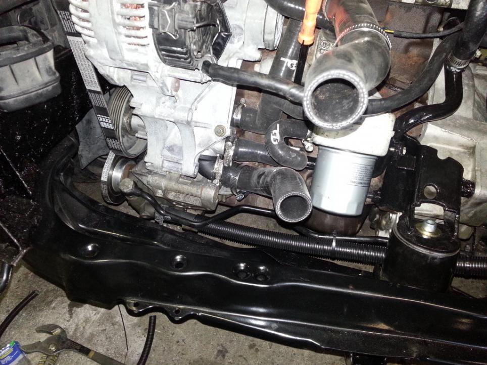

                      Front Engine Mount Painted up...
                      Power Steering Lines

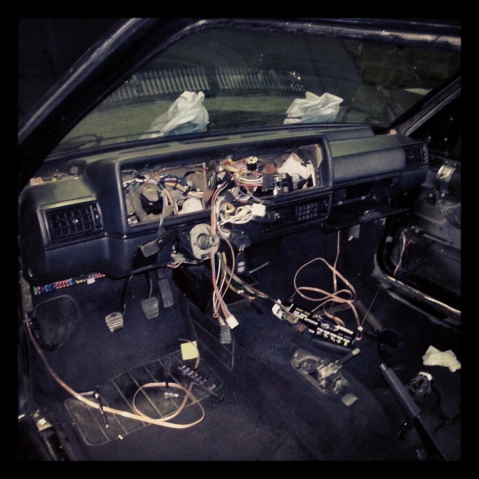

                      Dash Board Semi in...

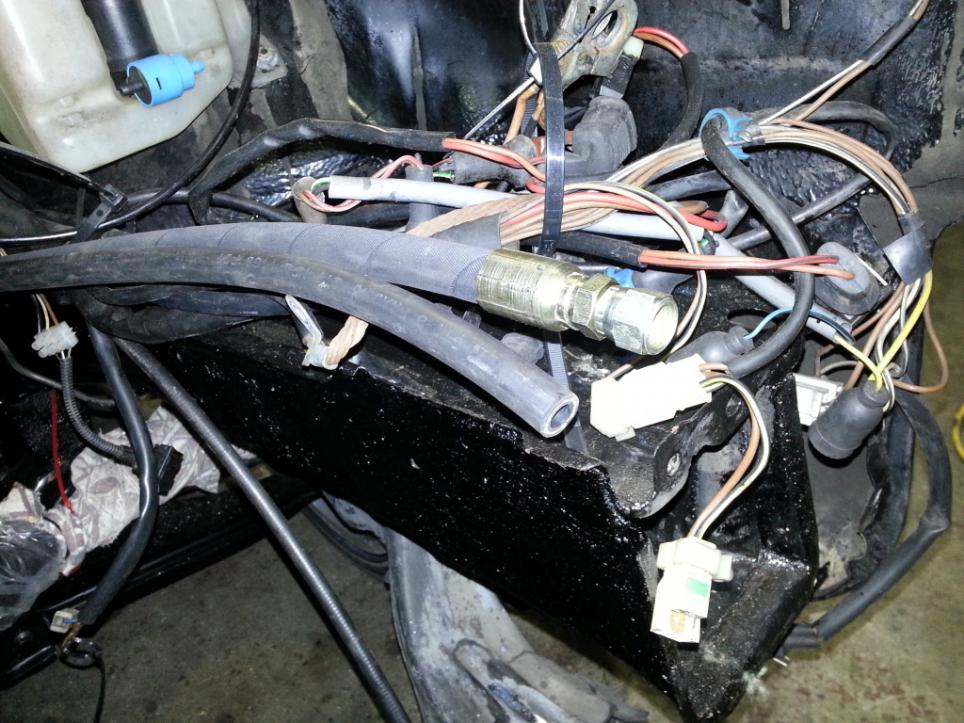

                      Does anyone know where the Body to Dash Plug Clips or secures to.. I have long since forgotten

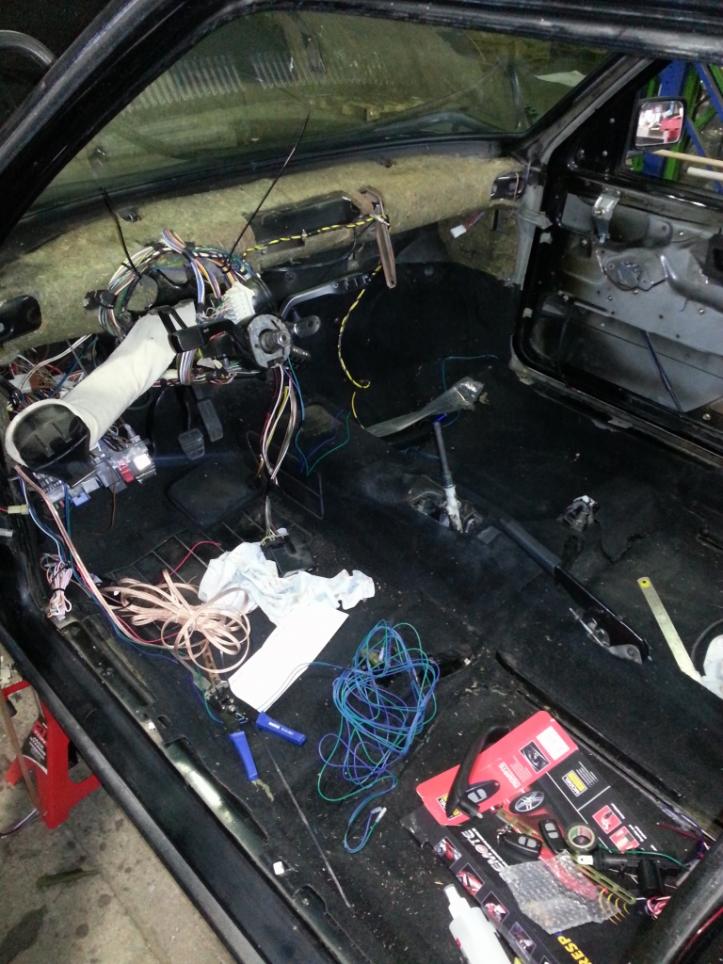

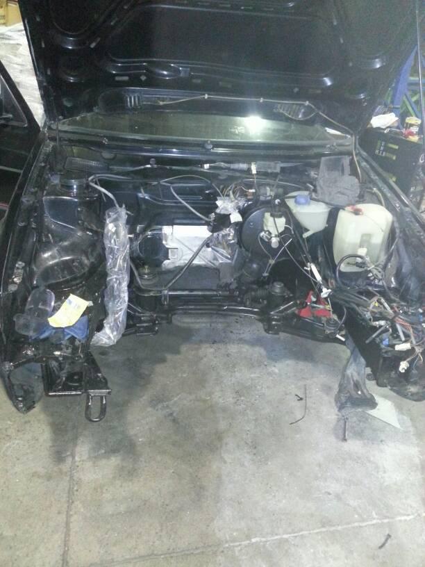

                        Not much further progress on the dash... Few more bolts in.. More wiring sorted/soldered
                        Where the Frig does that monstrosity of a plug get tied away to? ^^^^^^

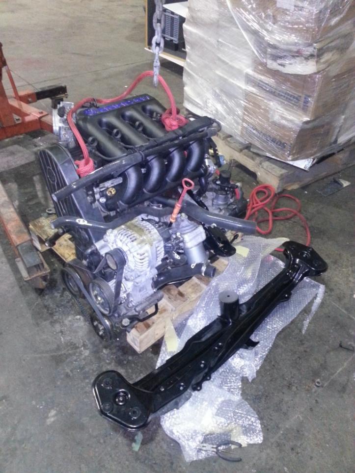

                        Started assembling the Front Cross Members and Engine Mount and the Engine is Hooked up to the Hoist ready to be put in to place...

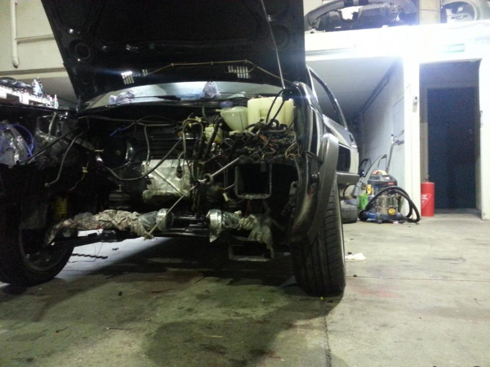

                        • #27

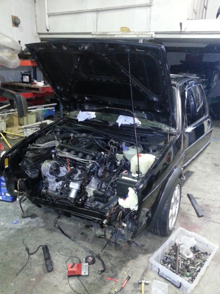

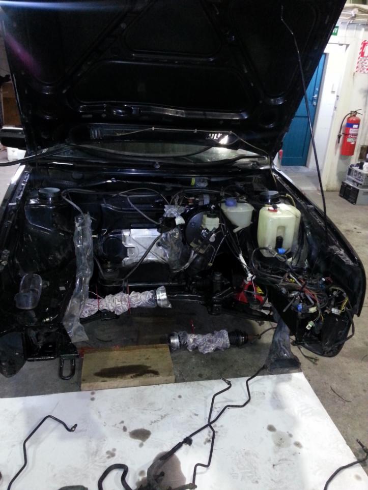

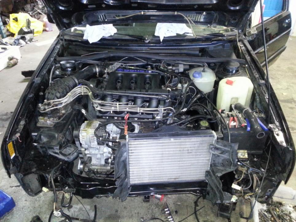

                          Well the Weekend netted some pretty good results...

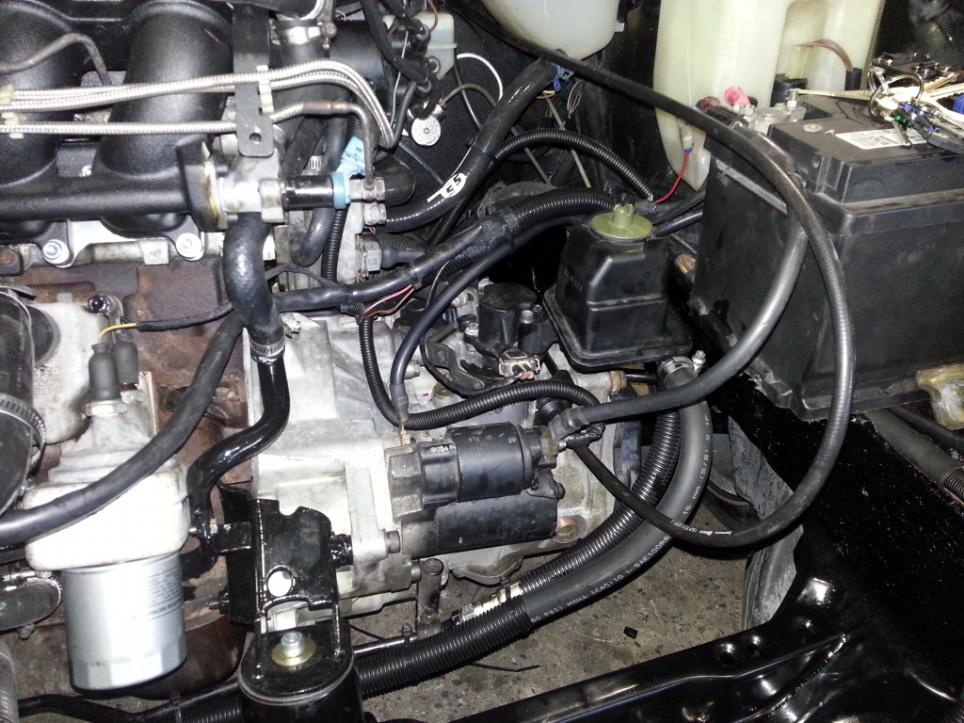

                          Engine is now back in and bolted up! Drive Shafts and all and the Cable to Hyro setup seems to be working fine too...
                          Drove the car forwards 2 feet ha!
                          The Front Engine mount Mod seems to have worked also!
                          Spent the Rest of the afternoon adjusting cable lengths etc (as a few things have moved since before the gearbox swap.)
                          All the Horribly Grey Cable Tubing I am slowly cutting off and replacing with Black Crinkle Tubing (much nicer and more flexible!
                          Engine Starts and Runs and Idles like a Trooper
                          Bit fricken loud at the moment with just the headers (no exhaust tube or mufflers)
                          Hoping to drive it this week and get it all road legal...
                          Just some more minor **** too also to get the Power Steering all plumbed up...

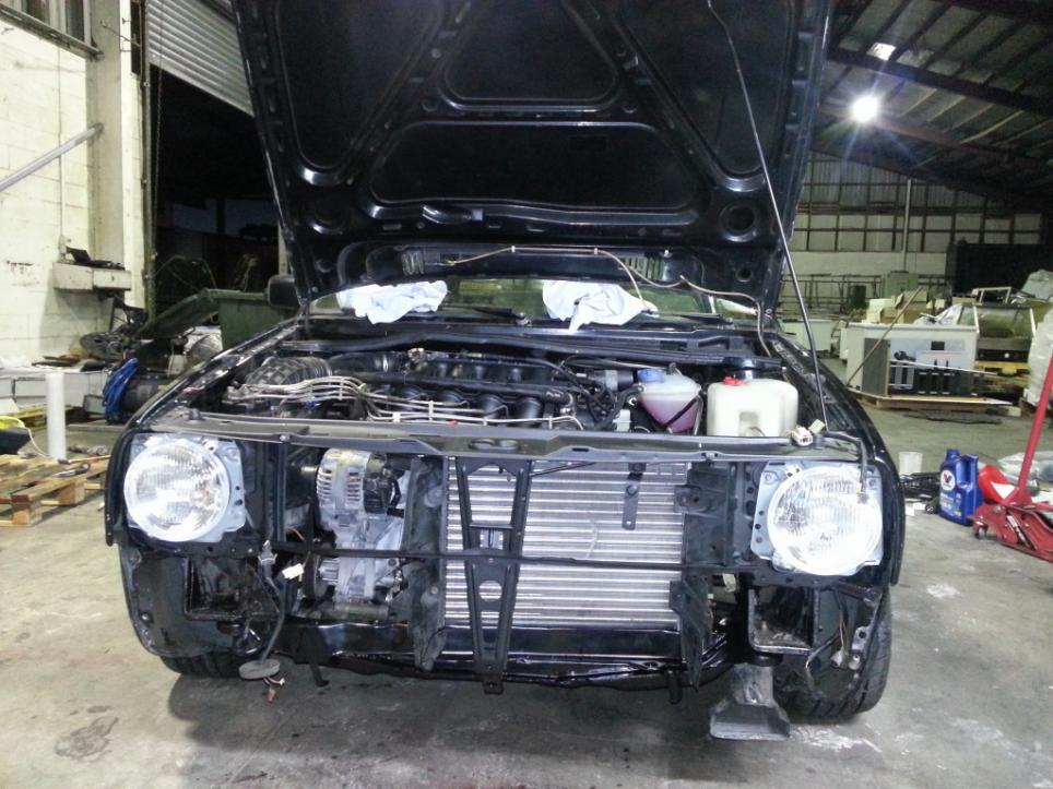

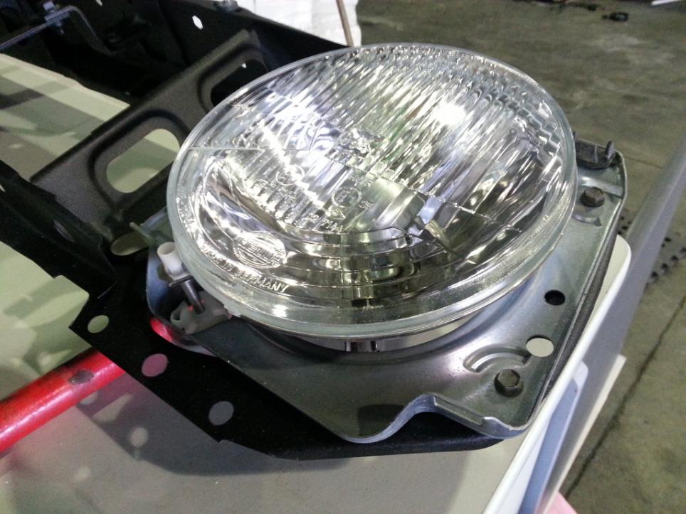

                              Fitter brand new hellas to the crash panel
                              Power steering system setup.
                              Fitted the radiator
                              Ran up the system and let it bleed all thru...only to find the Radiator Fan thermo switch is leaking from the bottom off the crush washer.... fk sake.. new one of those tomorrow and do it all again...
                              Oh yeah.... aligned the gear linkages
                              And started fitting the crash panel
