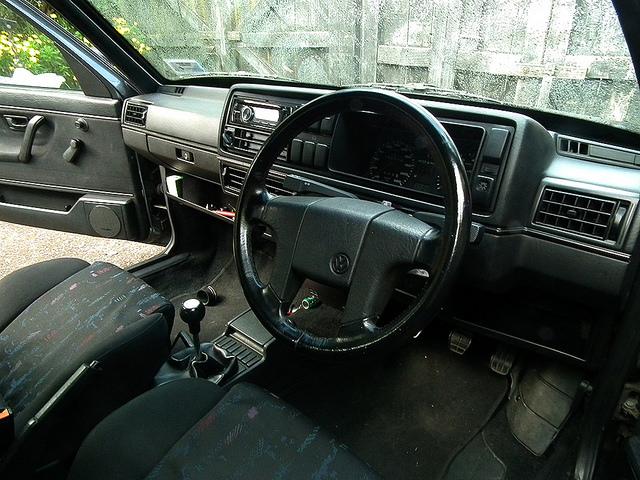

        You have done some great work on this car!
        Love the tartan roof lining!!

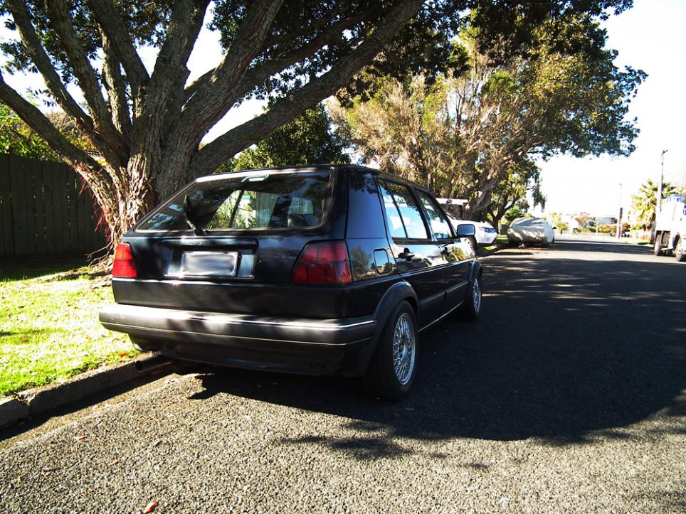

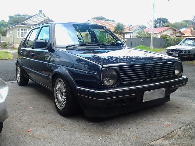

                    • Also, a quick update. Upgraded all the brakes with 256mm fronts, mk3 disc rears and 22mm master cylinder. I also installed the mk3 Jetta rear beam (the widest available) and 16mm stub axle spacers on each side. Back wheels sit so much better. Just need to get driveshafts and tie rods and I can widetrack the front as well. Braking is so much better now.
                      Oh yes and my steelies are sold. I will get some 14" BBS RAs in the future which are the same specs as these so will fit the same.
                      I have also finally got a wideband o2 sensor kit, have it installed and have been fiddling with the fuel settings over the last few days. It's not bad but the AFRs are a bit all over the place. Super rich at low revs on part throttle just when throttle is pressed (10s - 11s) then leans a bit to about 12-13 which I'm trying to sort. At least it's not super lean and melting pistons! I think the needles need to be adjusted or replaced as the idle mixture screws do nothing to change this. High revs and full throttle and it gets better, generally seeing 13s but I need to do more testing to be sure. Might post some graphs later if I remember.

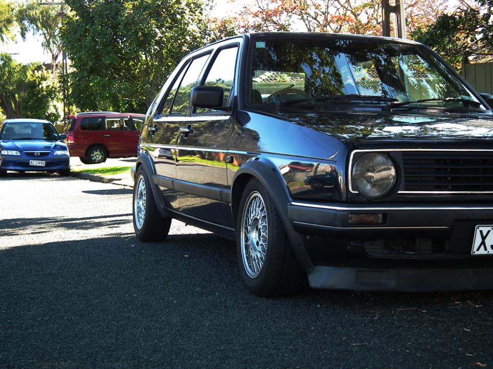

                      • The back looks much better but why are you running G60 arches (the widest available) on the front but standard arches on the back?
                        • Originally posted by sports racer View Post
                          I'm not, all arches are 8v arches, I just haven't installed widetrack on the front yet. Just neet to get the driveshafts.

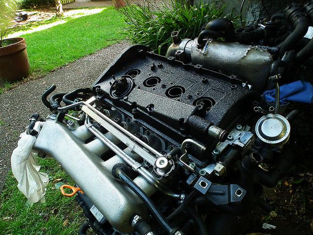

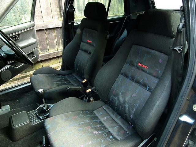

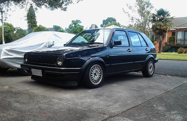

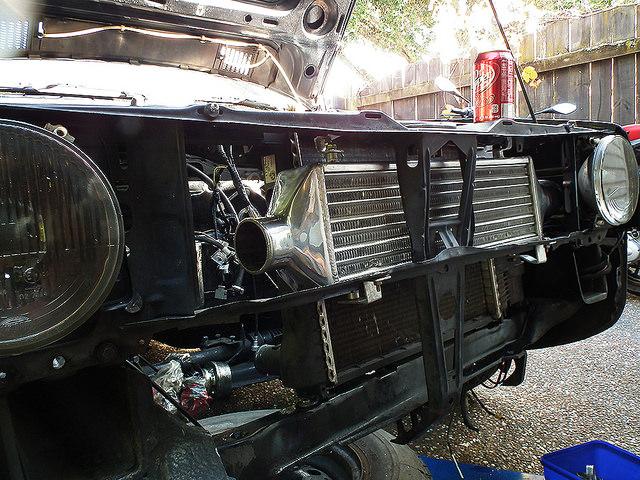

                          • Have made quite a few changes to the mk2 since my last past. Widetrack front now on, as well as a new steering wheel, Mk3 Recaro seats (still no rears, who needs friends?), early 7 slat front grill and some other things here and there. Also have a very big update to come which I will put up once done. Think more than 2x the valves and boost.
                            • Quick preview of what's to come:
