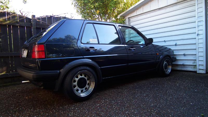

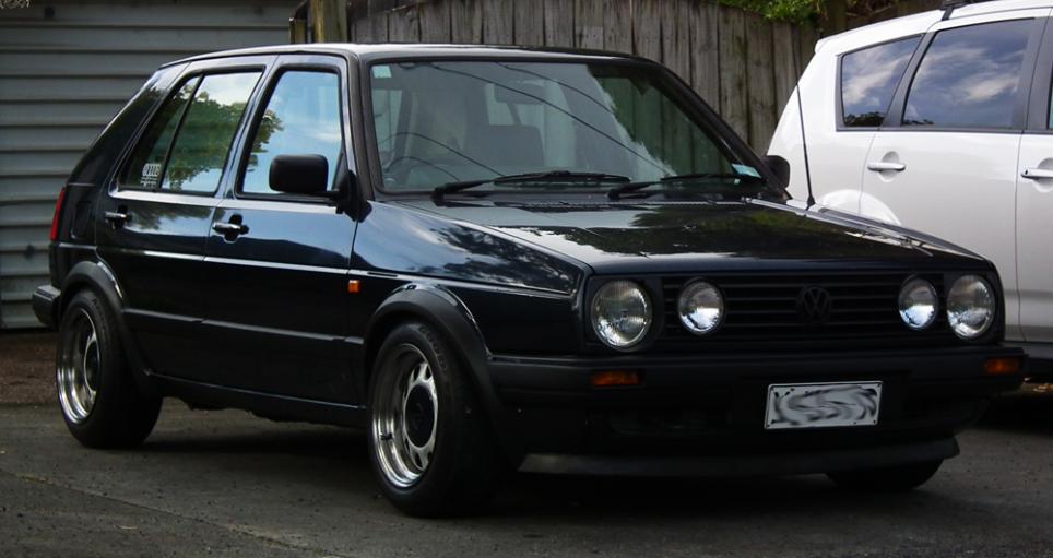

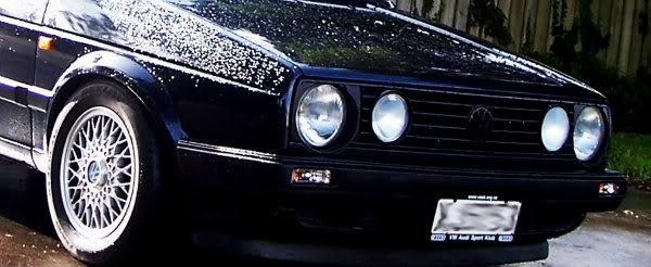

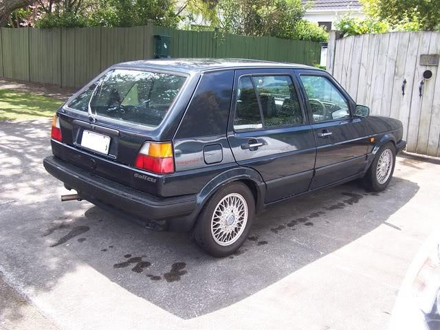

I bought the car just under 2 years ago like this:
A standard 8v Mk2 golf. It was in very good condition, owned by the same family for over 6 years, and had an extensive service history. The interior looked brand new, no wear rips or cracks of any kind anywhere aside from the headliner sagging. All it had done was a 60mm drop.

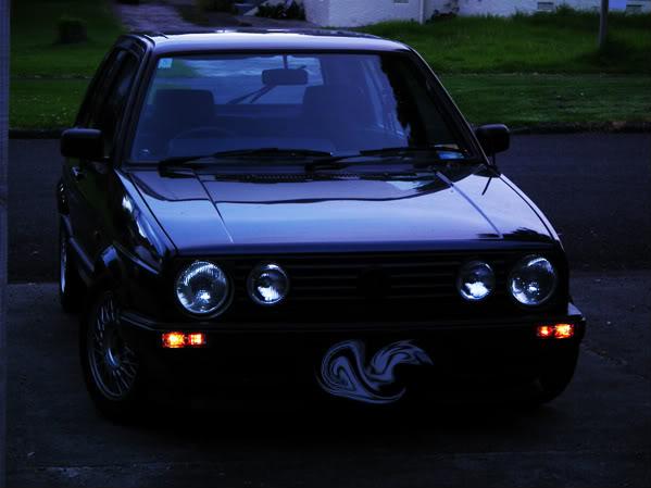

Crystal front idicators:
In the front crystal lights I installed amber city/parking lights, so they light up amber like the US spec cars:

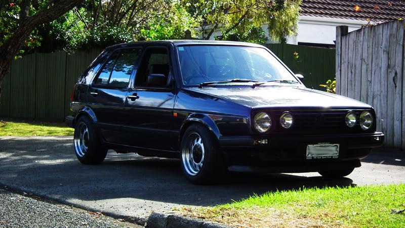

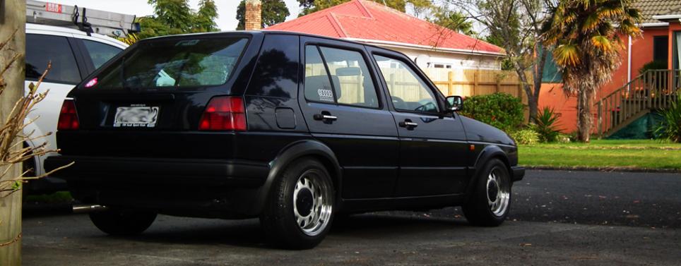

Ever since I got it, I had a vision on mk3 widened steelies with mirror polished lips.

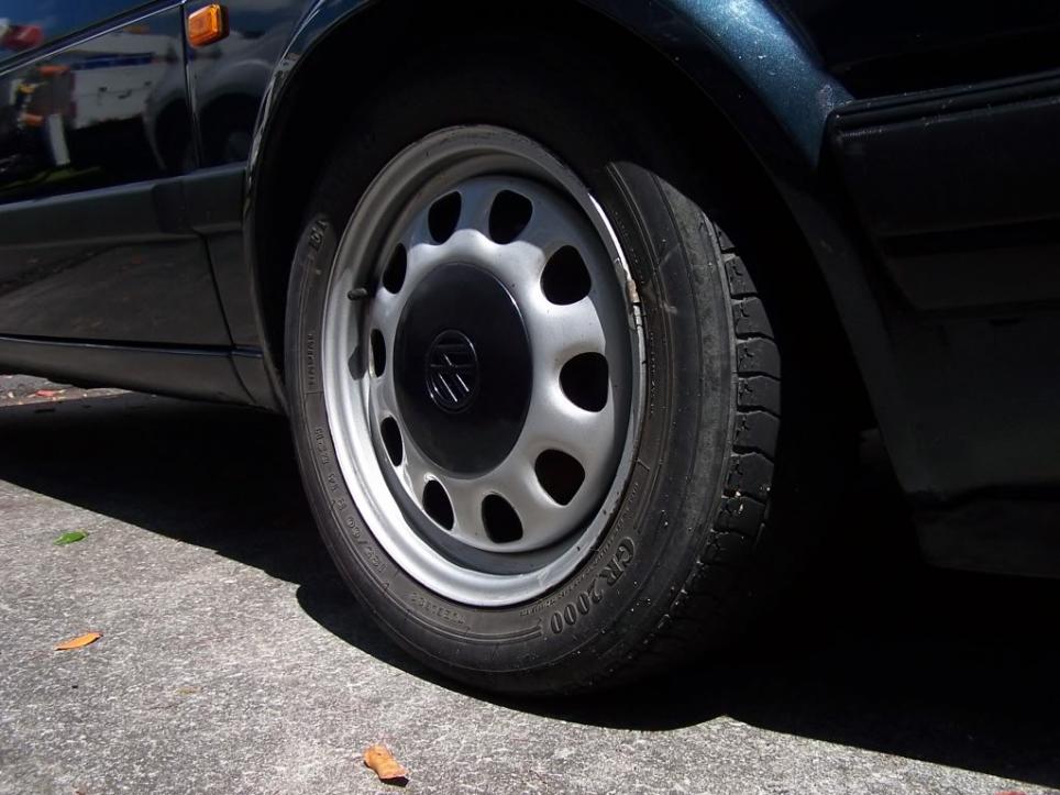

The steelies started out like this:

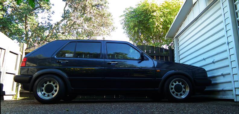

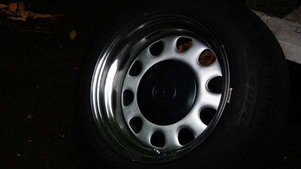

I got them widened and then polished the lips for hours, then painted the centers silver and clear coated the lips. Now they look like this:
Specs are:
Fronts: 8" wide et20
Rears: 8.5" et13
185/60R14 tyres all round.

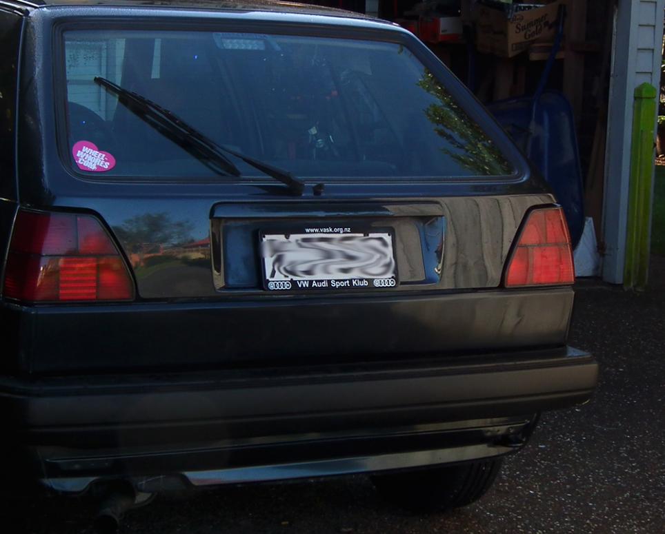

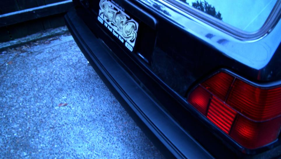

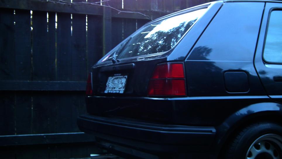

I then took my spare set of tails and tinted them all red. Used Dupli-color metal cast paint, and clear. I believe this is the only set on a mk2 in New Zealand.

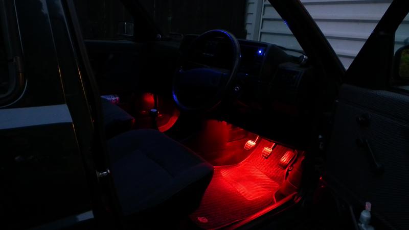

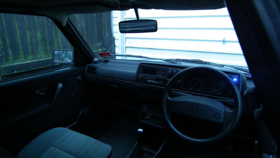

I also installed red footwell lights which turn on with the dome light (only when doors are open, and turn off when closed).
They're not really as bright as in the photo.
