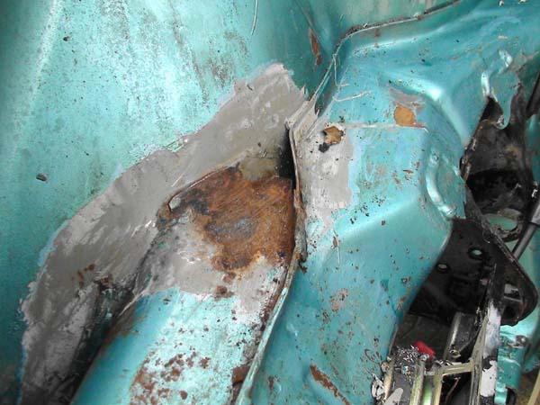

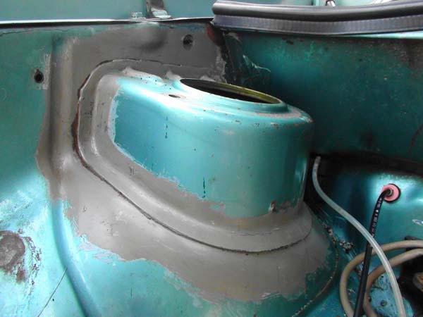

      Ready for welding and other modifications
      Found a bit of rust...

          i hope you mean you're raising the strut toweres
          • #65
            hah, you wish!

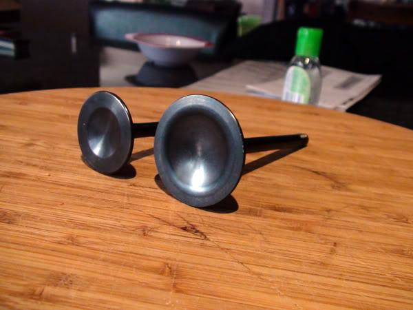

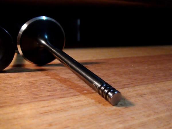

                              whamm!!
                              Mechanical lifters application.
                              42mm inlets
                              35mm exhaust
                              7mm stem
                              Next on the list- Lash caps for under bucket shimming.
                              Hope_you_like!
                              Golf GTI 1980
                              Golf GLS 1979
                              • #75
                                they some big valves! they'll be tickling each other if you're not careful!
