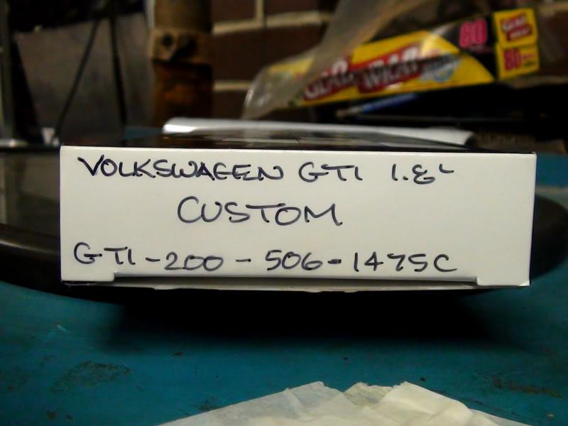

    why does the box say 1.8lt when your building a 1.9?
    dom
      dom
      Because its 1.8 rods just longer (custom) to 1.9. The lenght is increased from std 1.8 rods, if im making sence.

        yeah i know why and how to stroke a motor... was just asking why they would put 1.8lt on longer 1.9 rods
        dom
          Wouldn't know man. Maybe to indicate that there custom or something, instead of people thinking there of the shelf.

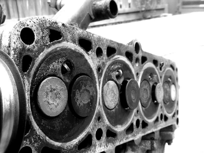

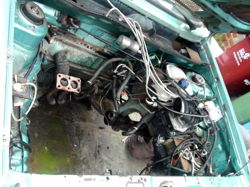

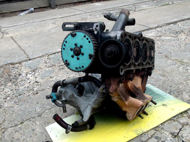

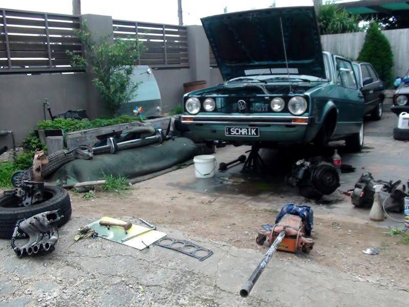

            Engine and gearbox out, we weren't sure if it was a Heron so when we had a look we were quite surprised.

              Nice dude. Glad to see you & your dad doing some upgrades to get this thing going.
              The Part # appears to be a Pauter Rod number! Way overkill on this type of engine, but if your happy to spend the money. Go for it.

                We are using a 1.8 block( bored out and balanced bottom end), with a 1.8 crank and 84.2mm pistons. And yes, they are Pautor rods
