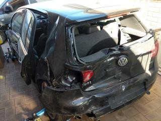

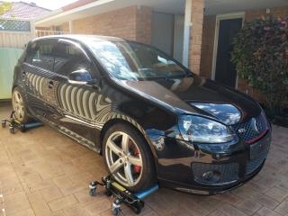

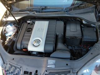

    Following research and a close eye on the salvage auctions there's a wrecked Golf GTI Pirelli on the way from Sydney to Perth to donate its mechanicals to the Caddy.

            Stripping the Golf commences soon and I'm waiting on approval from the Department of Transport for the modifications - sounds like they were working on that yesterday

              Tragic to carve up the Pirelli. Good to see it going into the Caddy though.
                Poor Pirelli is borked. Even the compliance plate is bent out of shape and the wheel well is so crumpled I had to deflate the tyre before levering it out.
