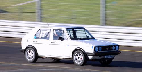

                • #83
                  I took a shot
                  • #84
                    Originally posted by MattSLK View Post
                    I took a shot
                    Were you there in the SLK? I do remeber seeing an SLK in the parking..
                    • #85
                      Yes, late in the day took a few shots from the last couple of groups. There were some quick cars and a mixed bag as well.
                      • #86
                        I took a shot
                        Cool that actually makes me look fast! Got any more?
                        Pete
