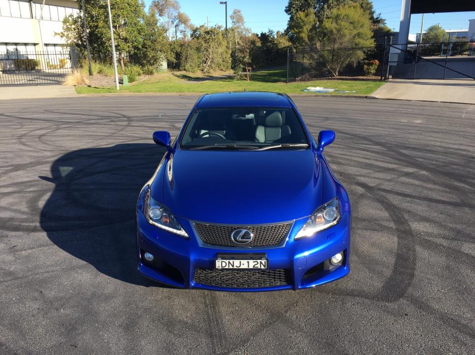

              Below is a pic of my Lexus which i just purchased about a month ago. Paintwork was pretty horrible on this when i got it (full of swirls and lots of scratches etc). After about 15hrs of polishing it now looks like this:

                That looks great .. detailing is not for the faint hearted and that's 15 hours of hard labour. IS F looking good !
                The burnouts aren't bad either

                    Thanks Tuan. Yes lots of time was spent getting the paint looking like that (crappy iphone pics sorry). The car looks fantastic in the sun now.
