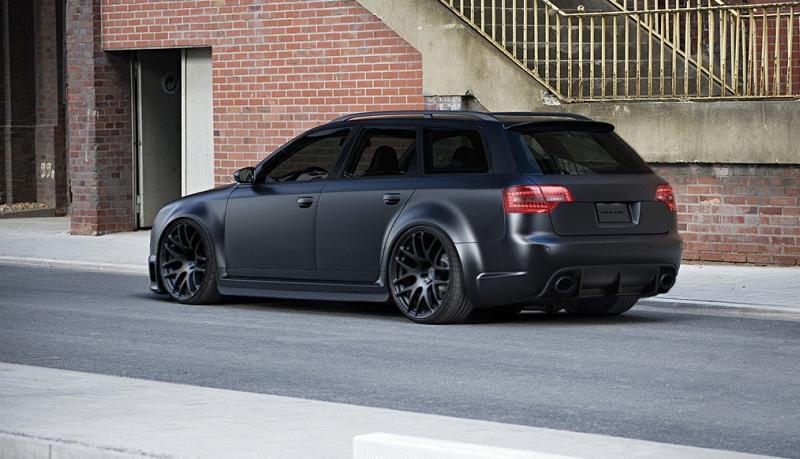

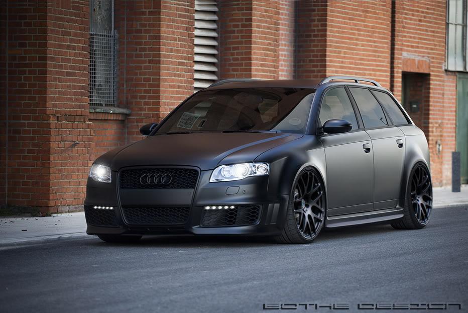

The end result is similar to what you see in the pics above. Simply remove when ready and you'll see how good the paintwork still is PROVIDING you remove bird poop immediately and any tree sap or droppings of any sort immediately. I have seen the crosshatched adhesive pattern burned into paint by failure to remove such things straight away. Enough for now. PM me if you want specific advice but be specific with questions too. Thanks.
