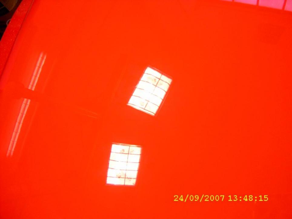

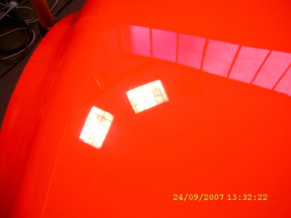

    Polishing is used to fix paint defects. Polishes can be either chemical or abrasive. Chemical polishers include things like Swissvax cleaner fluid, polylack nano clean, zymol HD Cleanse. They chemically clean the surface to remove contaminants and defects. They will not remove swirl marks. For this you need an abrasive polish.
    Abrasive polish there are many brands. The best I have used is Menzerna. But the Meguiar’s professional range is abrasive as is the optimum polishing range. Abrasive polishes need a machine to reach their full potential. Either a random orbital or a rotary. Abrasive polishes have tiny little abrasives suspended in the liquid. This is what does the work the size and type of abrasive varies depending on the polish you use. The abrasives round the edges of the scratches and swirls so they can no longer be seen. In the case of swirls and fine scratches they are removed. In the case of deep scratches they are always reduced and with the use of wet/dry sand paper can be removed. Menzerna Powergloss has large abrasives which remove large defects but leave the surface full of marring and quite dull. Then there is Menzerna intensive polish this is between the two but on most colours needs to be followed with final finish. This depends on the pad used. Menzerna Final Finish leaves the surface free from defects and with a great depth and shine. Here are some pics so you can see the difference
    After powergloss
    After Intensive polish
    After final finish

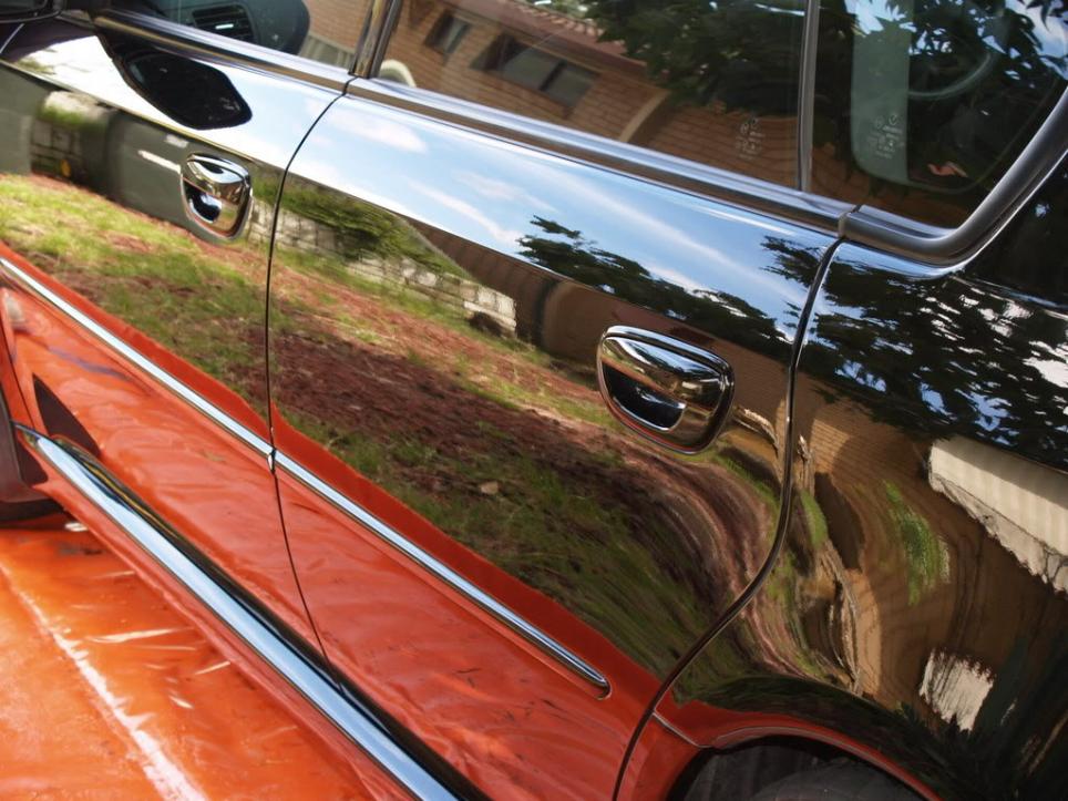

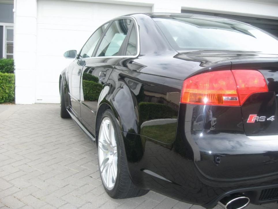

    This car has natural wax (Swissol Scuderia ~$200)
    This one has Zaino Z2 Pro layered 3 times and topped with Z8
