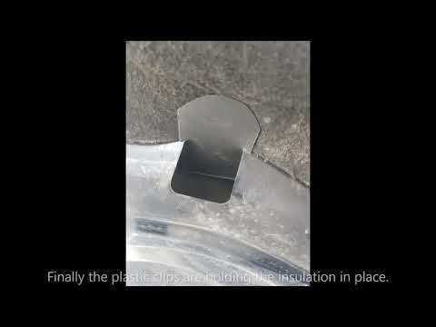

    I tried searching for this issue on here but didn’t find anything. The bonnet lining on my Mk 6 GTI sags because the tabs don’t got into the slots very well anymore and it’s annoying to see this each time I open the bonnet. Somewhere on the net I found some pics of a cool fix so I did something similar myself. It involved cutting some relatively hard plastic (I used an empty engine oil container) into a certain shape to act as clips to hold those tabs. So far so good, even when the engine bay is warm. See pictures for an idea of what I did and the shape/dimensions of the clips. I could have done them a little neater but they do the trick and are relatively unobtrusive.

    Good thinking - it does the job. I ended up removing the one in my Mk6 GTI as it was just so saggy and floppy it was embarrassing. I think once they start getting wet/moist they loose their stiffness and start sagging.
    The one of the firewall ends up doing the same thing after a while - i ended up replacing that one.
      Cheers mate. I thought about removing it but it's not terrible yet. Haven't noticed any issue with the one on the firewall yet, thankfully.

        Here is my video of this FIX, hope will help anyone with the same issues with the car bonnet insulation falling off.
