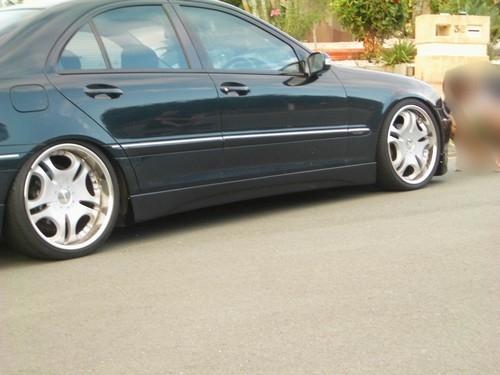

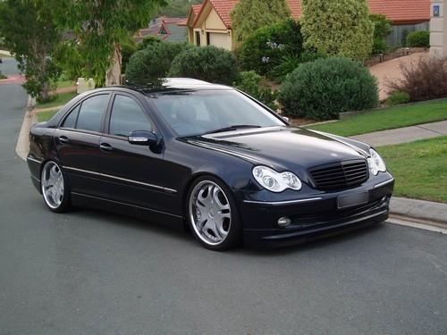

                        Back in the days, I used to put 265/30 profile tyre on 19 x 9 inch wide rim with very aggressive offset (ET25) on the rear for C-class W203 dumped on Carlsson Coil-over.
                        I went through three different brand. First is Yokohama, the sidewall is very square, problems with scrubbing most of the time. Then I went to Falken FK451, same profile, sidewall is quite stretched, zero scrubbing with this tyres. Lastly I went with Toyo, same profile, very rounded looking sidewall, only occasionally scrubs.
                        In case anyone wondering how low I ran, this is some photos of the car, good memories:
                        Those stretched tyres might be your best friend depending on the circumstances .
