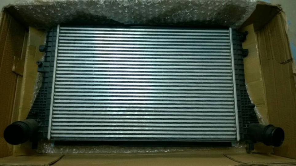

    That's true. Is there anything else worth changing in 1 go as I do the job? I'll be also running the wiring of my OPS kit I've had lying around for almost 2 years as well as fixing my front bumper.

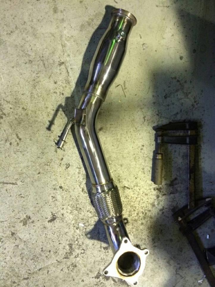

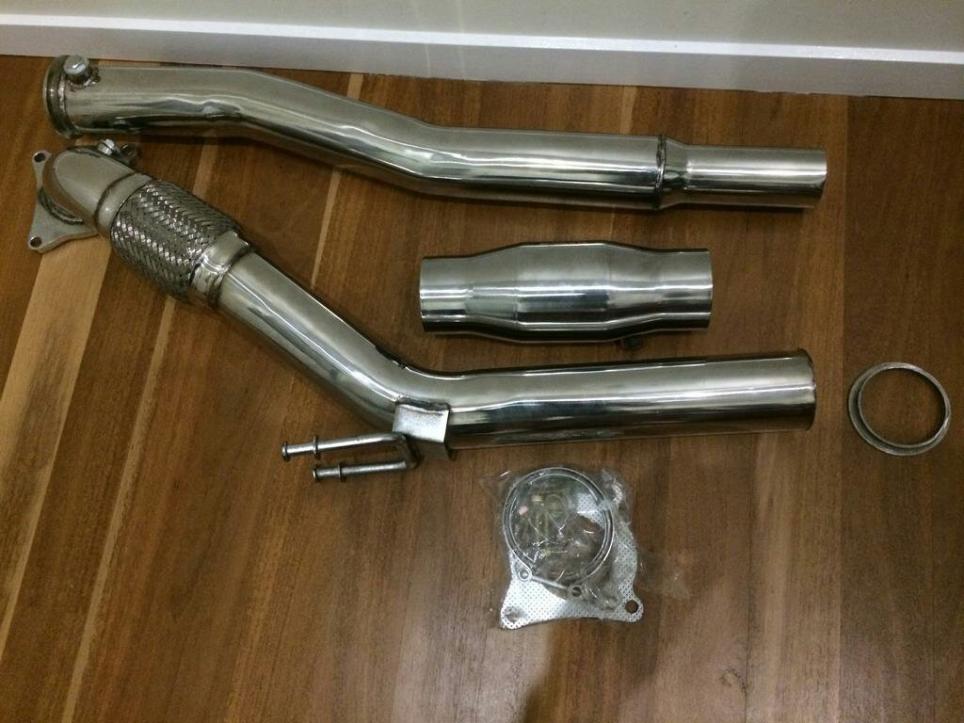

                I might take a long, I was inclined to go to an exhaust shop knowing that there will need to modifications performed on the downpipe to compensate for length...
                The intercooler job I will try on my own...lol
                Being a budget build, this is the budget golf r intercooler and downpipe I picked up for a good price.

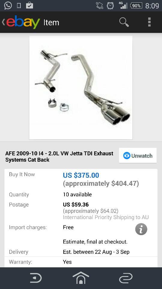

                Do you guys think this jetta cat back exhaust would work on a petrol 1.8tsi?

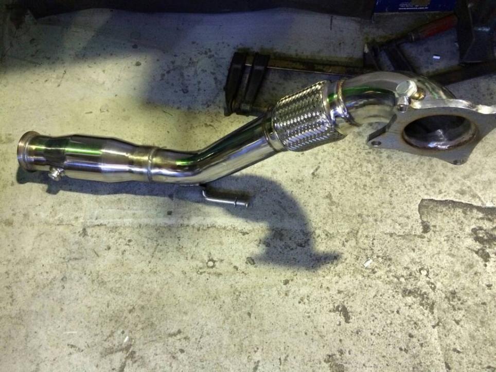

                  If you are capable of doing the IC then the downpipe should be a doddle.
                  edit: hadn't seen the pictures. You'll need an exhaust place because the OEM connection is a butt fit with a sleeve clamp & your DP is an (I call them) oyster clamp joint.
                  Does your downpipe have 2x elongated holes on it as the Golf R has a slightly different stud layout than the TSI
                  Link doesn't work for me (probably my PC).

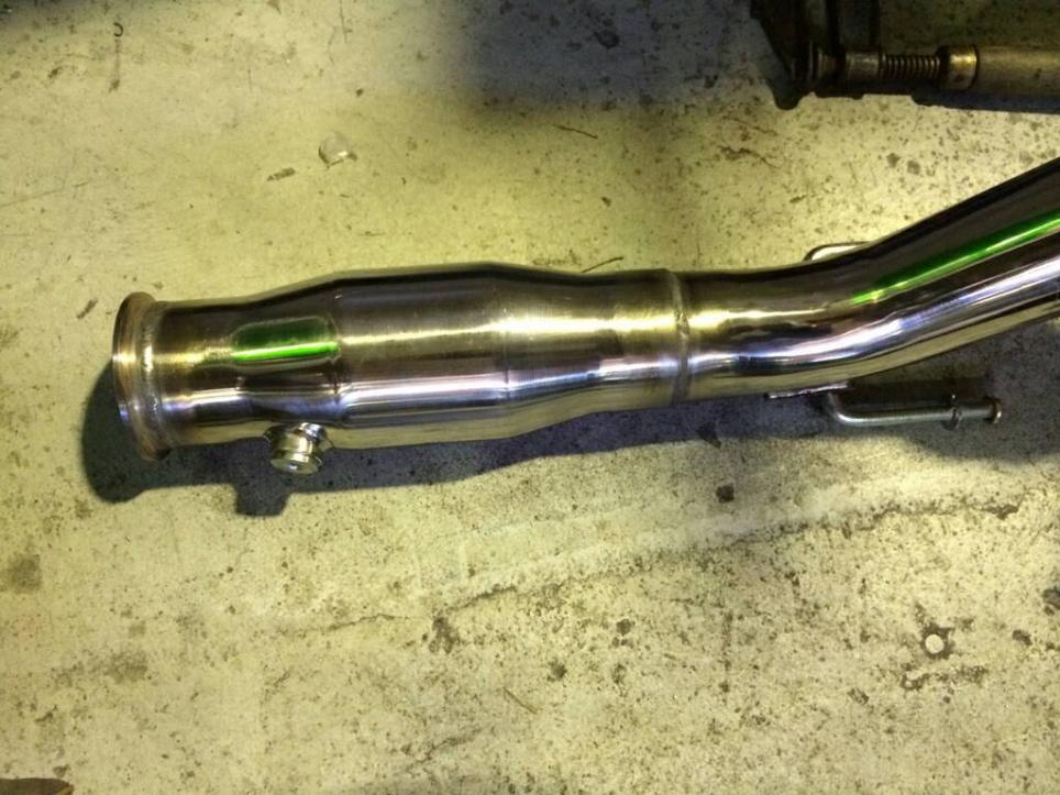

                    Not sure if this will help, but this is what it started out as:
                    Not sure what you mean by the differences sorry, could you clarify with pictures perhaps?
                    And this is the eBay cat back, for a diesel but should work for a petrol being just pipes essentially. Will probably be very loud being a straight pipe I imagine but would be a long the same lines as an ark designs exhaust for the gtis.

                      All the components tell a better story. If you've got the length to the OEM catback right it will be fine. It will take you about 1.5-2hrs to do a test fit at home. It will either be right or wrong. Have a crack
                      This flange fits Golf R & TSI turbos. Note the top holes have been elongated

                        • #87
                          just cut different & different camera angles I would think.
                          The two flanges are interchangeable as long as the holes are elongated. If your holes need elongating you can do it with a round file & some effort. I have heard of people drilling them but I think that would be more trouble than the effort was worth as you'd be trying to drill half a hole & the drill would run off centre. You could drill some small holes just to remove some material before filing but again, probably just easier to hook-in & do it

                              • #90
                                IMO, new flange is the only way. use the factory gasket as a template and have a new flange laser cut - like I did - then have the new flange welded on in the SAME position as the one you have cut off. simples.
                                there is too much heat and expansion/contraction to elongate a hole and leave insufficient material to support something so important.
