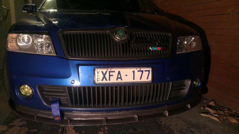

            • #36
              oh. well, hi there!
