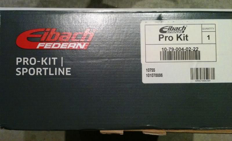

yup, they were certainly a skoda optional accessory, on stock shocks.Originally posted by MrGadget View PostI have read that these springs are offered in the UK from the Skoda dealer as an option. Does anyone know if the shocks are also changed or do they keep the stock shocks?
they r however no longer offered.
this was the link, which no longer works - http://www.accessories.skoda.co.uk/p...o=ZGB1Z3071677
and this was the skoda part number: ZGB1Z3071676

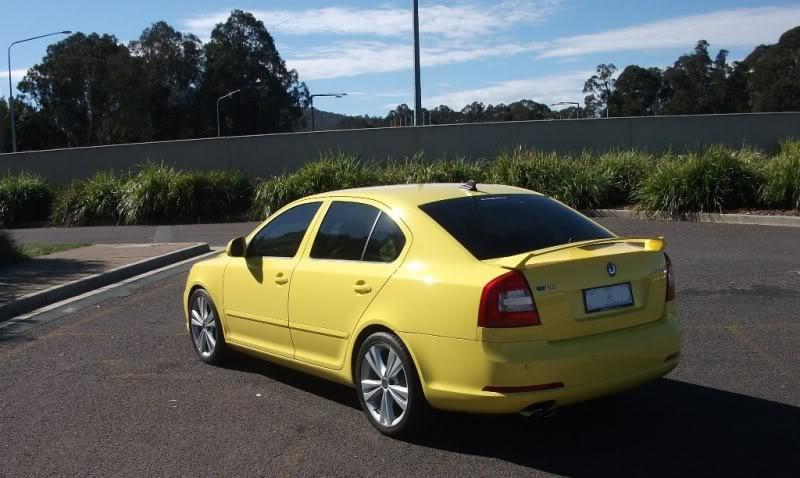

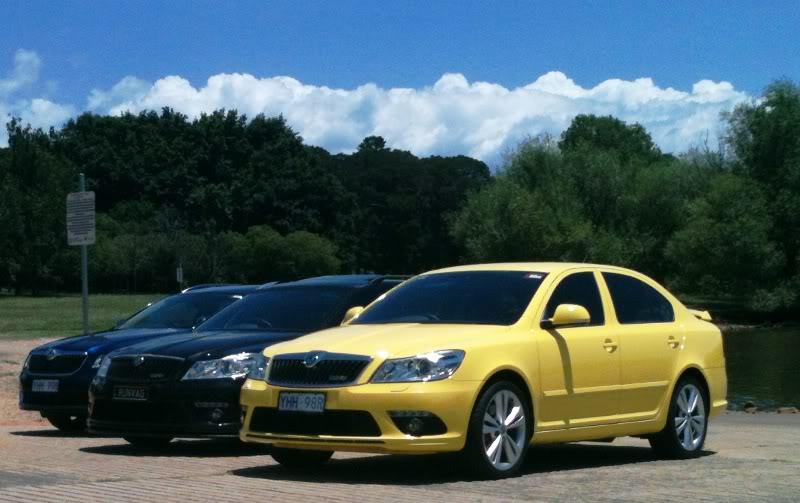

here's mine on the 20mm eibach prokit......

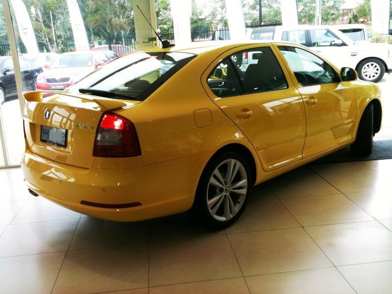

before..............
Last edited by dArK5HaD0w; 26-06-2013, 08:26 PM.MY17 Superb 162TSI, Business Grey, Tech+Comfort Pack, APR ECU+TCU Stg 1, SLA, Rieger Splitter + Side Skirts, Eibach Pro-Kit Springs, Hardrace Swaybar, TPMS

If you put both kits in the shopping cart the partnos are the same. E108502
Katalog linkcarandimage The place where Off-Topic is On-Topic
there are different part number for wagon/estate and hatch/sedan.Originally posted by donweather View PostCould someone kindly provide a link to the correct Eibach 20mm Springs on the Eibach shop webpage as I note they don't provide recommended springs for Skoda vehicles on their shop webpage?
Are they the same as the Golf GTI ones?
Pro Kit Buy suspension from Eibach including adjustable suspension and automotive coil springs.
Also, what difference does the gearbox (manual or DSG) make to the springs? ie, why does the Eibach page have a different link to springs for manual or DSGs?
Thanks.
this is from dcperformance. part number will be the same elsewhere.
wagon version:- E10-79-004-04-22
liftback version:- E10-79-004-02-22

Also, it says that the springs only lower the car by 20mm, but I have to say that on your car DS, it looks to be more of a 20mm lowering? Do you agree?Last edited by donweather; 27-06-2013, 04:50 PM.

Ur half right.Originally posted by donweather View PostAlso, it says that springs only lower the car by 20mm, but I have to say that on your car DS, it looks to be more of a 20mm lowering? Do you agree?
I measured (top of wheel arch to floor) it, before & after - my fronts dropped 30mm, while the rear dropped the expected 20mm.
Don't know why. DSG? Equipment level?
As a result, it required my xenon levelling to be recalibrated.MY17 Superb 162TSI, Business Grey, Tech+Comfort Pack, APR ECU+TCU Stg 1, SLA, Rieger Splitter + Side Skirts, Eibach Pro-Kit Springs, Hardrace Swaybar, TPMS
