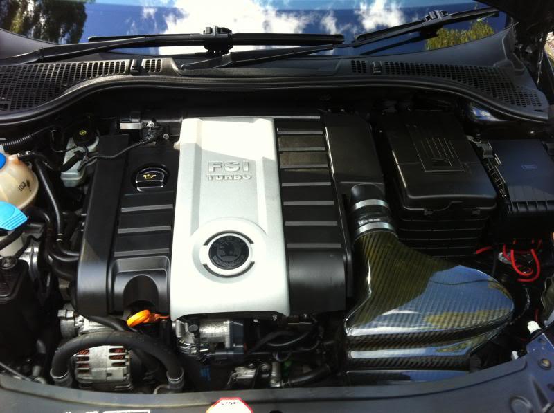

the bargain hunting continues, I picked up a apr carbino intake for $50 plus $15 for shipping. Just the box and silicone, n clamps. but as I already had a k n n its essentially the same anyway. performance increases are marginal, bit more reponsive, little more torgue, revs out a little better, biggest improvement was to get the factory eye sore out of there, never seen such a poor, flimsy design in my life! Swapped out the std blue silicone hose for black from my mates at motorsport connections- hit em up, tell em benny sent you, they will only charge you 5% more

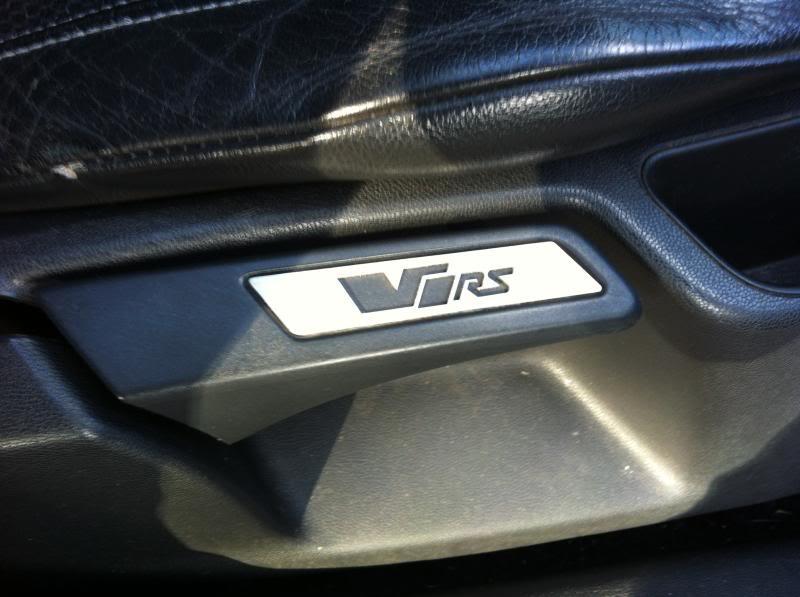

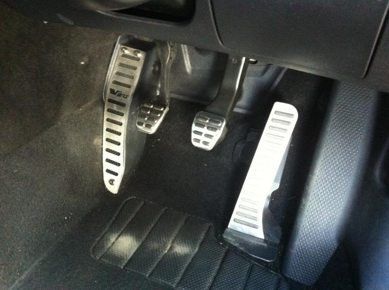

found some stainless steel interior bits on ebay for a reasonable price, a deadpedal and inserts for the seat height adjuster, really good quality for the $$ I think it was about $40 shipped for the lot
seat bolster needs a bit of work I no!

nice additions! but the question is - does the carbonio intake make everything sound a lot better?
2012 Yeti 77TSI, Candy White
ydad.com.au: musings of a dad growing up - the blog.
cbay.com.au: photography, video, design - creations.
do NOT attack it with a hole saw. youll just draw in hot air from the engine.
you need the stage 2 intake pipe, then youll near some noise
not a huge amount, but better than stock. Im REALLY surprised how quiet these engines are, compared to my old nissans
My diesel just ROARS with the Carbonio intake...
Don't know why the petrol doesn't!!

What seller did you get that footrest one from? I can find 2-3 of them on eBay but they're $30 plus $10 shipping!Originally posted by cyclesoul View Postwww.TheRapidWrench.Melbourne
The convenient, professional and affordable mobile bicycle mechanic that comes to you!
My RS build thread
Yeah thats the one I found, still double the price of what you got it for if I but on its ownOriginally posted by cyclesoul View PostCreation Motorsport-com is the one

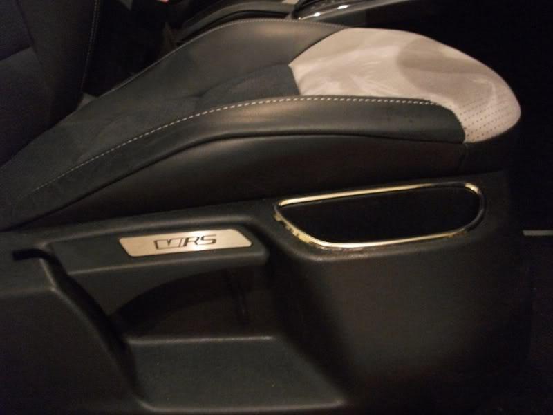

I already had the seat handle badges. Looks like a pretty nice piece to cover with your foot though!
My RS build thread
I ended up getting that footrest... worth it!www.TheRapidWrench.Melbourne

"Stage 2" intake pipe doesn't apply to the FSI engines - its only for the newer TSI engines which have a completely different intake setup. Also the stage 2 intake pipe on the TSI's does jack diddly squat and has a dreadful connection for a PCV line which leaks.Originally posted by zei20t View Postdo NOT attack it with a hole saw. youll just draw in hot air from the engine.
The Carbonio on the FSI engine does not increase noise but it is a better design than the stock inlet area near the grill. The main restriction for both noise and airflow on the FSI engines is that damn engine cover.
If you get a complete replacement intake (that involves removing the engine cover) then you will get alot more spool and sucking noises as well as some more power.
