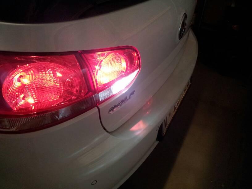

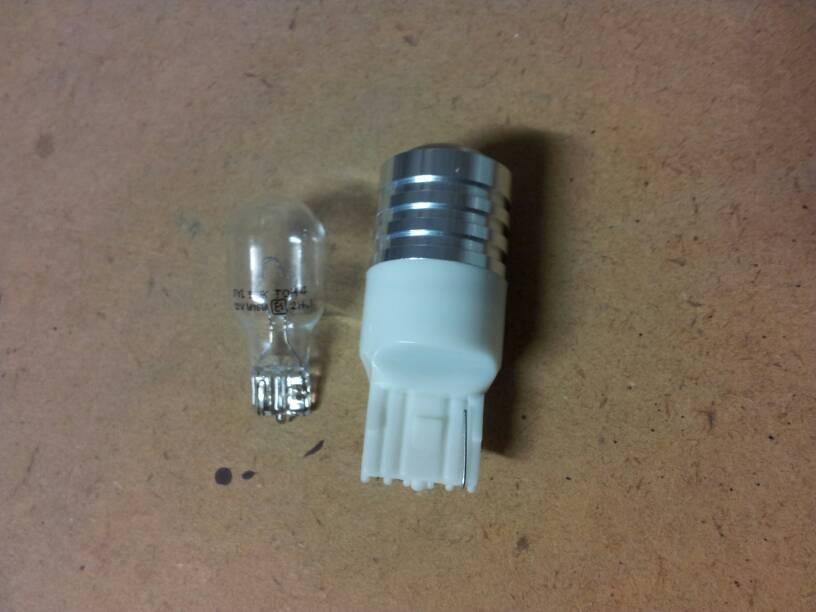

              Reversing LED (CREE)
              This is the T20 reversing LED CREE bulb for Golf 118's... I found out today it is different to the T15 reversing bulb used in the R tails (glass bulb on the left).
              And it looks like this when working...

                GregoInc - our Octavia's use a P21 bulb rather than those litte T15/T20 fellas
