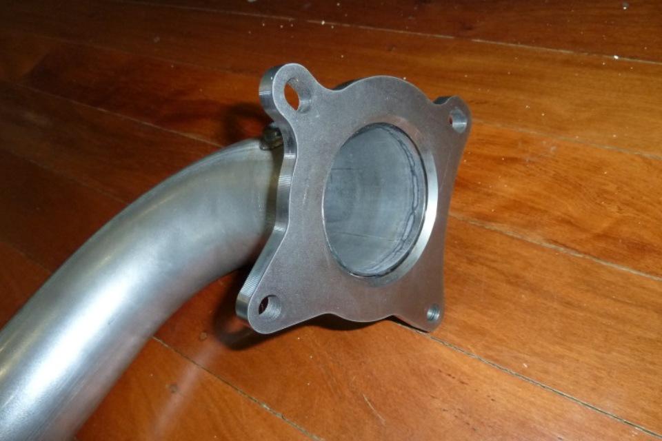

    The bolt spacings on the turbos are different although most manufacturers counter this by slotting the holes.
    The Octavia DP is also a different length to the GTI, S3, Golf R DP so not all DPs will be compatible. Some DPs are designed to be trimmed by the installer before adding the reducer which gives them compatibility across the board.

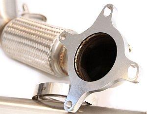

      As Tim mentioned, the down pipe manufacturers make 2 of the holes on the down pipe flange an oval shape which covers all bases regarding TSI / TFSI and K03 / K04etc.
      Below is a pic of a 42DD down pipe and you can see the oval holes.
      Again, as Tim mentioned, the Octy down pipe is slightly longer (i think from memory - might be shorter...) than a normal GTI one, so you will likely need to slightly modify the down pipe to mate up to your stock cat back.

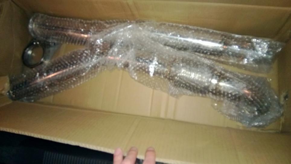

                    OK so I had bid on an ebay one before I posted this thread. turns out I won it. $260 delivered from Germany. 3" SS, no cat and suits MK5 and MK6 engines.
                    ill see how it goes. thanks for the replies everyone!

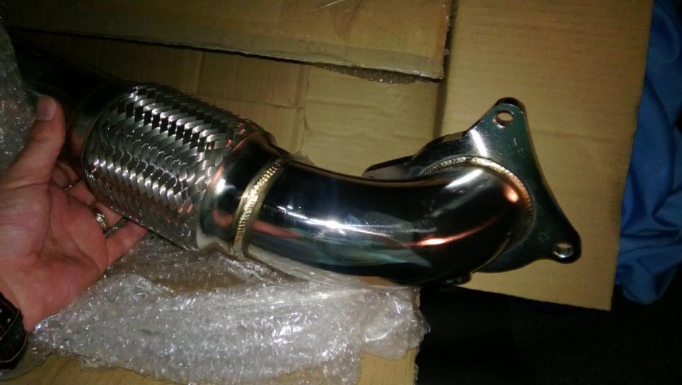

                          OK, picked this up from the post office this morning, great quality. yes has the TFSI flange on it which ill have 2 holes elongated to fit the TSI.
