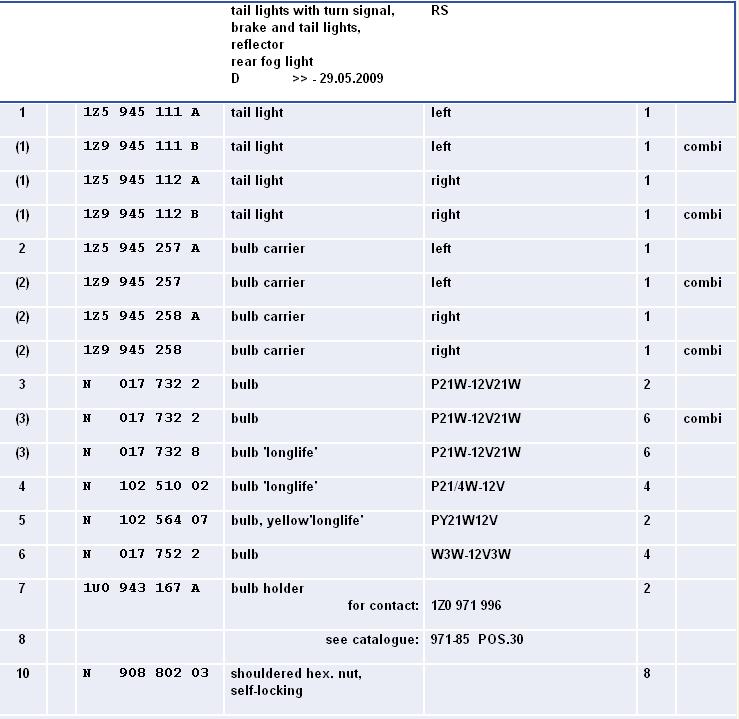

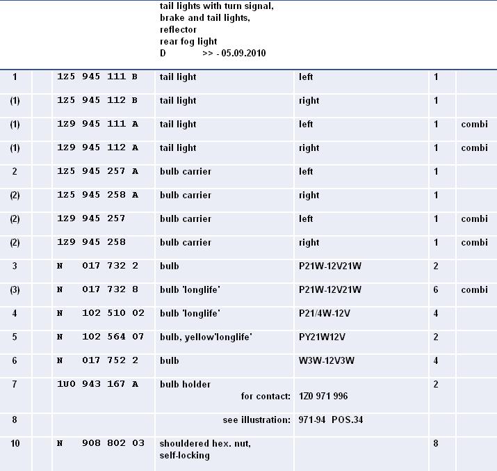

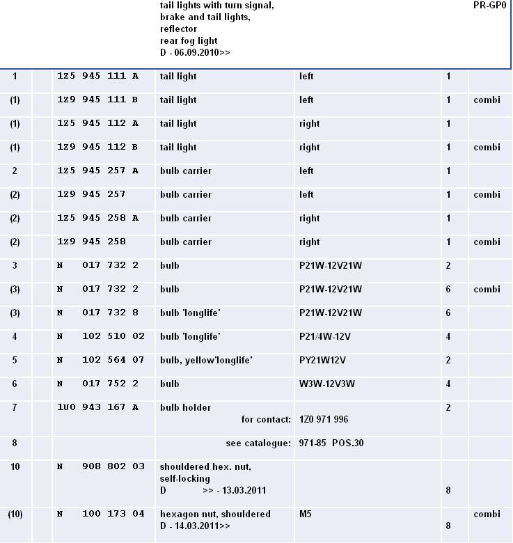

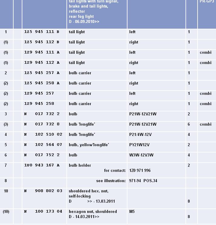

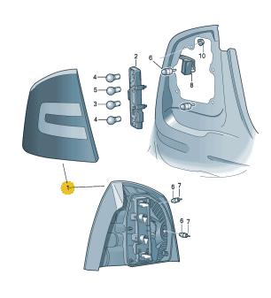

    Do you a deal if you have access to ETKA: can you get me the part numbers for rear light assemblies for Octavia 1Z FL Kombi vs Liftback. Are they different numbers?

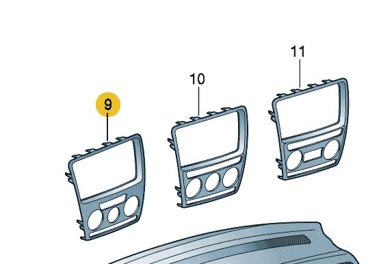

      There are at least three different units shown:
      And even then there are a butt load of part numbers, the ones JUST for item 9 are:

      The list for items 10 and 11 are even longer Now there are model details listed against each one, so I think if I had the manual I might just be able to work something out, although even then I'm not 100% convinced. I get the fact there is different colours and even a change at a particular year model/variant, but this just looks crazy complex for no good reason.
      It looks like all the "11" parts are for "Trim for switch for vehicles with navigation system, air-conditioning system with electronic regulation".
      And all the "10" series parts are for "trim for switch with manually regulated air conditioning"
      Series "9" is everything else??
      In my case I *think* it's a "9" series part, just need to nail down exactly which one is right.

          Confirms that they are indeed diffferent part numbers. Clears something up for me.
