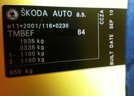

              after doing a bit more research, it turns out the TPI only applies to "CBFA, CCTA" engines.
              despite the skoda rs and golf gti having the same EA888 petrol engine, they have different variants.
              the skoda rs has the "CCZA" variant. well atleast mine does.
              its shown on the build plate, or in the boot with the option code sticker.
              i'm not sure which one the the gti has - either the "CCTA" or "CBFA".
              that would explain why vw didn't come to the table to have my issue addressed.

                  CCZB mate for my manual MY10 GTI

                  • #24
                    hmmm...that's interesting and confirms my previous thoughts - "there is no difference (mechanically) between the mk6 gti and the facelift octavia rs".
                    its only software (ecu) that is different.
                    ROW (rest of the world) MK6 and A3 2.0 TSI Engines
                    CCZA - A3
                    CCZB - MK6
                    CCZ denotes the european mechanical structure.
                    A and B denote a software calibration change for different power levels.
                    A has 200hp, B has 210hp.
                    TSI Trans CCZA ROW 2.0 TSI 147kW (200 PS), 280Nm
                    TSI Trans CCZB ROW 2.0 TSI 154kW (210 PS), 280Nm
                    funny how a software callibration can deny eligibility for a TPI fix.
                    MY17 Superb 162TSI, Business Grey, Tech+Comfort Pack, APR ECU+TCU Stg 1, SLA, Rieger Splitter + Side Skirts, Eibach Pro-Kit Springs, Hardrace Swaybar, TPMS
