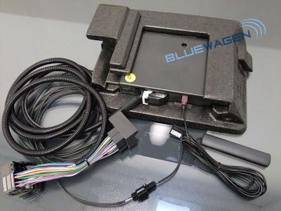

          DIY by me and dead easy! cost me $400 from Poland ebay.
          Long story short, family is polish and my uncle went and checked it out before i bought.
          Genuine VW 9W7 kit with full factory integration.
          Heath

              Well, I don't know. I'm struggling to fit the Columbus radio back in, because the wiring that is supplied with 9WZ BT kit is too bulky and there is not enough room in the dash behind the unit and connector is in the way. I'm interested to hear from anyone who had used supplied click in wiring and had no problems with it.

                  1. All sorted out, BT fitted and working well. To everyone who plans DIY installation, depending what wiring you get with the BT kit, the installation can take a bit longer than you expect.
                  I took a few pictures and can make "how to" if someone is interested.

                      I know with the dension kit I had to pull the left side panel and glovebox to get the harness to go in nicely. The actual bt kit is sitting in the area behind the climate control.
