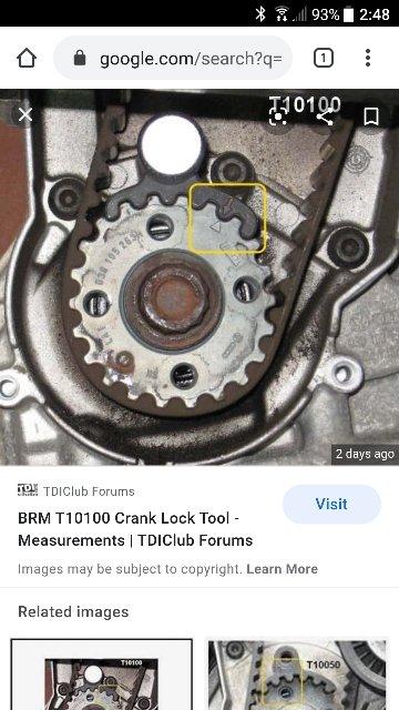

    He said that T10100 was for 2004 onwards built for 2.0 litre engines. I follow his channel a while now. Seems to be the one with chrome screw and arrow on right-hand. Hope helps.
    Sent from my HTC 2PZF1 using Tapatalk
    MY15 TIGUAN 130TDI R-LINE - Pepper Grey, Panoramic Sunroof
      This one?
        Great, thanks for your help.
