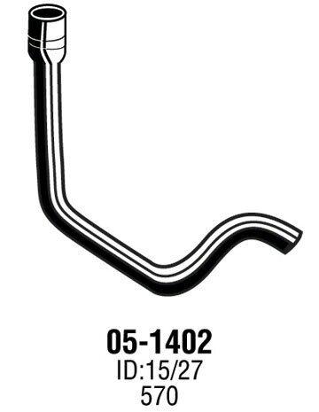

        • #19
          Okay some pics this is the hose I modified. .. basically cut it to length.

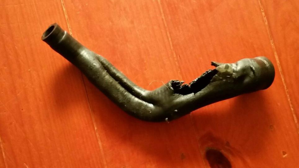

          • #20
            This is old hose.... and the finish job sorry bout the picture quality

            • #21
              Sent from my SM-G900I using Tapatalk
              Yeah, that's seen better days hasn't it. LOL
