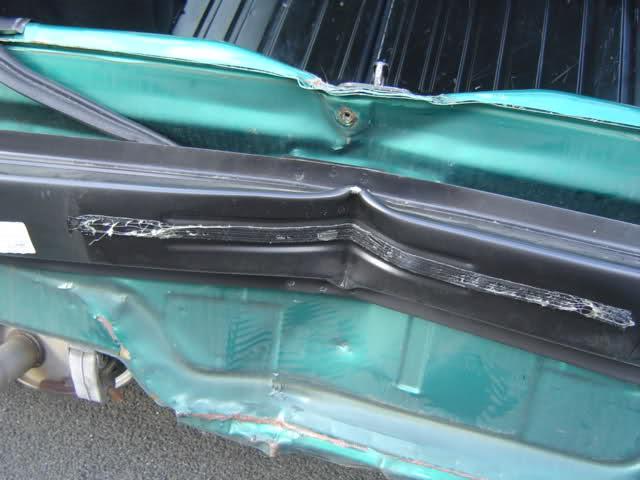

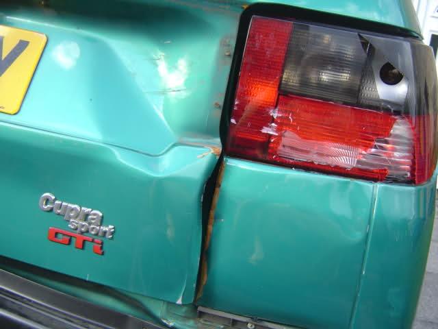

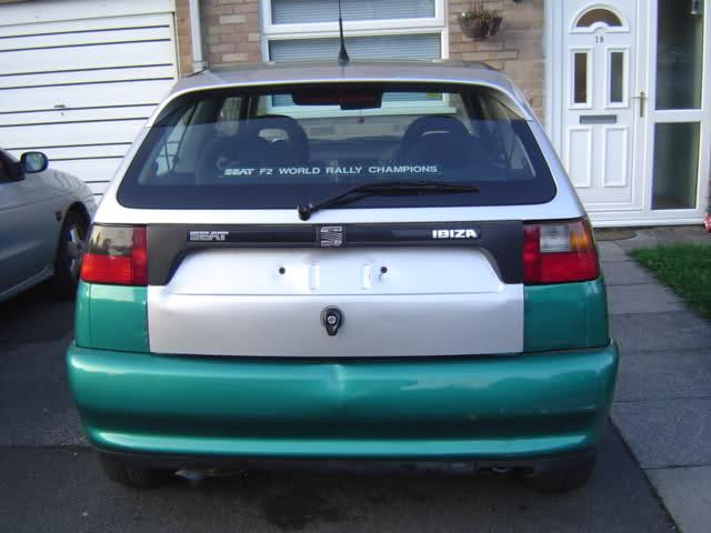

    Written off as Category 'C' after a shunt in the rear whilst sat at traffic lights.
    Purchased for a steal back in autumn/winter '06... sat looking very sorry for itself for a while due to having been kept in 'offroad' status by me ( to enable me to get a few bits, get it through the VIC check etc)**stricter version of the MOT /roadworthiness test**
    First major purchases wre the replacement tailgate (wrong colour, but a lot straighter than the original one ), slam panel etc and some replacement rear clusters due to the originals being smashed in the crash

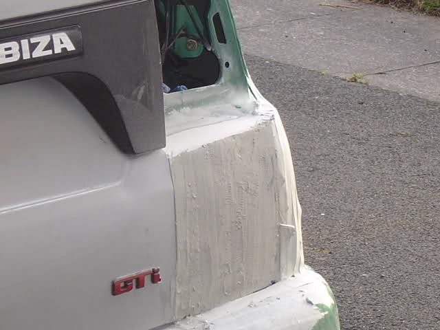

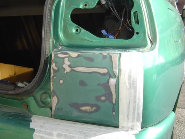

    Sat in this guise for a fair while whilst it was VIC'd then once done and MOT'd (failed only on front suspension mounts, suprisingly considering the smack in the back it had) it then had a bit of filler -work done to plump its ass back properly
    Once done, the red strip was sourced, and fitted over the summer also sourced a replacement rear bumper ( in red ) and as it was summer,took in a few trips to various shows/meets etc.
    finally , off it went to the Sprayers to have the rear end blown over, so ended up looking half decent by the end of summer..

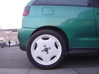

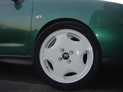

    Treated it to a set of White Powder-coated Estorils way back last year ,and finally today i got some rubber wrapped on them.
    (have took these snaps just before sun down this evening with rims placed in front of existing ones)
    Will soon be lowered , have the rims changed over (scruffy **winter** rims on at present, due to the oh, so lovely rocksalt etc thats used on the cold snaps over here) and have a few more little touches done before (hopefully ) a trip to SantaPod in April (mot and tax up before then , and im away in NZ for just over three weeks prior to the early Spring show at Santa Pod too, so time is an enemy at moment.

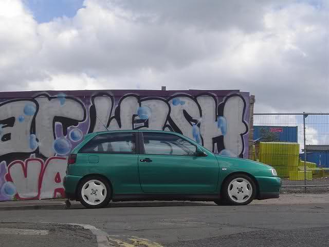

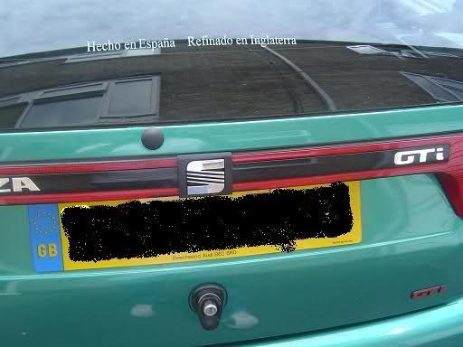

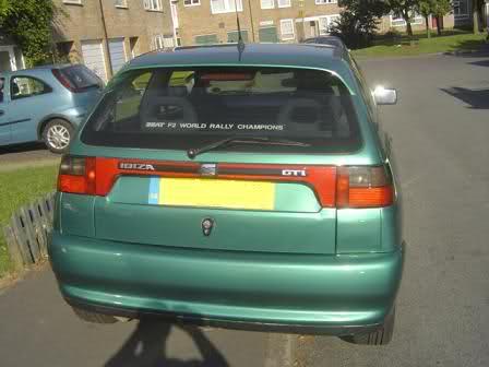

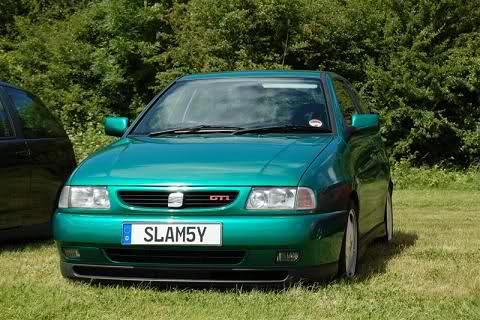

                          Bit of an update..
                          now been lowered by 60mm at front 40mm rear, and also fitted with 20mm spacers to rear to get the wheels filling out the arches better.
                          dewipered the rearscreen
                          few more tricks/touches I'll be doing over the summer(??!?!) months and think that will possibly be that , but y'no how the modding bug bites..
                          anyway.. heres a couple of pics
                          The goodies..
                          Dewipered Rearscreen..
                          The Look..

                            Love the green......& I think i'll have to get hold of some spacers!
                            Red 99 Seat Ibiza Cupra Sport, coilovers, K&N (Gone but not forgotten)
                            2012 BMW X3 MSport 2.0D
                              The spacers deffo make a difference, It sits better, feels better (wider footprint so to say) and most certainly LOOKS better ! (Seat really cocked up by putting the narrower rear hub on )
