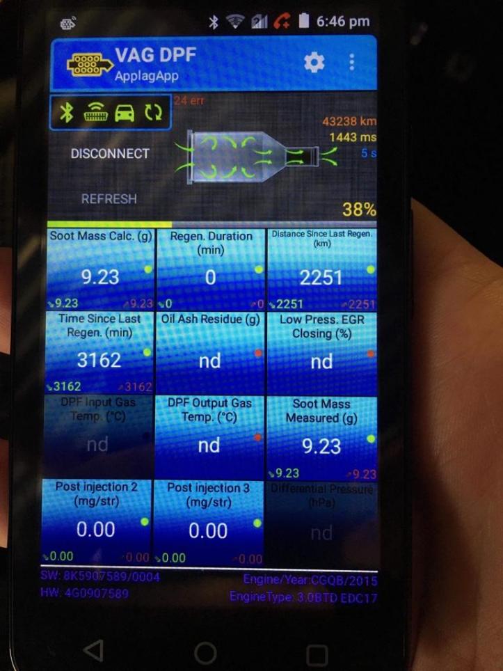

                I was worried about the lack of regen because my car religiously does a regen every 500-600km's, and the screenshot below shows it had not done a regen for 2,251km yet it was only registering that the DPF was 38% full.

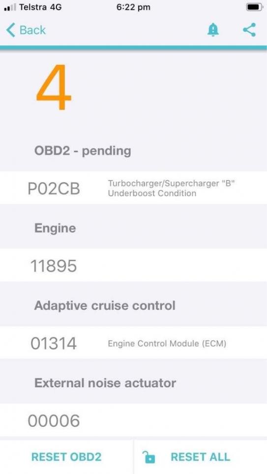

                Then the errors started happening - turbo underboost error, ECM error etc.

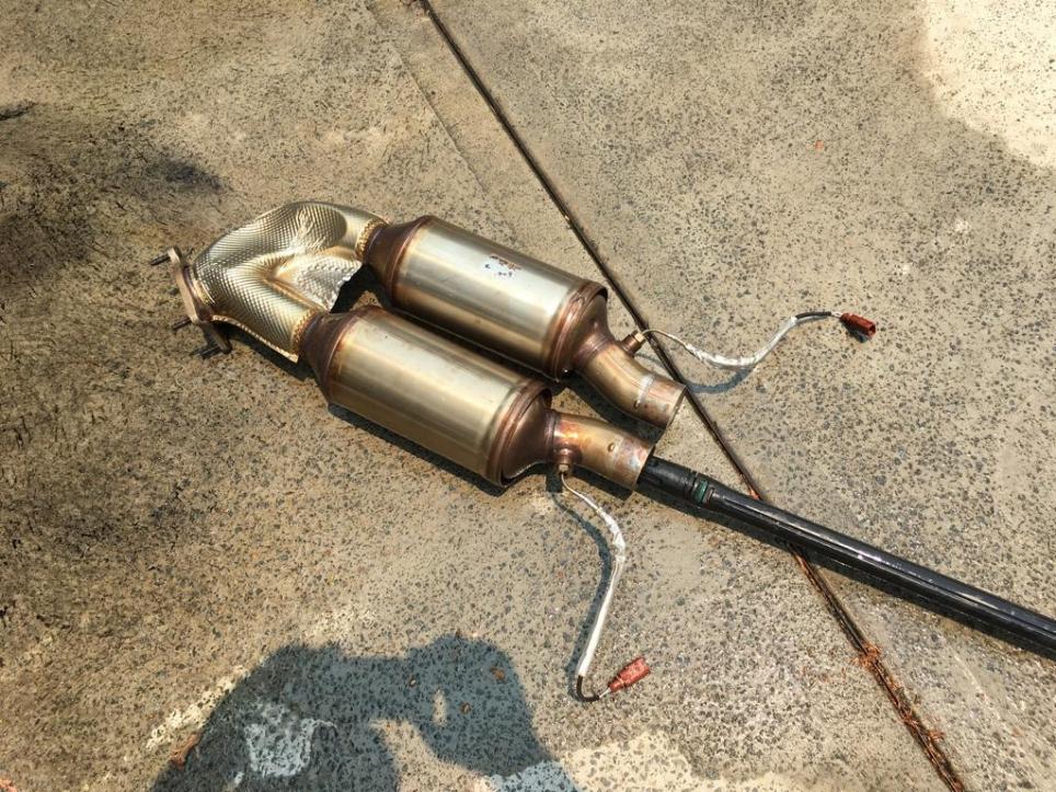

                After doing some research and investigation, I decided to try and flush out the DPF with some chemical cleaners and high pressure water and see if I could fix the issue myself. Thankfully the twin DPF setup on the SQ5 is super easy to access and remove, only taking probably 10-15mins to remove.

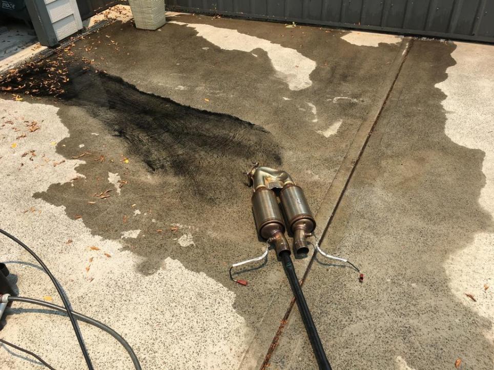

                The DPF was well and truly blocked visually. I sprayed it with some carby cleaner and some degreaser, let it soak for a while and then blasted it for a good 10-15 mins with the Gerni. Heaps and heaps of black muck came out, but it was clean as a whistle afterwards. It was hot as hell that day, so I let the DPF's sit out in the sun for a few hours to try and evaporate as much of the water that was in the filters before refitting it to the car.
                Good news, after refitting the DPF's my VAGDPF app reported that the filter was clean, but the car was still in limp mode...so I had to perform the procedure shown in the link below to reset the DPF parameters. More good news, the car was now out of limp mode and back to have 230kw/650nm like it should.
