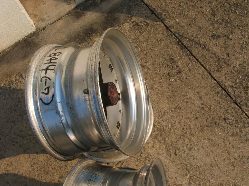

14x8 4x100 14" RCA
Quick search on eBay - http://cgi.ebay.com.au/HOLDEN-GEMINI...item3efd724af8
They look awesome! With centre-caps too!
I dont even have a mk 1 anymore (
) and I still want them! cool as.
couple things. you'll need different wheel bolts (or studs) centrebore spacers and you *may* have trouble clearing the front brakes on a mk 1.
then tyre size, if they're actually 8" wide, i dont know what the hell tyre you'd run! (to try and keep it low profile still)
From the info he's given, I figured it out to be about ET19. which is pretty good for an 8" on a mk 1! hopefully his measurements were accurate!
Originally posted by dom123 View Post'the off set from the back of the mounting face to the outer edge of the in side of the rim is 133mm 5 1/4" ' how would this suit a mk1 guys?
thats backspacing, take a wheel off your mk1, put a straight edge on the brakes where the wheel would normally sit, then count 133mm or 5 1/4"towards your suspension
ohh and i also seriously doubt they are 8" wide.... the barrels arnet wide enough
most people measure the size from far end to end, when infact its correctly measured from inner tyre bead's
THIS!! is a 14x8
domLast edited by WABIT; 04-03-2010, 09:37 AM.
so they would sit pretty well within the guards???why would you need centrebore spacers and different studs, im noob with wheelsOriginally posted by Jarred View PostI dont even have a mk 1 anymore (
76 Scirocco
Yea I reckon they're probably a 7" wheel too. don't look nearly wide enough for 8's!
would make the et32. which means you could fit spacers ont he front to clear brakes (if need be) and not poke a truck load!
More desirable as 7's imo
gemini wheels have studs and nuts, just cause they're different. Cb is also like70mm, ours is 57, hence the spacer
oh and 8's pretty much never fit within the gaurds or a mk 1!
cool retro as wheels
cheap too!!!
